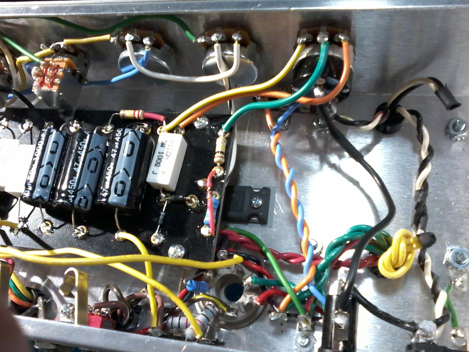

I put together a Tramp head. When I switched it on to test voltage with no tubes the LED lit up for a couple seconds then died. Fuse blown. I took voltage readings of the caps after this and they all report zero.
One oddity is that I broke the 6l6/6v6 toggle by over tightening the bolt - the whole thing just fell apart. I wired it direct to 6v6, or so I think. Other than that everything is by the book.
Does anyone have any clues on where to start to debug this?

More pics at different angles on the power xfmr end, Difficult to see where your wires begin and end. Also, I have read of fuse holder being shorted w/ excessive heat on terminals. Might want to UNPLUG and do continuity checks. Note also that that selector switch seems to be wired in an different manner than I've seen before, usually terminals 1,2, and 3. That's all I can suggest for now.
PostPosted: Tue Sep 24, 2019 6:08 pm
Had a thought on narrowing it down. Disconnect and insulate red leads from board and insulate them. Install new fuse and power up, if fuse blows, then it's definitely the power wiring and concentrate there. Need to get properly rated spare fuses, too, just in case ;) Added some pics, may help, may not :hmmm:

The output ohm selector is wired to the diagram - it's just in there upside down. yellow to 1 , green to 2, orange to 3 and A to output jack tip.
I'll check the fuse holder first thing, once I pick up some fuses. One thing - on the amp it says 120v 2a / 240v 1a. Does this mean my 120 volt should have a 2 amp fuse? It came with a 1 amp 250 volt fuse.
I've been thinking about it and I'm guessing it's a mechanical short under the eyelet board - stray wire clip or solder or something, but I think it's a good idea to ask here for clues before I start desoldering to look under there.
Here's a few more pictures. (excuse my crap camera)

Like Hank said, disconnect the red wires from the power transformer to the board, insulate them and test again. Also carefully check the AC high voltage from each red wire to ground. Check the heater connections on the tube sockets, too.
The fuse should be 2 amp for 120-volt operation.
Good to check for shorts, too. And you can look up "dim bulb tester" on the internet and try that. It's always good to use one the first time you power up an amp.

Check your unused xfmr wires. Did you clip and insulate each of the the unused wires with heat shrink?

I clipped the unused transformer leads and then heat shrunk them together, no leads poking out to touch, but not individual. The kit was a little light on tubing. I have some on the way and I'll redo them at that time - just in case.

I tested the fuse holder and it's not shorting. I looked under the eyelet board for shorts and there was nothing obvious, though I redid a couple solders that looked a little too close to each other.
I said some chants to various gods (hendrix, john lee hooker) and fired it up with no tubes. The LED lit up and the current limiter did not. It looked good. I measured DCV at the first 50uf cap with power level knob at idle and it read about 8 volts (instructions say to expect +400). The second cap read 430 volts. Instructions say to check at the rectifier pins which I do not understand as there is no rectifier tube. I shut it down.
I'm not sure what to do next. If I had to guess I would suspect the power pot, but I'm hoping someone with more experience might supply the next clue.

1)The two red wires from power xfmr that connect to the two diodes on the board (AC voltage) should read 630 VAC or over. The diodes are what convert AC current to DC. Be careful you have to use both Multi Meter probes for this 2)You use the power control to adjust the voltage at 1st 50 uF cap to 400 VDC in order to check the other voltage (clip black lead to chassis for ground and use red probe on cap eyelet). The usual advice is to put one hand in your back pocket and sit on it while using the other hand on the MM probe while checking voltages (no joke) :!: That's so if you get shocked it won't travel across your chest from one arm to the other (a heart stopping experience). Good luck and be safe. :thumbsup:
PostPosted: Sun Sep 29, 2019 12:02 am
If you get 430 volts DC at the second 50uF capacitor (C13), that's a good sign.
The voltage at the first 50uF capacitor (C12) should vary with the power level control. When the control is full up it should read about the same as the voltage at C13. As Hank said, set the power level control so you get 400 volts at C12 once you get the tubes installed for the rest of the voltage testing.
"Rectifier" is the term for any circuit that converts AC to DC. It doesn't matter whether solid-state diodes or a vacuum tube do the work, it's still a rectifier. If it's a tube circuit, usually a single tube does the conversion, so the tube is just called a rectifier rather than a dual diode.

I tested the VRM (power level pot) with a 9v battery as explained in the trouble shooting instructions. It looks ok.
Next I bypassed the mosfet completely also explained in the trouble shooting instructions. It still read about 5-6 volts on the first cap, but at least it removed some possibilities.
I checked the diodes and resistors values that come before the first cap and everything looks ok.
When I'm less full of despair I will trace every lead to schematic to make sure they go to the right places and recheck every value (I did check them all at install). Failing that - something is going in the lake; me or the amp!
PostPosted: Sun Sep 29, 2019 2:25 pm
Yes, recheck the wiring, resistors, and connections in the power supply area. Check the jumpers on the bottom of the board, too. Try checking the voltages at each connection in the power supply circuit and see where it stops. The sequence would be the diode cathodes, C13 (you say this is good), both ends of R23, MOSFET drain, MOSFET source, both ends of R20, C12.
Once that's working you can continue following the B+ chain and check the voltages at R17, C7, R10, C6, R9, R4.
You say the MOSFET is bypassed right now which is good. It's best to get an amp working properly before installing a VRM.

r23 XICON 100ohm 5 watt resistor is not letting anything through. I pulled it out of the circuit to be sure and it still measure infinite resistance.
That resistor leads to the first cap, C13. where I should be seeing 400+ VDC and only see 5 or 6.
This feels good. Does it sound logical?
