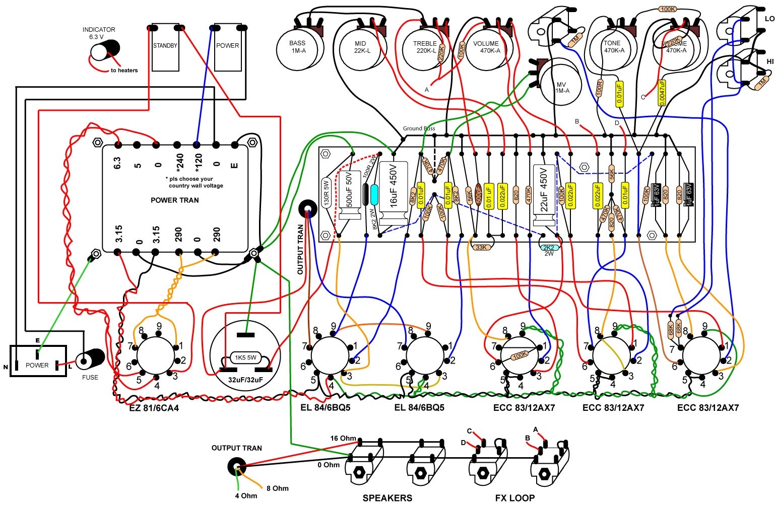

We have built serial effect loops into channels with the switched jack, just in front of the phase inverter. As bobo said though, with mixed results.
Here's one that might help you out. Not our design.
Try a google Search for 18 w effect loop.
BTW, you don't need a tube design, a FET design will work fine.
