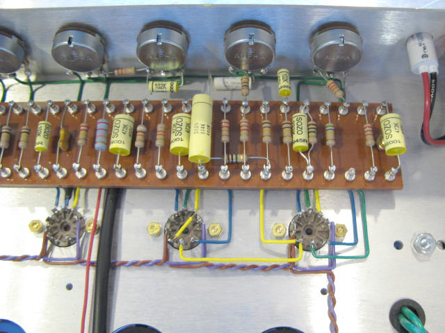

I built the preamp turret board next. The power amp and power supply use another smaller turret board. Some of the wiring in the original Hiwatts runs through plastic tubing to keep it together. You can see tubing on the wires that run from the preamp board to the power amp.
I went with the method Harry Joyce used for attaching the fly off wires to the board. This put them on the bottom instead of the top. It looks neater, but the danger with this method is the wires can end up being too short if you aren't careful with your measuring.

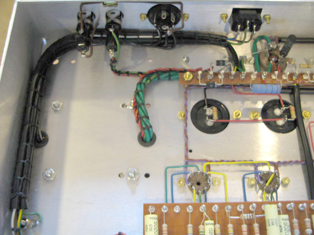

The next step was wiring up the heaters. I did it Hiwatt style where the wires run straight as they pass the tube sockets and are only twisted on runs between the tubes. These twisted runs are short so I just twisted them by hand instead of using a power drill.

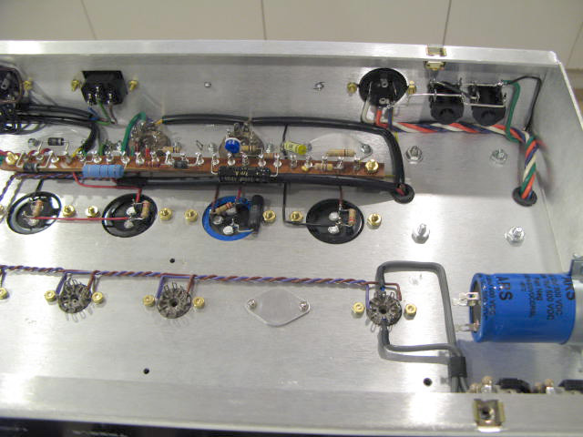

I also assembled the power board, did the AC wiring, and connected the power transformer and the output transformer. More plastic tubing was used to bundle the AC wiring and the primary wires on the output transformer.

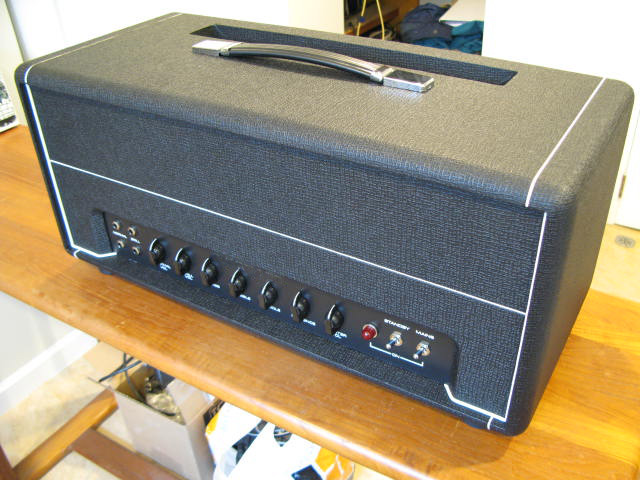

The last thing was to put the amp in its cabinet. I almost hated to do that, though, because it hides the beauty of the chassis and its wiring!
I wish I could take credit for making that beautiful cabinet, but at the time it was just easier for me to order it from VHR. Since then I have made cabinets like that with Tolex and piping. And no corner brackets needed to hide bad Tolex joins on the compound curves! I have also made several cabinets using hardwood, including the one I made for my Trinity TC-15 using an African wood called padauk.
