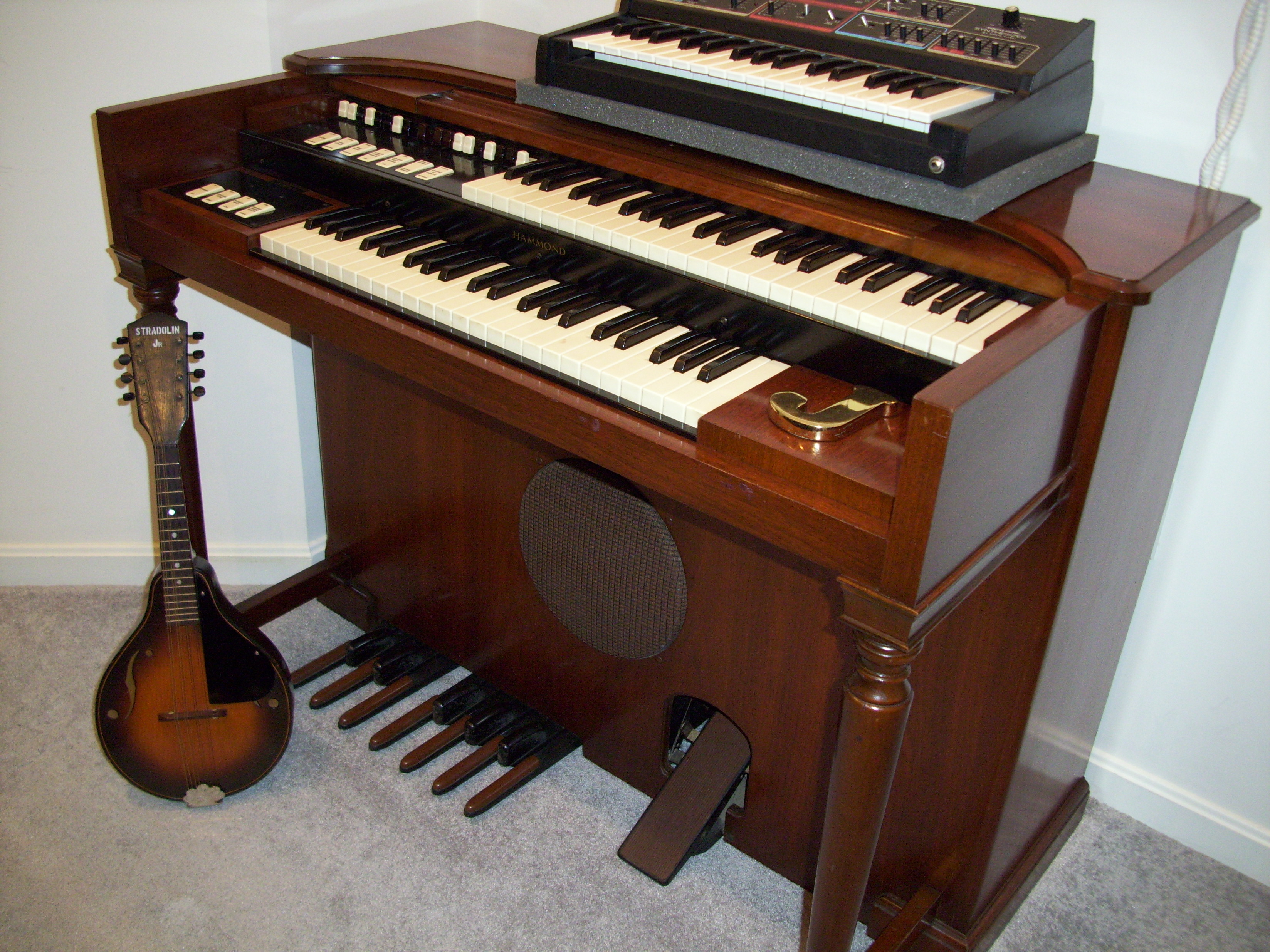

I've always used this light bulb circuit that was posted in Keyboard Magazine a hundred years ago. (At the time anyway) it sounded great through my ADA Flanger and right into my system. It is right off the speaker though, which I'm fairly certain is the way that Leslie always did it. Very cool organ even though it only goes down to a low "F". Great for Long Time, not so much for Green Eyed Lady :|
Joe G
