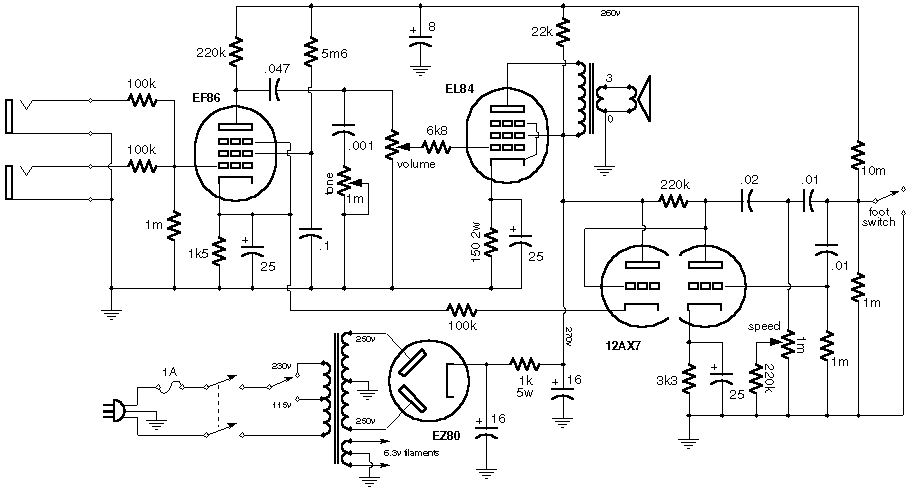

I dont really see anything special about that amp. An EF86 front end AC4 would be more interesting IMO.
AC4 without tremolo perhaps.
VOX AC4

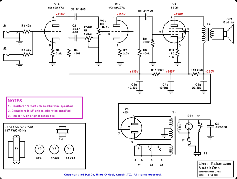

KALAMAZOO 1

Yes, I really like the TC-15 with EF86 and EL84s. I just hate to leave my empty Supro box sitting around collecting dust. I'll check out the AC4, that does indeed look more interesting. Thanks for the helpful advice and the schematic!
