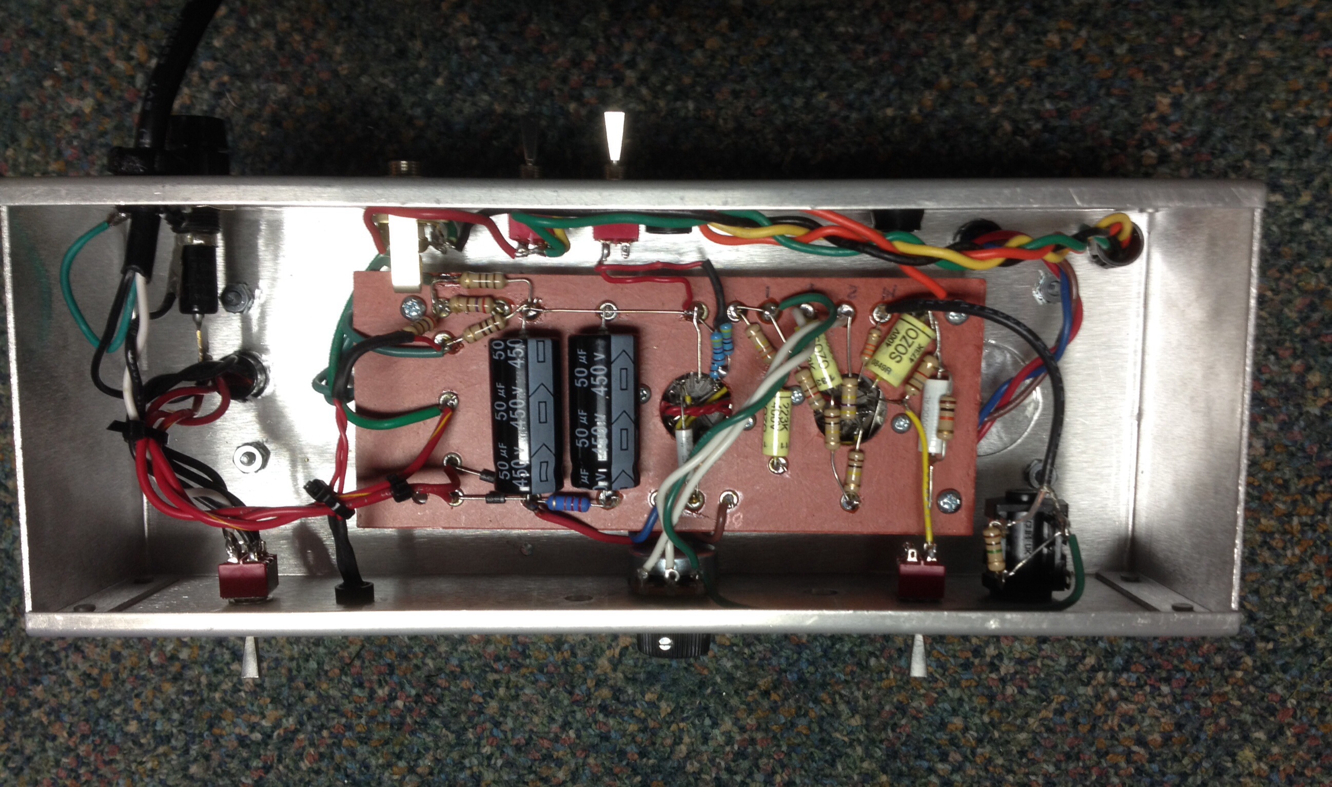

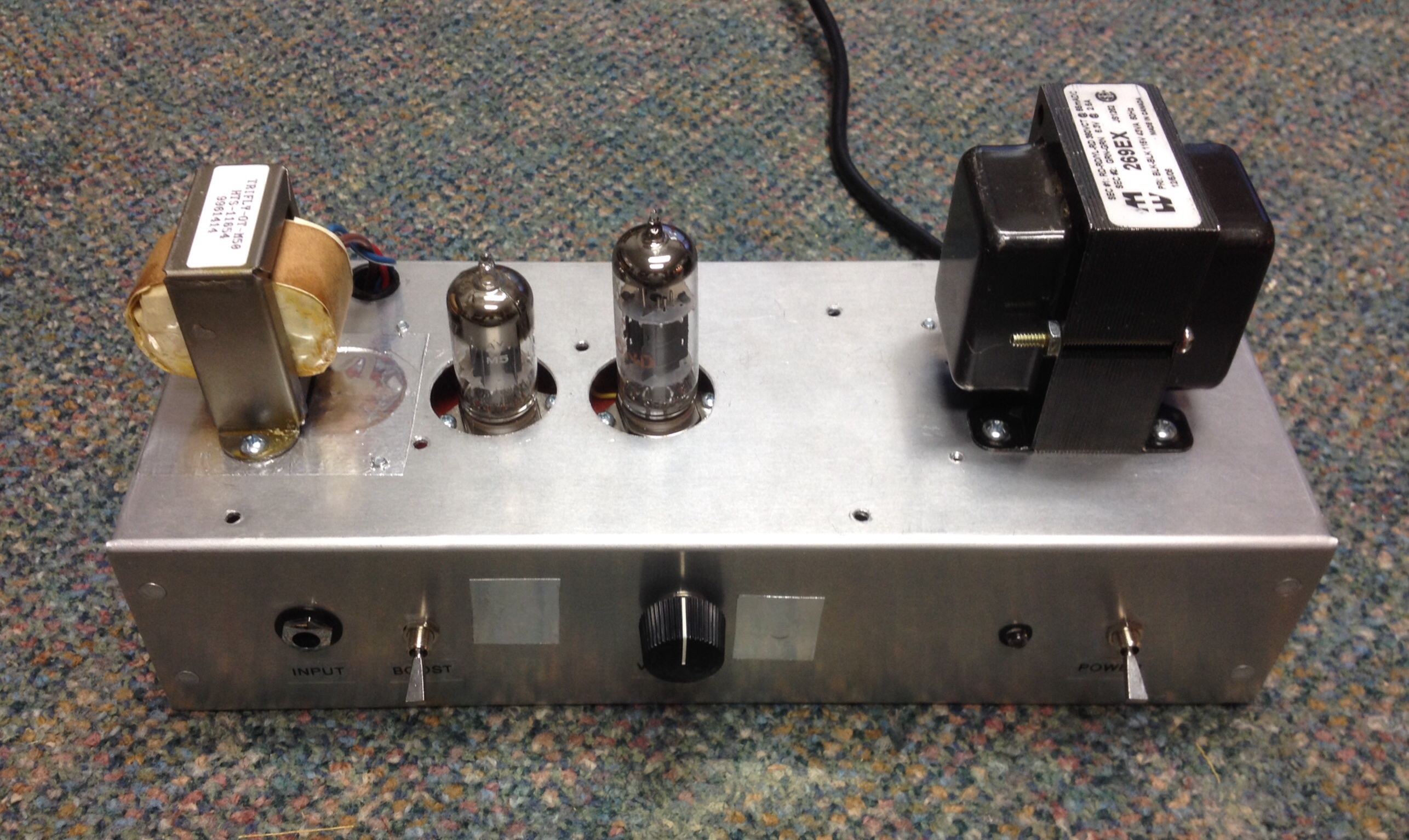

I have since rebuilt the TriFly and plan to get some more feedback on it. I dropped the boost control idea but since added a boost switch to gain it up a bit and fatten it as well. Brent and I picked the transformer based on tone and clarity and we also changed the output tube to an older model with a bit less headroom but more tone. It had better definition than the original but there is a switch to enable a quick swap for comparison. I redesigned the board and popped it back into the chassis for the next round.
The board is not final and the prototype looks like a prototype.
GUTS
