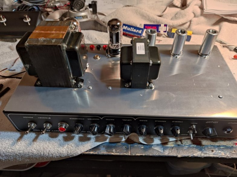

What a fun project. Second trinity amp build.
It worked without messing with it. Measure twice, cut once.
I kinda went rogue with the footswitch but I just felt it out. I never did well with switches on schematics.. :lol:
One burning question????? The OD seems a little high toned, "ice picky" if you will. I've tried it with several guitars.
Either I need to do more exploration with the knobs or change a cap maybe.
I'm using Warehouse ET-65 and a Veteran 30
Anybody have a similar experience???
Cheers

Congrats! It's a great amp!
I would not describe mine as "ice-picky" at all, even with a V30 and especially not with an ET65.
Maybe you should look at your tone-stack wiring again... it is a little tricky on this amp! Lots of stuff to get on that small switch footprint!

Success!!!! I had indeed swapped a .01 and a .001 capacitor. Now it has depth and makes beautiful tones. I am currently falling in love with all my guitars again. As soon as I learn to play guitar I will post a link to my insta @thebraindad
Meanwhile I'll be ignoring everything for a while :D

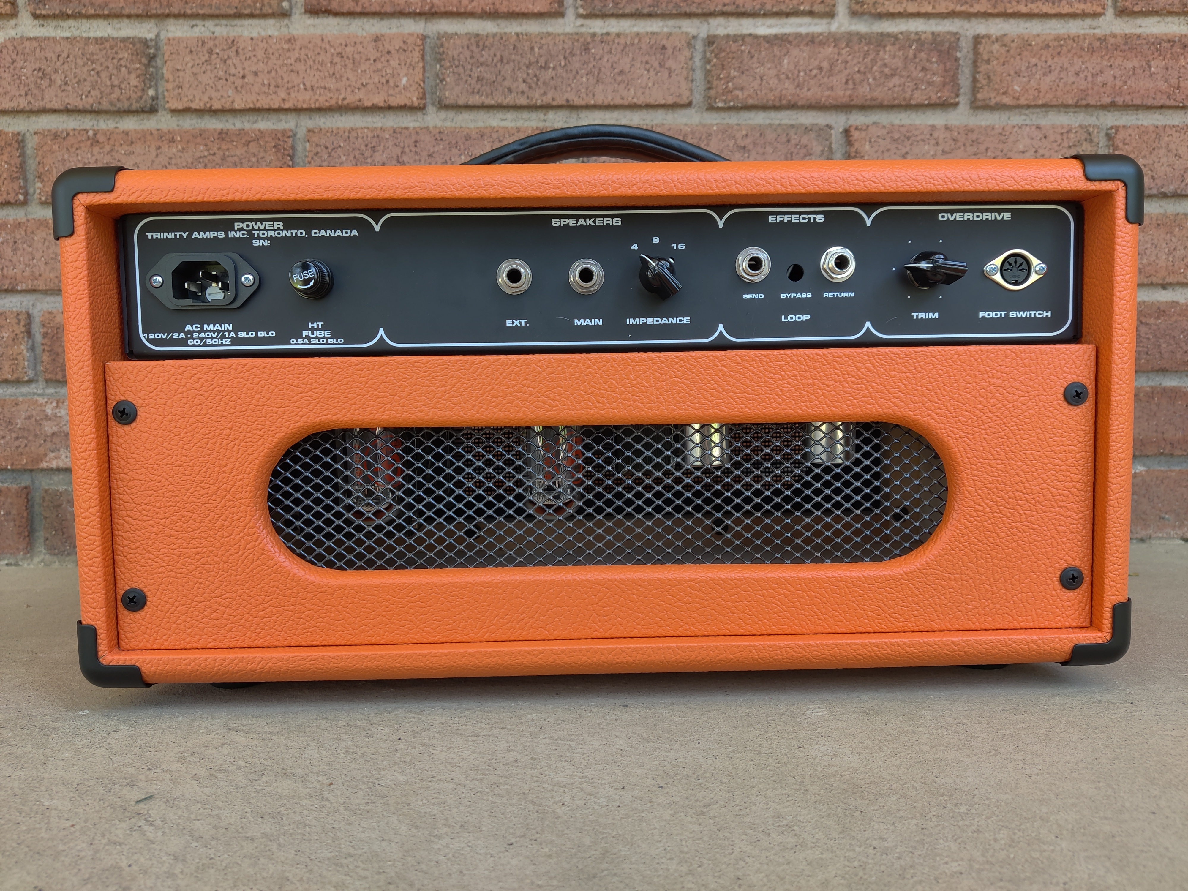

Here's a few shots of the finished monster. Don't stare
