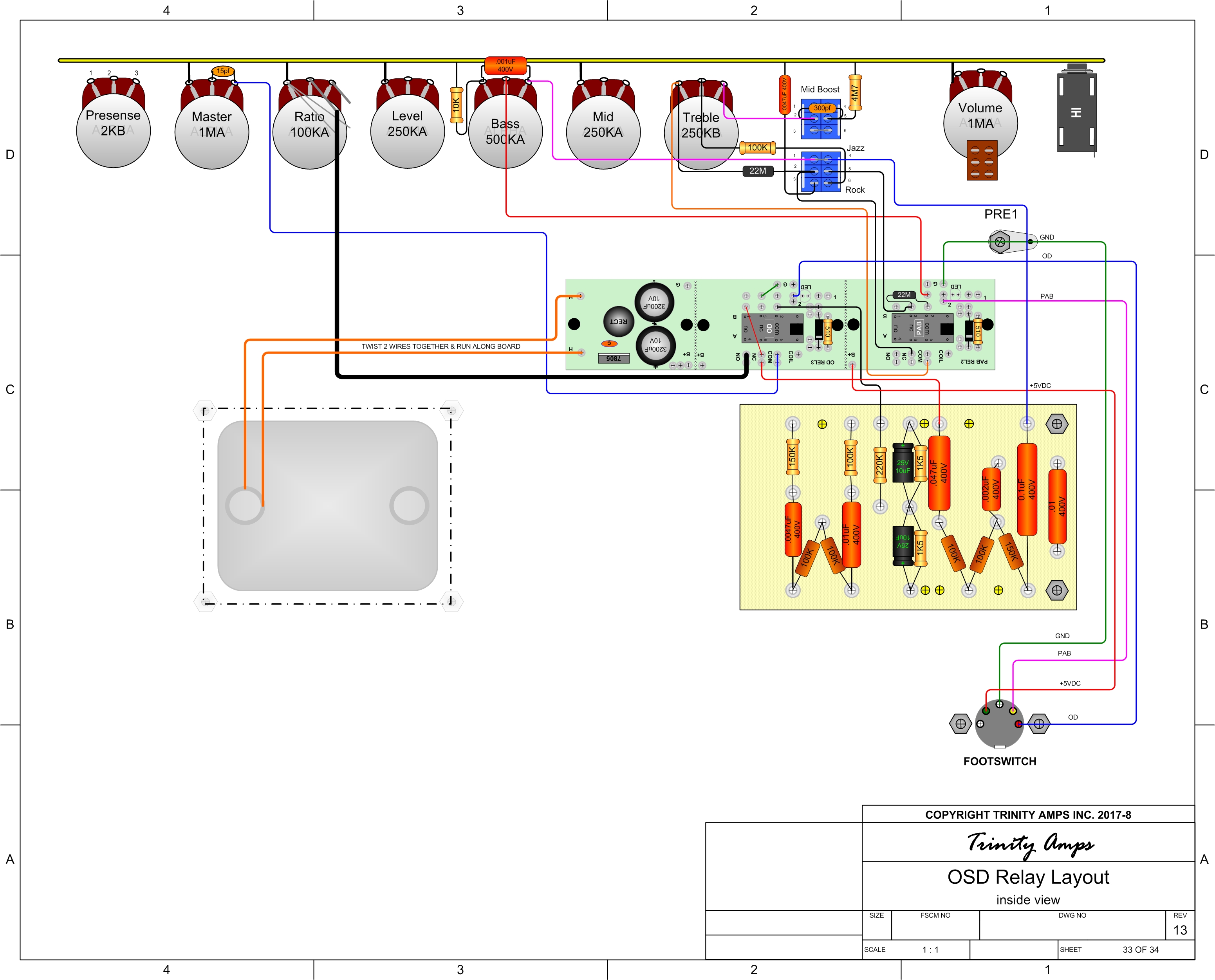

On the PAB section of the relay board, should I have continuity between the lead that goes to terminal 2 of the bass pot and the adjacent 22M resistor, measured at the bass pot connection and at the foot of the resistor on the board? This means I also have continuity through the resistor and the lead on the other end of it to the jazz/rock switch terminal 5.
PostPosted: Wed Apr 25, 2018 8:56 am
Reference Relay Layout.
PostPosted: Wed Apr 25, 2018 9:03 am
Yes, continuity to 22M on board. From switch term 5 to other end of the 22M. See reference drawing.

Thanks for posting the reference layout, I have been working from the same one here (v.13).
My confusion comes from measuring continuity and finding that I have it across the 22M resistor connecting terminals 2 and 3 on the PAB section. The LED light is always on on the board regardless of footswitch position. Is there a way to test the relay? Perhaps the lack of tone control response is due to the PAB being stuck in the ‘on’ position?

Definitely no tone control if PAB is on. Wires are crossed somewhere! Seems like 5V on the relay coil all the time.
Pull the PAB lead to the footswitch off, see if it goes out.
You have to get 0V on the coil to test it in the off position.

With the PAB lead pulled the LED is off and the tone controls function, Master volume does not. The PAB relay would seem to be the culprit if the wiring is all good, is that correct?
