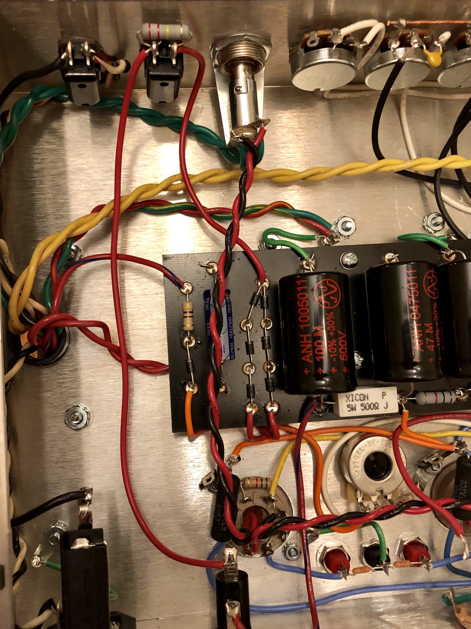

I just built up my OSD and I was running through the final testing phase. I can’t seems to get any voltage at B+ (100uf cap / 5w 500R) junction. The relay works great. Heater wires are correct on the tube sockets. The 2 red wires (secondary) read 333v each, they seem to progressively step down with each diode in the rectifier section. Where they connect I’m getting 0 volts... bad diodes? Anything past that point gets 0 volts. The diodes seemed to test ok on the forward voltage.
I tried disconnecting the output transformer at B+, thought that might have something to do with it, but no.
Any tips would be greatly appreciated. I’ve attached an image hope you can see it. I checked everything over, but must be missing something. Thanks!
The stray red wire is the output transformer which I disconnected.
-Ralf

AC volts measured across the 2 red wires on the board?
DC voltage measured from any diode to ground and at the junction? the reason they are daisy chained is for safety factor is all.
Is there a 500 ma fuse in the HV fuse holder?
If the standby is off, the fIlter caps are not in circuit yet so not part of the equation.

Make sure the Standby switch has continuity when it's supposed to be ON. Check all your wiring to the Standby switch, the fuse holder and the board. Make sure all the solder joints are good. The soldering for the eyelet with the 500 R resistor, the 100uF capacitor and the wire from the fuse holder looks suspect in your picture.
As Stephen said, if the Standby switch isn't on and you don't have good connections to the filter capacitors, the capacitors won't be in circuit and you won't have good DC at B+. At best it would be pulsating DC at 120Hz and it won't read well on a meter.
