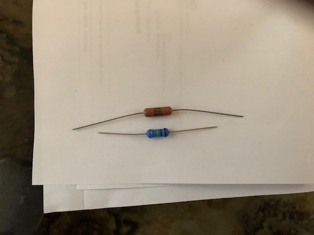

On page 58 of the builder's guide, the power supply resistors are called out as 2 watt. But for the 2K2 and 22K resistors, I didn't get any of the brown 2 watt, but instead have blue (what I think are) 1 watt resistors. For the 150K bleeder resistor, I got both a brown 2W and a blue 1W with the kit (see photo). Looking at the pictures from other people's builds, I'm assuming that for the 2K2 and 22K, and the 150K bleeder, I should use the blue 1W resistors - right?

Blue are actually 2 watt metal oxide resistors.

OK, that makes sense... Thanks!
