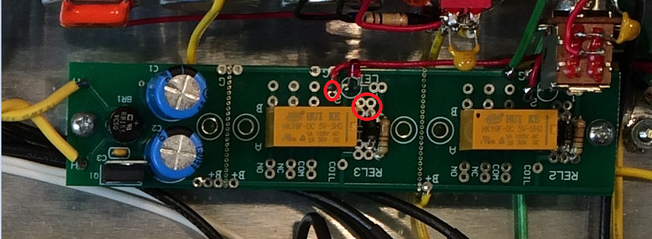

You make good points. As this is my first build ever I will remove those insulators from the speaker jacks. I think my excitement is making me work too fast and I am possibly foo far ahead of myself for my own good. I don't want to bother Stephen too much with my newbie questions either. I'm now at the relay testing and I am not getting my LEDs to light up. I'm not sure if I should trouble shoot the relay but I suspect the LED's polarity may be incorrect. I could not identify the positive end as described in the manual but went with the appearance of the elements that looked the closest to the image in the manual. I dread the thought that my soldering skills have damaged the parts for the relay.

I hope Stephen chimes in here if not you may want to Email him. . . I Think some changes were made to the way the relay was originally wired and activated, & he never changed the test procedure. The way it is wired on the layout it is now activaed by connecting the ground, the test procedure shows connecting the 5volt B+. When you wire the footswitch it is connecting & disconnecting the ground. Try using a small peice of wire to connect the footswitch wires to ground, If you followed the layout the wires that go to the footswitch can be connected to either of the locatios I have circuled. Jump that to ground. That is the connection that will be made by the footswitch . . The layout does not match "Exactly" the connection points on the relay board so care must be taken to get those connections right. . . Try to take your time , this amp is more difficult to build than most & the relay adds another layer to it. I Think it would be helpful if Stephen could add a good picture of his completed relay board as the pictures he has show the board very well but it is not finished. . Joe

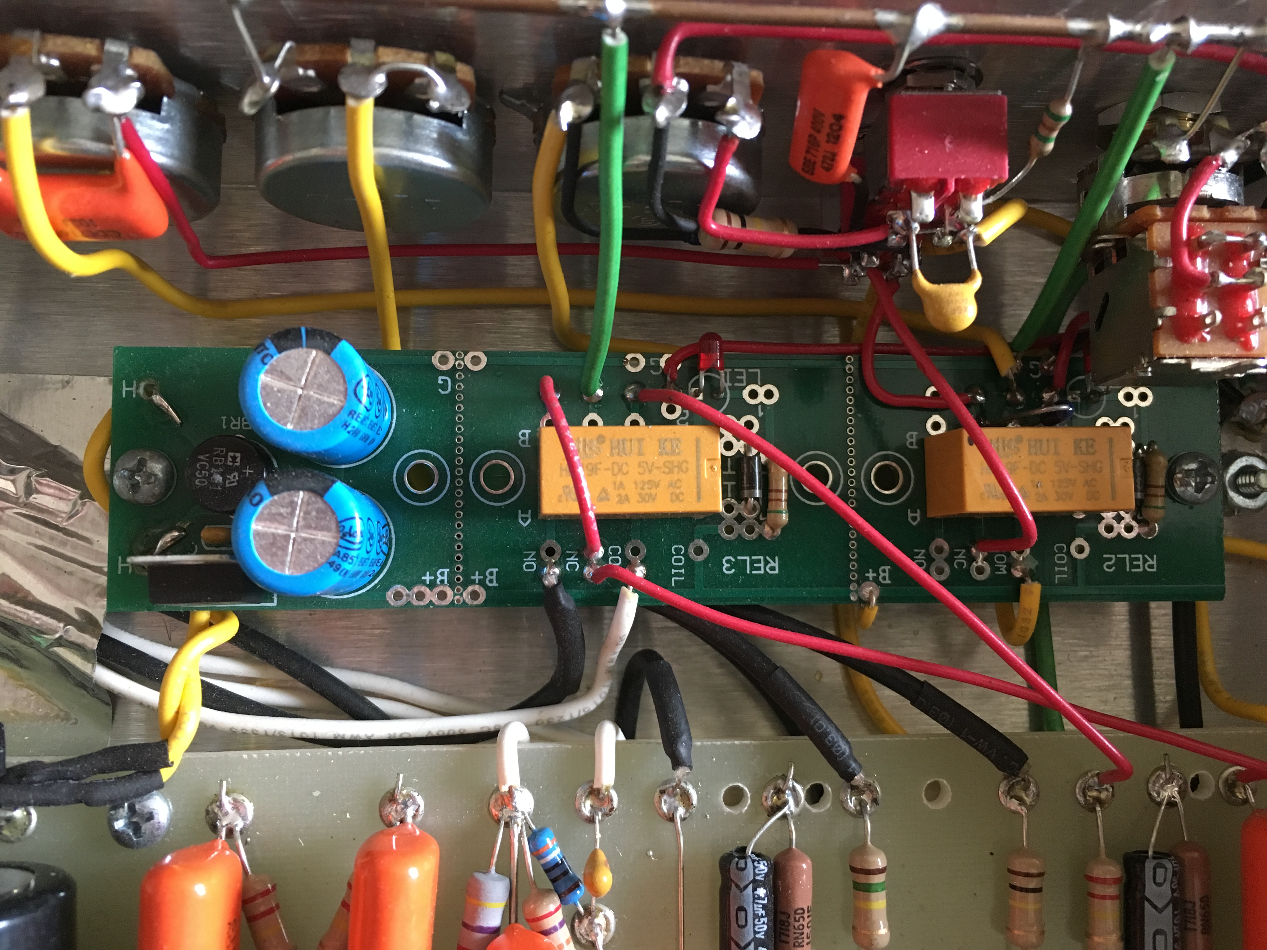

Sorry I missed the conversation. The relay wiring and test procedure has been corrected pand updated and if you didn't get a notification, let me know.
To Test the Overdrive RELAY Board
WITH NO TUBES INSTALLED
To test the RELAY board, you need to first confirm that
the PCB power supply is developing 5VDC.
Turn the power on and measure the DC voltage between
the PCB pad labelled B+ (this is not amp B+!)on the board
and the pad labelled G (ground) .
You should have measured 5VDC between the RELAY
board B+ and G (ground).
Apply 5VDC to each
RELAY coil by means
of small jumper. Run
the jumper between the
LED Cathode to the
ground bus to test.
When applied, the LED
should illuminate as you
energize each coil.
TIP: If you build the
Footswitch now, you can also test the RELAY board using
the footswitch.
https://www.dropbox.com/s/0ros8mhisbm22 ... d.pdf?dl=0
