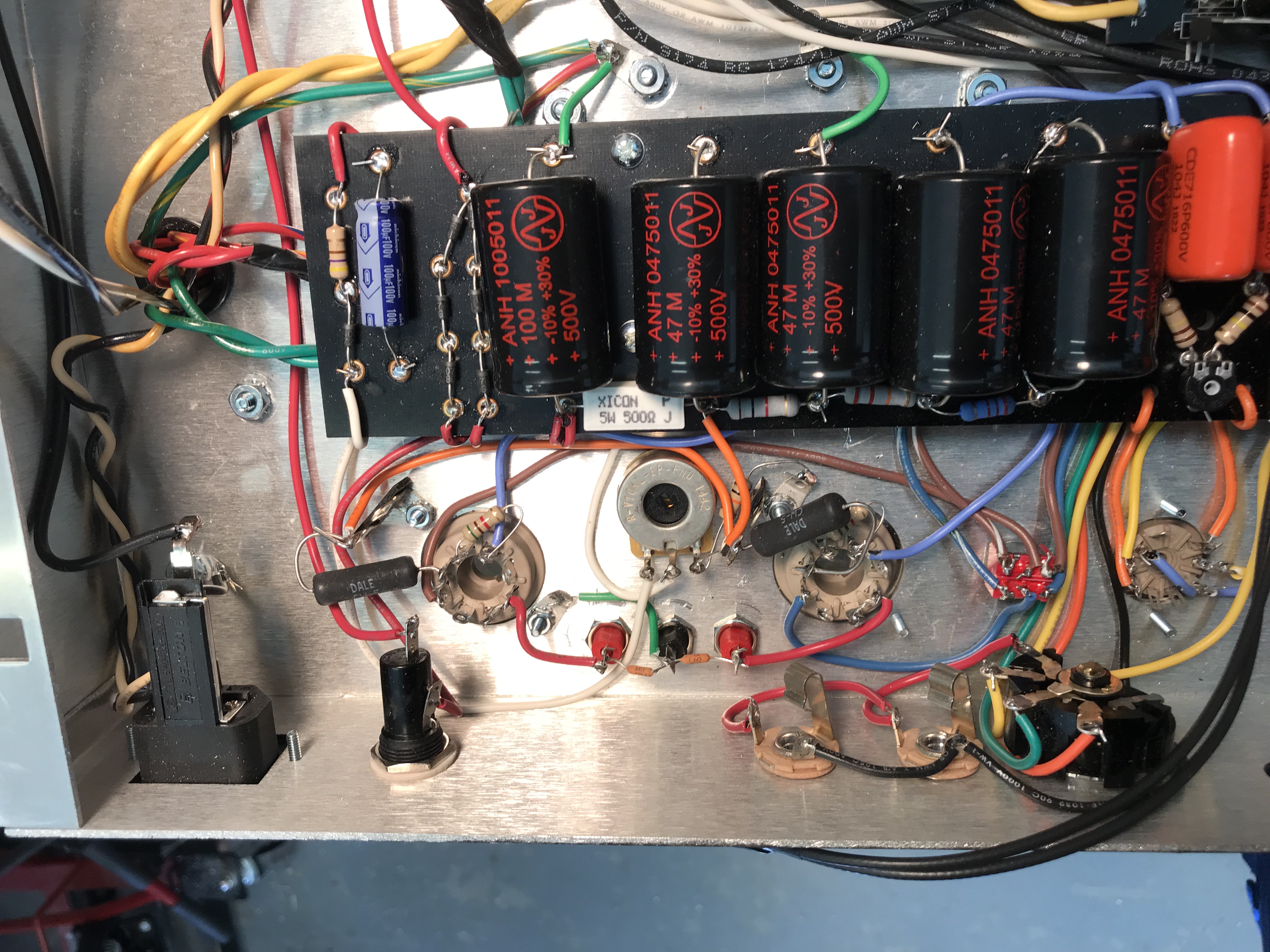

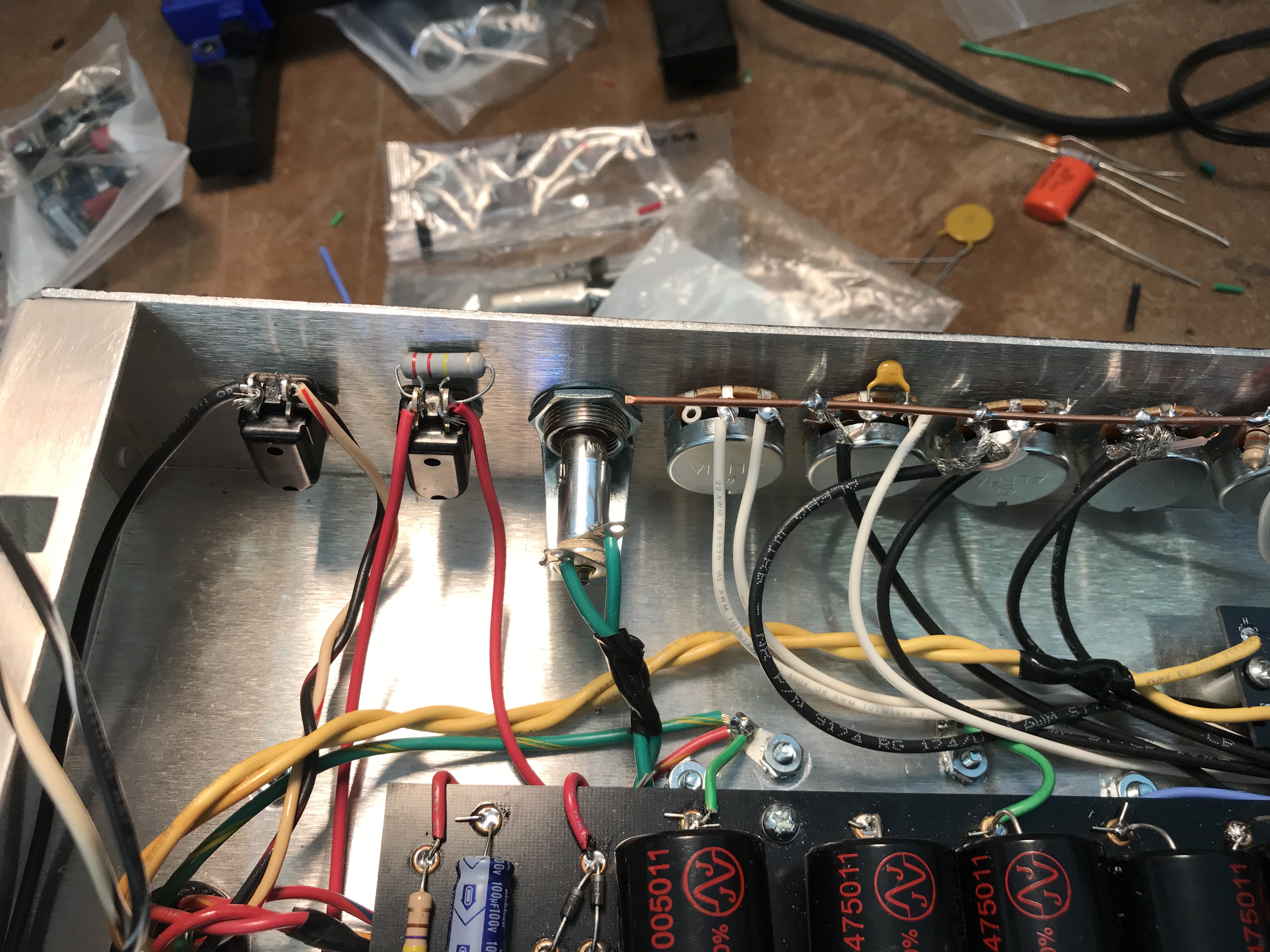

Getting close to putting this build to bed, hopefully. But I have one more question before I begin startup. There appear to be two extra wires coming off the power transfoermer, one white with a black stripe, and one black with a white stripe. Can I just tape them and tuck them inside the chassis, or should I do something else with them?
Thanks for the help!

Check the NOTE at top of page 50. Wht w/ blk tracer and blk w/wht tracer NOT used for 240 VAC or 120 VAC applications. Insulate ends w/ heat shrink and tuck out of the way. Build Guide ver. 1.16, Feb 2018.

Thanks. That’s what I needed to know. Guess I’ll have to read closer next time. Powering it up in the morning! I’m hoping for no issues...
