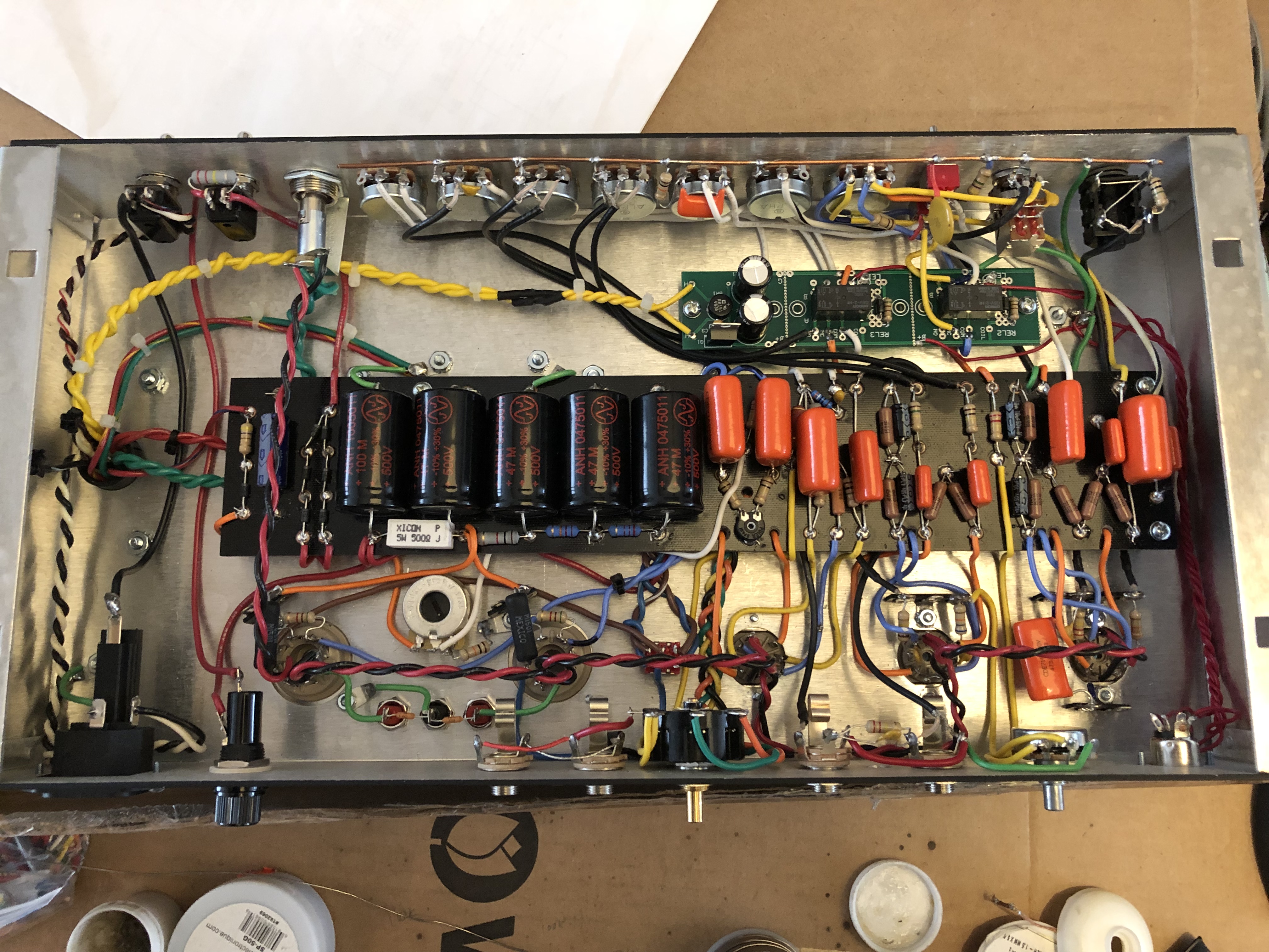

I’ve been moving very slowly though the kit. Here’s where I’ve ended up today. All done except for the heaters and the foot switch. So far so good (I think!). The only hiccup I ran into was that I found it difficult to complete the connections on the jazz/rock and mid boost toggle switches with components already mounted. I ended up stripping some off to get better access to the terminals then re connecting everything from the bottom up.
I’m having a blast but after months of working on it a few hours a week I’m looking forward to getting it going!

All done, now time to check it over.

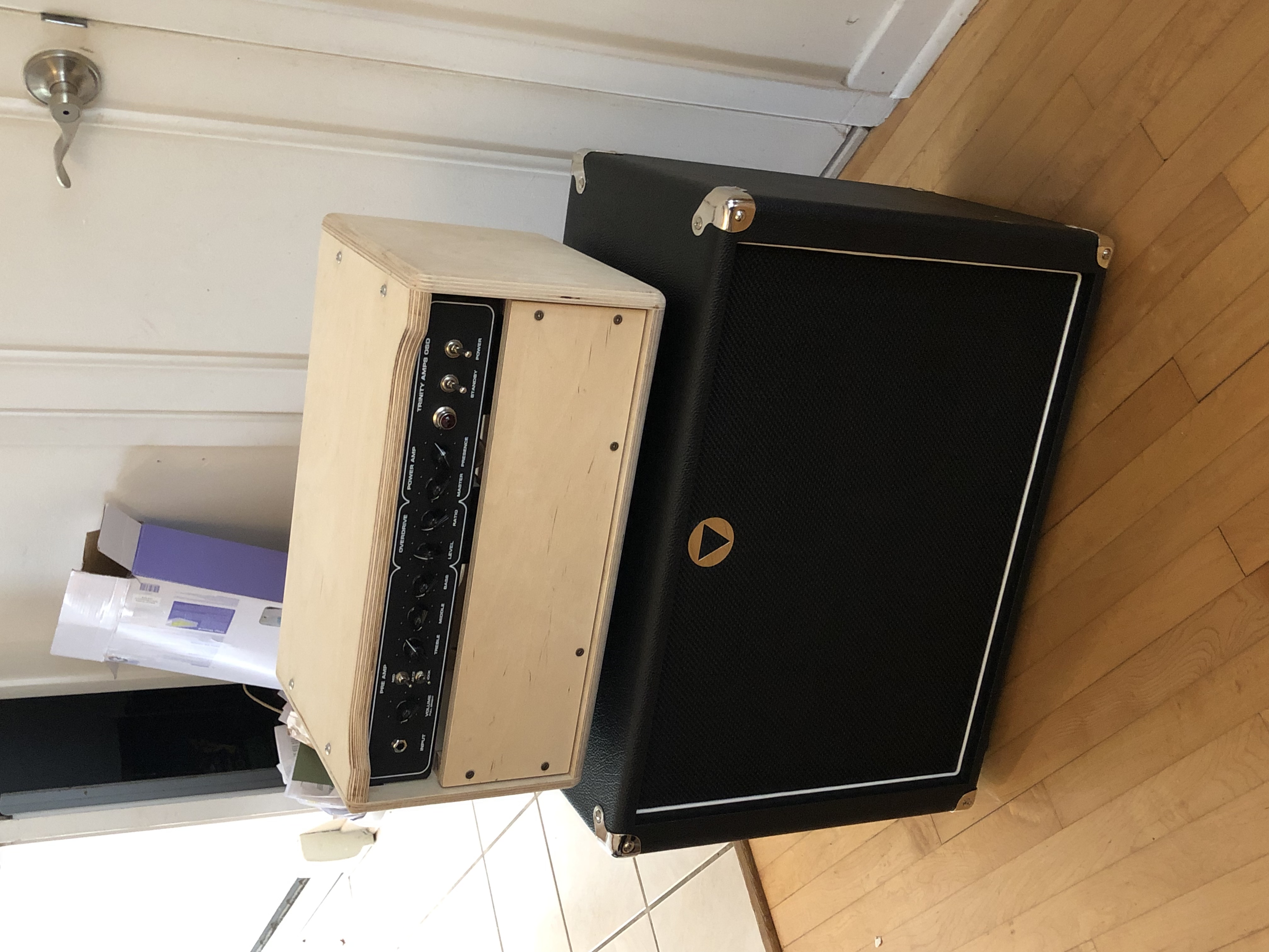

I finally was able to build (with the help of a friend who knows how) a head cab for the osd. It’s not finished, no handle, feet, covering ect. But I wanted to try it out on a gig so I took it out last night. It worked beautifully! The cab has a tone tubby red in it which I picked up used. Based on what I’ve read it seems people prefer ceramic speakers in this kind of amp but the red is a good fit for me. The amp sounds fantastic.
I like the look of the wood so I’m considering varnishing the head rather than tolexing it.
The front panel is a bit short so I think I’ll cut another and screw it on from the back so there are no screws on the front. I’m guessing that’s how it’s supposed to be installed anyhow.
Here’s a shot of it so far.
