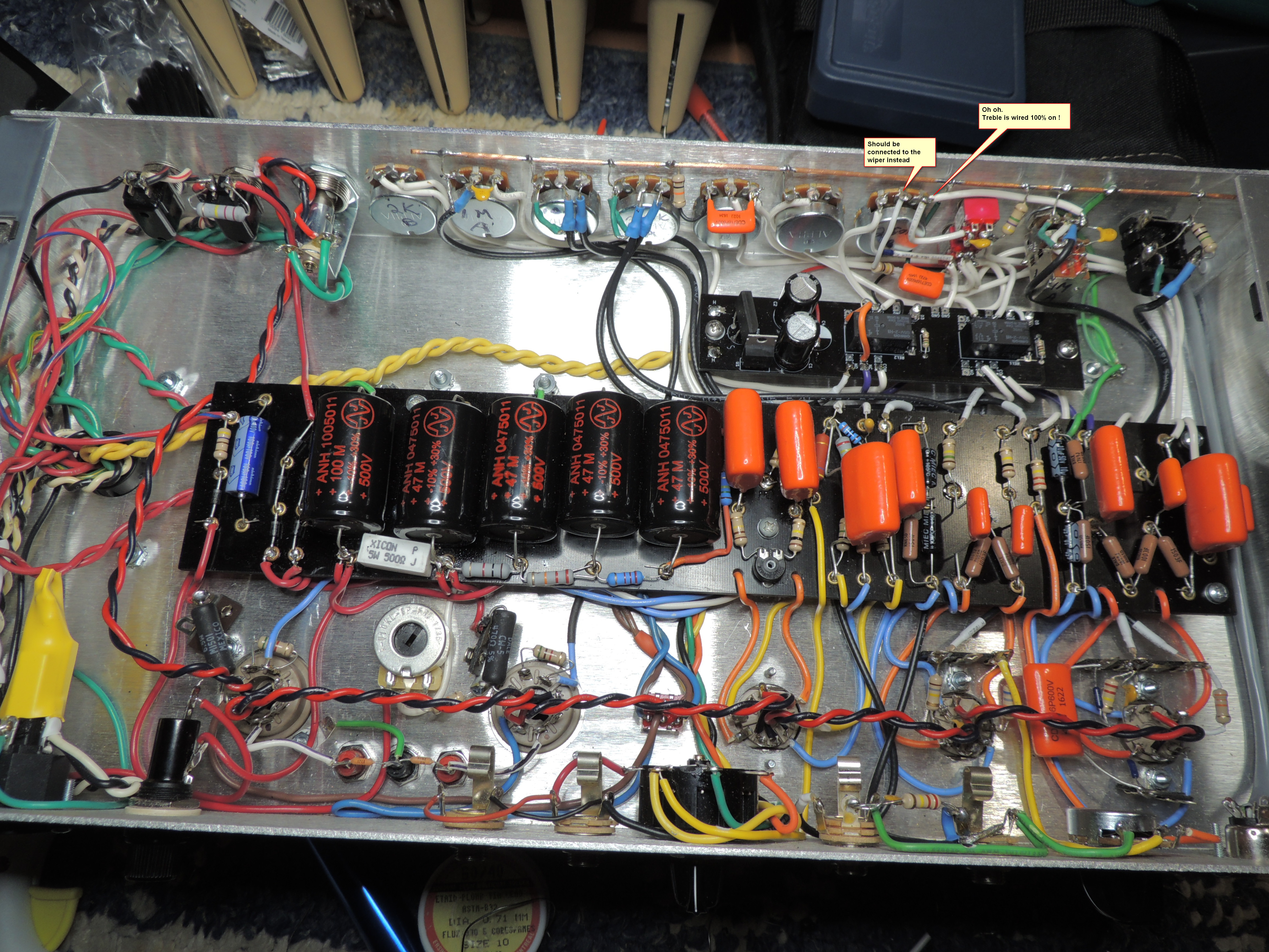

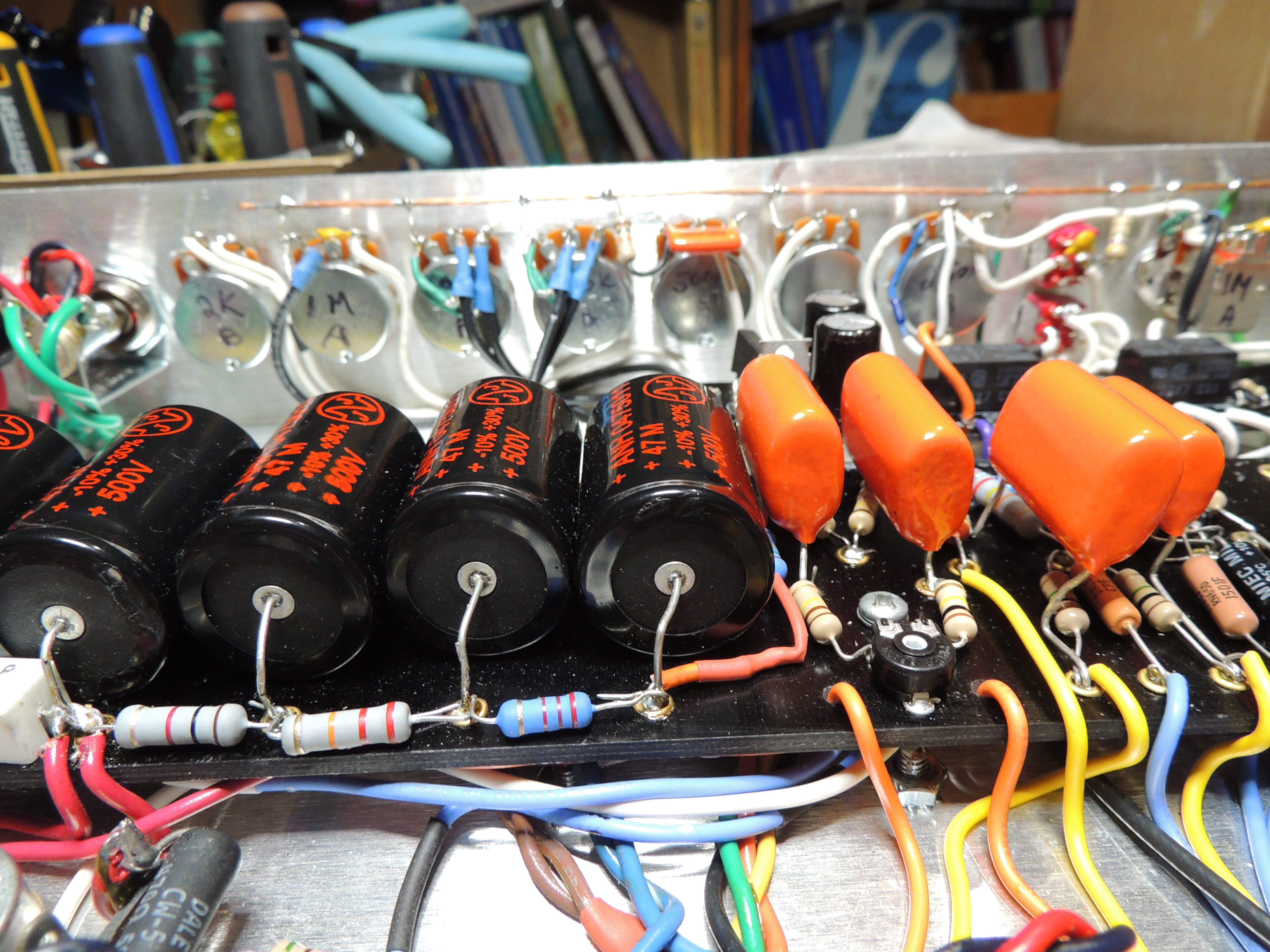

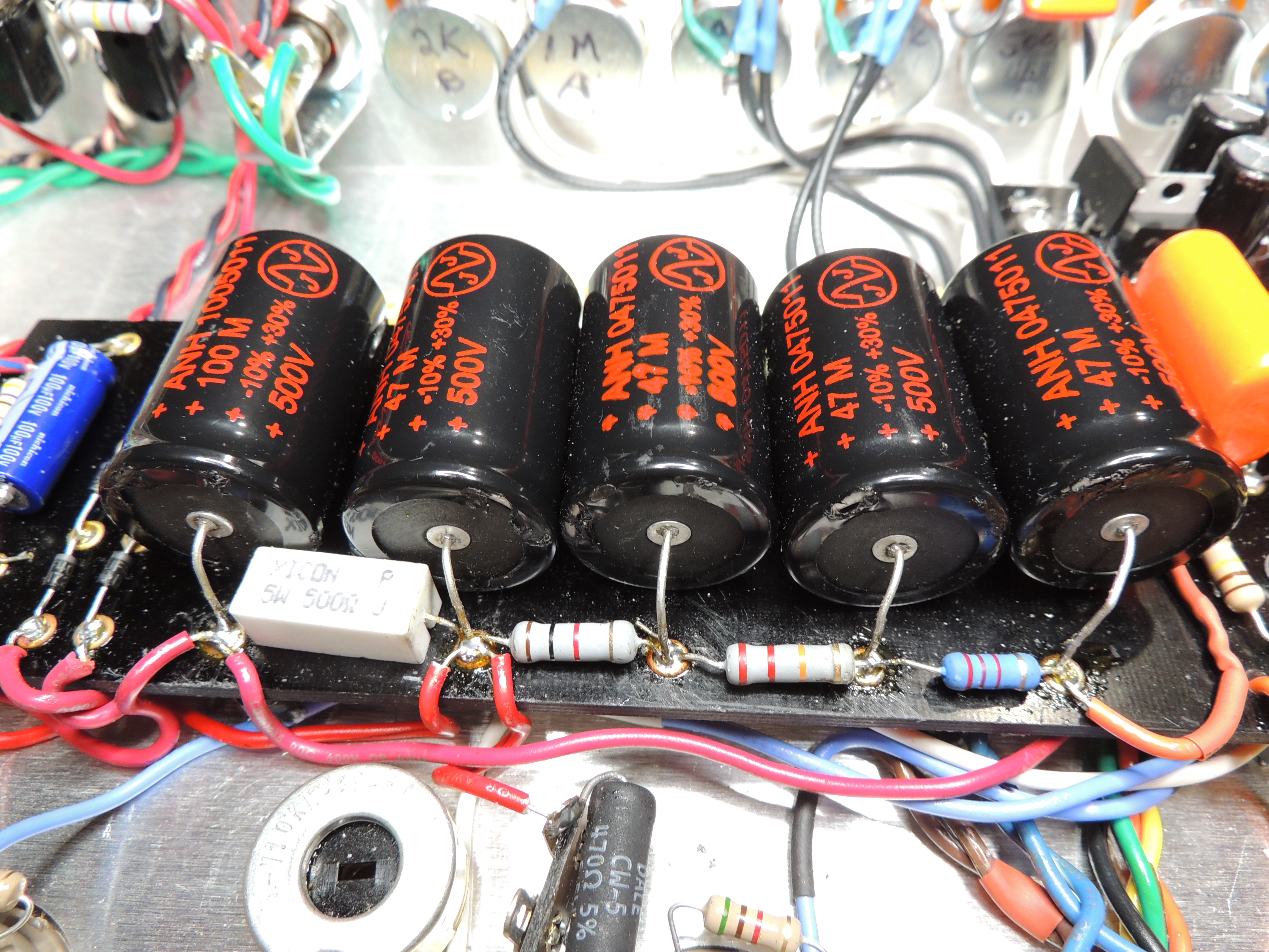

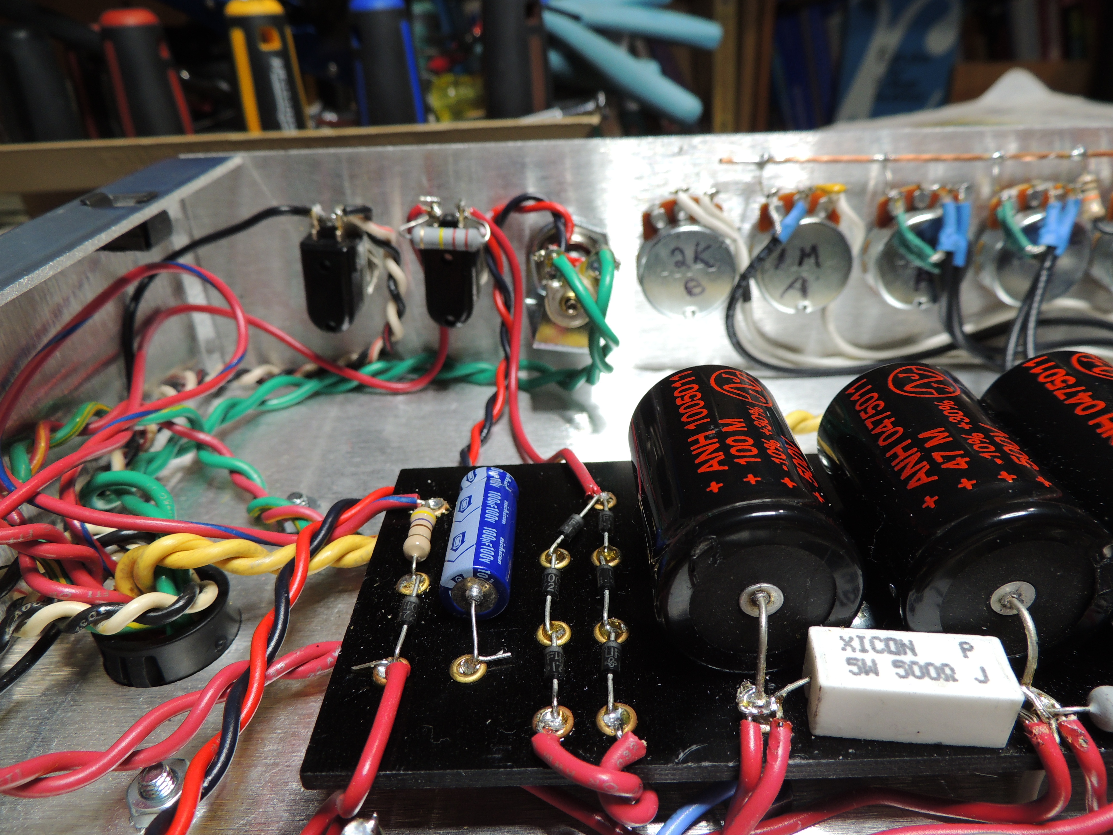

I checked resistance among all of the leads & wires at B+1. And I did the same for B+2 through B+5. Most are at 0.0 ohms, with only 1 or 2 at .1 ohms.
I even re-heated the eyelets and ensured good contact among leads at B+3 through B+5. No changes in voltages.
And attached are some photos.

 Post subject: Re: Voltages - too low?
PostPosted: Tue Feb 18, 2020 11:39 pm
Congrats for getting so far!!
They are low and it would be ideal if you could increase them. Can you confirm that you used the 120V connections and not 110 by accident. That would make a 10% difference.
I would like to know what the AC voltages are, no tubes installed (i.e. no load) .
Presumably when you back off on the bias, the DC voltages rise.
I just built an OSD and voltages were bang on so yours should be as well.
All that said, if you like it, it is good!

Looking at some of the solder joints at the eyelets (especially where there are multiple wires and components connected at an eyelet), it appears some component leads are wrapped around other leads and some eyelets are not completely filled, i.e the power resistors and 47uF capacitors. Also wiring leads (it's okay to leave SOME bare wire exposed) have the insulation very close to the eyelets. Consider reflowing and possibly adding solder to the joints AND having all component and wire leads inserted and soldered into the eyelets. I had problems :bugeye: with my (first) Tweed build due to unfilled eyelets and lugs. Had to remove leads, use the solder sucker, and resolder. One bad connection can lead to lots of problems. Best of luck and hoping you get your voltage issues resolved.

I removed the wires & leads from B+1 through B+5. Used the solder sucker. Then re-installed the wires & leads and re-soldered those 5 eyelets. (photo of the improved results attached).
I also re-flowed the solder in the eyelets with the 6 diodes on the left hand side. And re-soldered the red lead connecting the joined diode pair to the standby switch.
The voltages at B+1 through B+5 remained unchanged.

Hi George. I'm far from an expert, but that's never stopped me before. Here's what I can make of the numbers you posted:
Your DC current through R43 looks to be about 16mA with tubes installed ((416V - 408V) / 500R = 16mA), and about 6mA without tubes ((448V - 445V) / 500R = 6mA). For comparison, the callouts on the schematic suggest about 8mA DC with tubes. Your R43 currents seem high.
You also have about (408V - 400V) / 1k = 8mA DC through R44 with tubes, and (445V - 443V) / 1k = 2mA without. The schematic calls for a 7V drop across R44 (i.e., 7mA through R44, with tubes). Without tubes, it looks like the only thing drawing current from B+2, B+3, B+4, B+5 should be R47. This works out to a little over 2mA DC through R43 and R44 without tubes. In other words, your R44 currents look about right.
So your B+2 current is about (16mA - 8mA) = 8mA with tubes, when we'd expect something closer to one or two mA.
And your B+2 current is about (6mA - 2mA) = 4mA without tubes. Without tubes, I don't think anything should be drawing current from B+2.
I'd look super-carefully for anything that might be drawing B+2 current. If you can't find anything, then maybe C32 is leaky? To check that, you could try disconnecting C32, powering up with no tubes, and seeing if your current through R43 drops down to ~2mA. Once that was sorted out, and the no-tubes voltages were looking more sane, I'd install tubes and double-check the bias on V4 and V5.

Your AC voltages are very good. You could check to see that the connections to the diodes are good. Also check that the connections to the Standby switch are OK and the switch itself has good continuity when closed. With the Standby switch closed you should read the same DC voltage at the junction of the cathodes of the two diode strings, at both terminals of the Standby switch, at both terminals of the HT fuse, and at the junction of C31 and R43.

Nice work. Here's what I got from your Feb 22 post:
I disconnected C32 (at the ground side). Without tubes, the B+1 through B+5 voltages were: 454, 453, 451, 391, 385
This looks perfect to me. (454V - 453V) / 500R = 2mA through R43. That's just what we were hoping for. Looking at these numbers I'd say it's a clear smoking gun that C32 is leaky. I'd replace that cap outright.

Thank you, mitch m for your suggestion. Earlier, I verified the diode connections. And I confirmed the voltage from where the diodes join, through the Standby switch, both sides of the fuse and to B+1 (junction of C31 & R43). All voltages along that path agreed.
