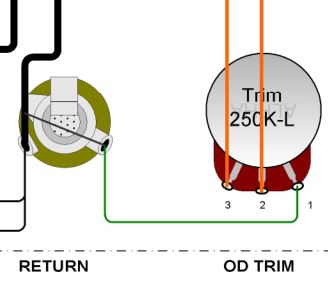

Layout diagram shows pin 1 to GND, which means the Build Guide and Layout do not correspond!:
Build guide pg.70 shows pin 3 to GND:
Just for completeness here's the schematic (pin 1 to GND):
In contrast, build guide pg.68 has pin 1 to the 220k resistor (please ignore my correction in red):
I'll ping Stephen to see if we can get the final word on this. Thanks!
PostPosted: Wed Feb 10, 2021 12:17 pm
The change was made because the trim was wired in reverse so it was a simple matter of switching the leads to pin 1 & 3 to correct it. (Worked but in reverse)
Correct Layout here: https://www.trinityamps.com/docs/OSDLayout20.pdf
Builder's Doc updated as well and posted here: https://www.trinityamps.com/docs/OSDBui ... de1291.pdf
No change to schematic.
