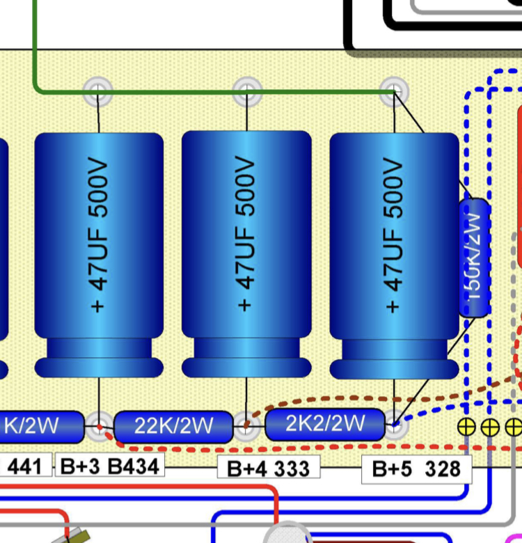

PostPosted: Wed Feb 17, 2021 12:13 am
Check the values of the resistors in the last two power supply nodes. Maa as jexsurecthey are wrll soldered in place.

19.9 and 2.0 left to right
I was so hoping you had found the problem. I just soldered them again, and the readings are the same.

Update, In checking and re-checking I found this 220k resistor( yellow arrow) was measuring 120k. I switched it out with another 220k that measured correctly, and the new one installed reads the same 120k now. It is connected to the relay board at the Com point(red arrow). ??? So, that's problem, but I don't know where to look next. Could that be the B rail low voltage problem, or is it something new and unrelated ?
PostPosted: Thu Feb 18, 2021 9:25 pm
That value is affected by the trim pot so measuring in circuit is not reliable.
The PI pin 1 plate value is out of whack so check the value of the resistors and also the solder connections.
Get that right and we can move on.
