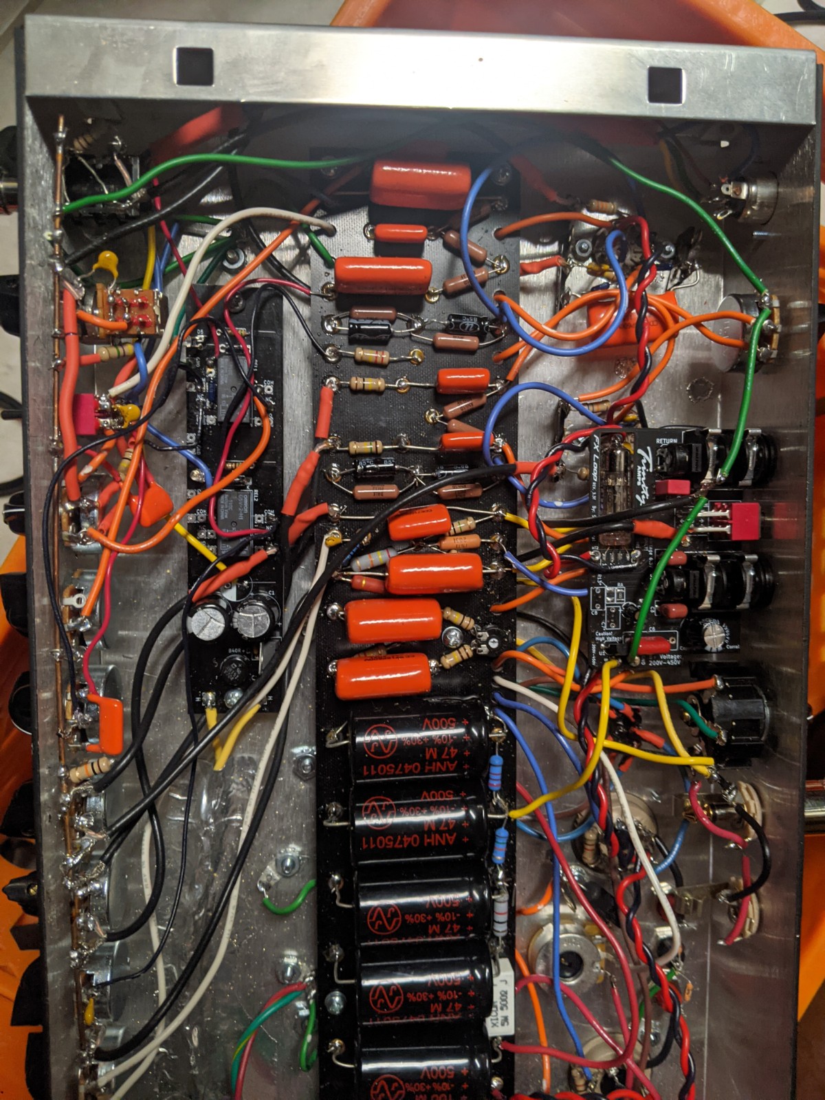

Im happy to say that after about 30 hours spread over a few weeks, I fired up my OSD last night and got pretty great results. Until this point the most wiring I had ever done was hooking up some pickups. You guys can use that as a testimonial on the website!
Here are the 3 misfires that I noticed...
1) When I plug in the foot pedal the system goes silent and the Test LED on the relay board lights up.
2) The overdrive Level and Control arent having any effect on the sound/tone whatsoever. All other control knobs work as expected.
3) When I flip the switch on the buffered effects loop the system goes silent.
Ill attach some photos, since i am sure that will be helpful in diagnosis.
Thanks very much to those of you that support begginers like myself. If I ever learn something useful, ill be sure to pay it forward!

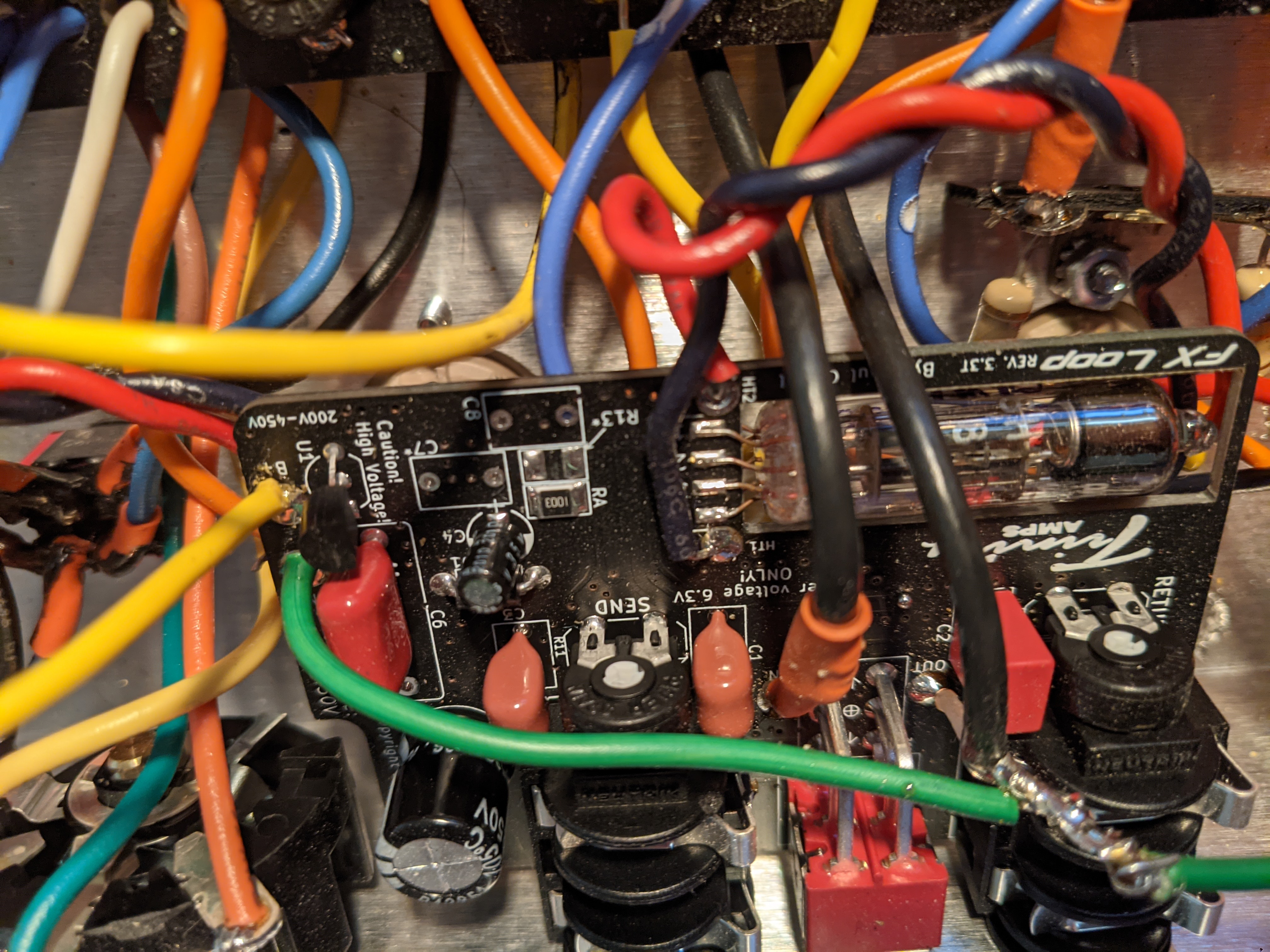

Attaching a couple pic of what go moved to match the diagram that you shared... I melted the OD Relay a bit by mistake but nothing has changed since before that happened.

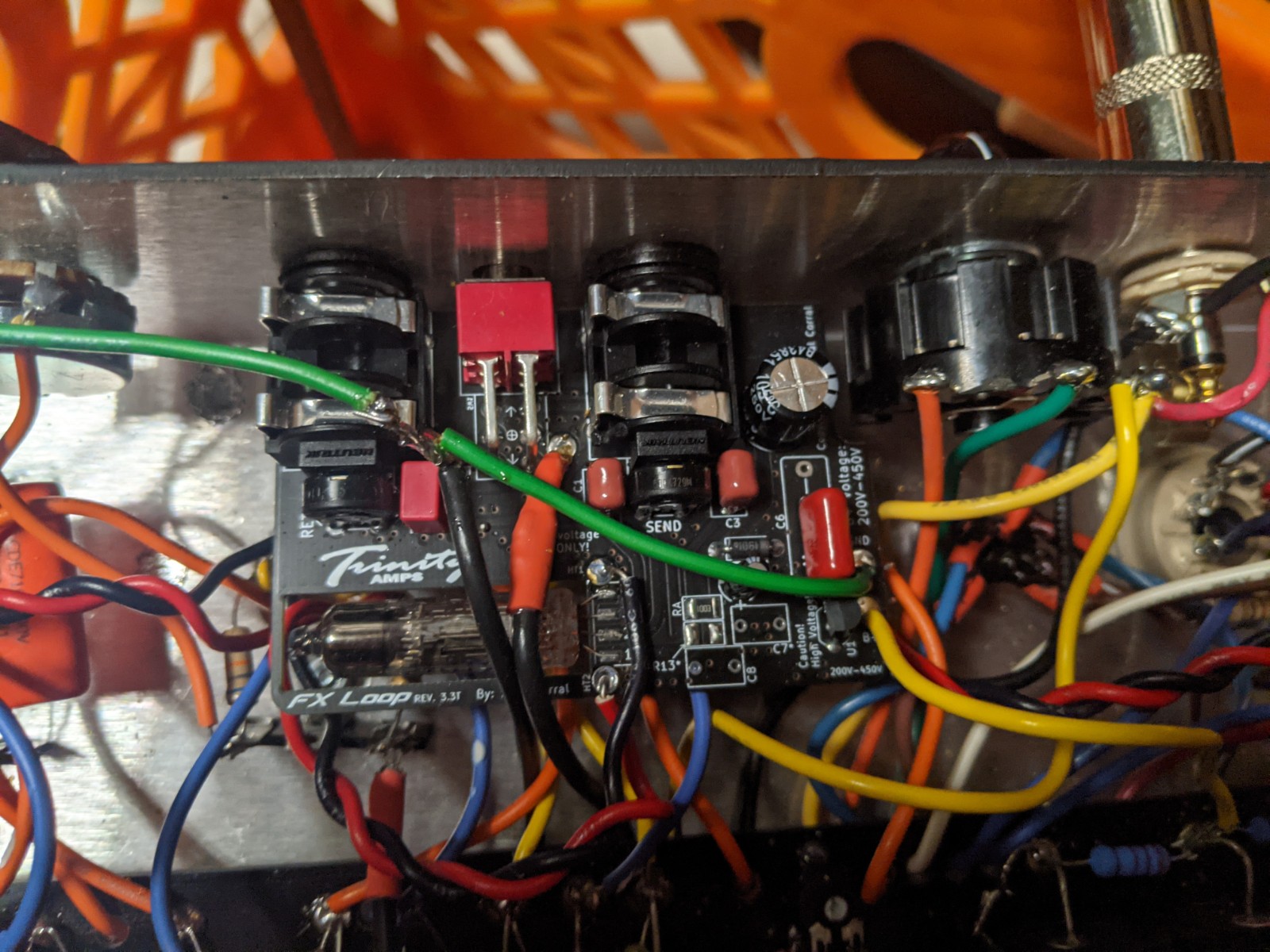

FX Loop. Checked continuity on everything. was able to get a quiet overdriven sound when I turned both the mather and volume all the way up, but could not hear the effect at all.
In is connected to Master Out is connected to that .022UF on the board.

PostPosted: Wed Aug 25, 2021 1:29 pm
Joined: Sun Feb 07, 2021 2:53 pm
Posts: 45
