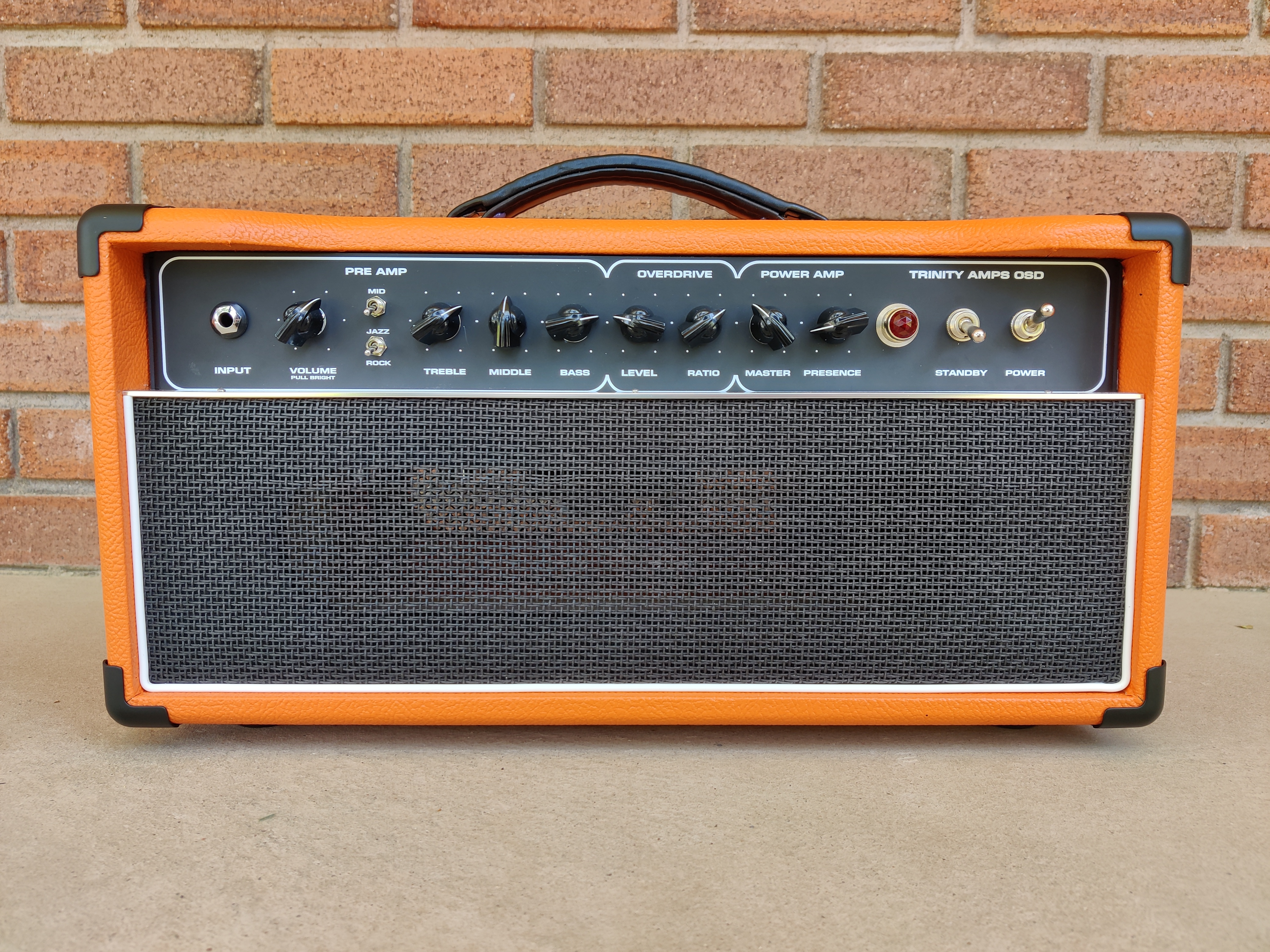

Here's a few shots of the finished monster. Don't stare
