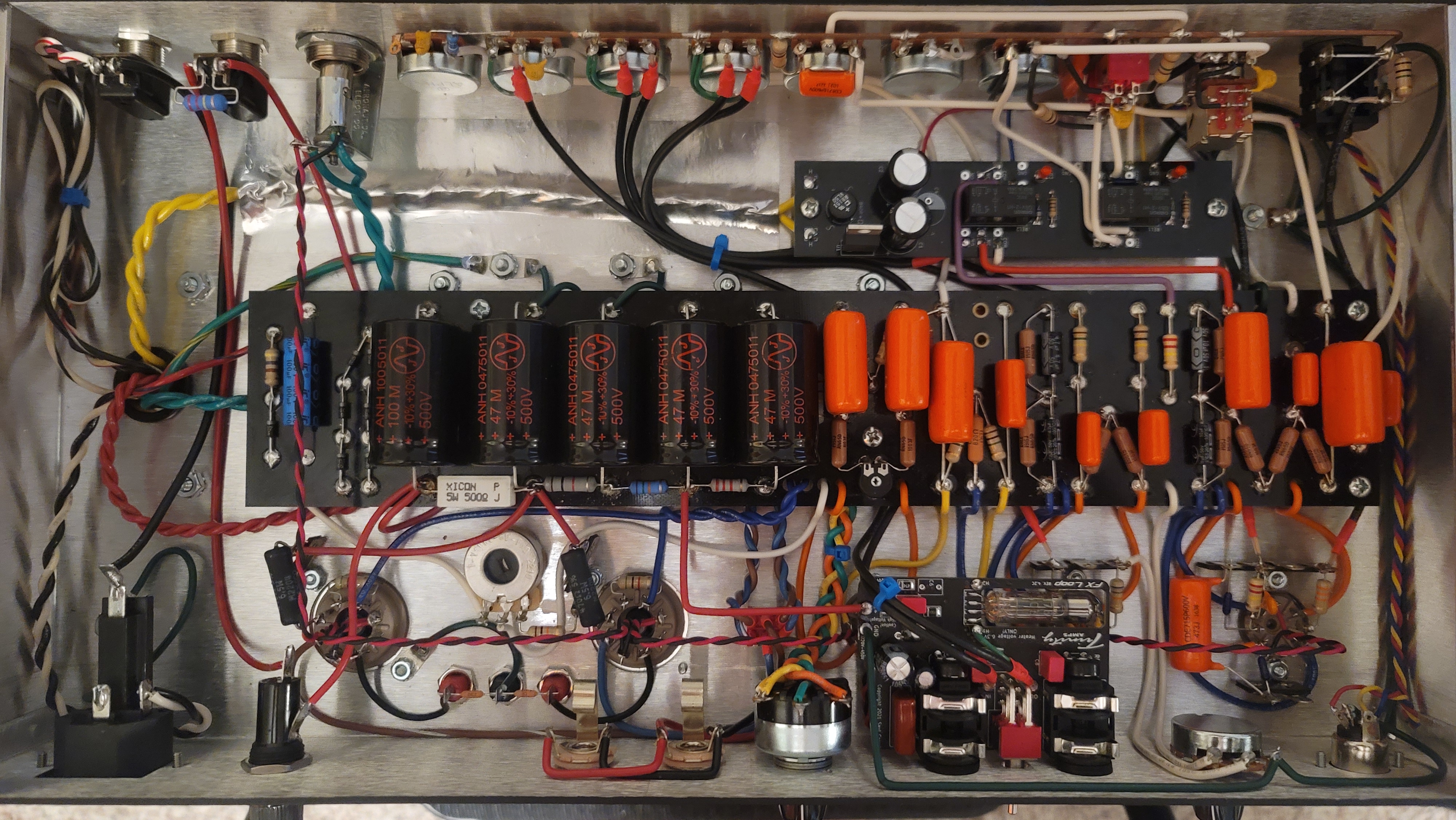

Hi Trinity community!
I just completed assembly of my OSD kit with Buff Fx loop.

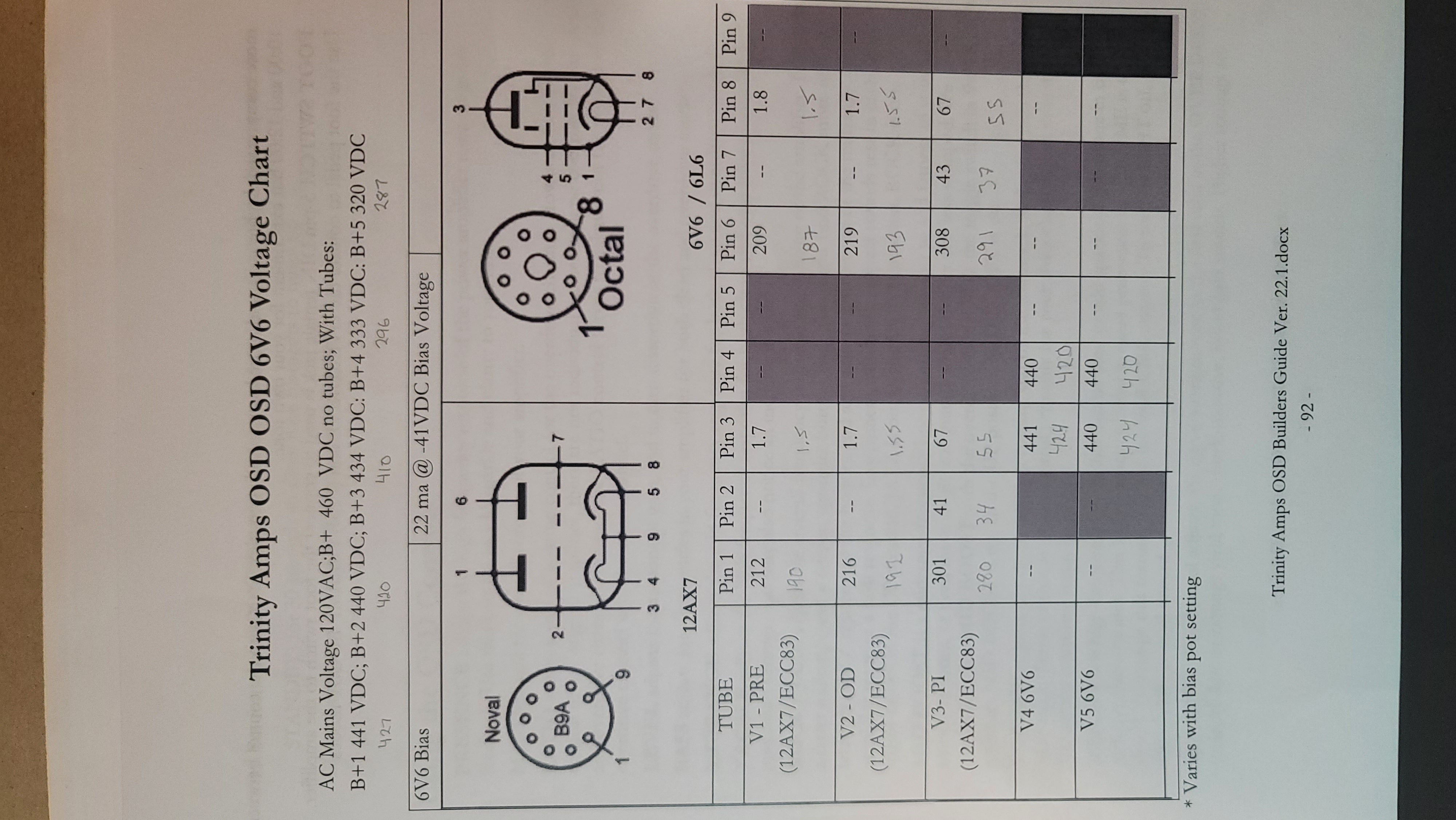

Triple checked all values and connections using DMM and Layout highlighting as I go and no discrepancies found. Did inital power up without tubes and all seemed ok but most of the voltages were al little low approx 10%. Then with tubes in I got that attached readings.
Do these all look close enough? I tried pulling B+ off the buff fx to see if that made a difference and it did not. Thank you all so much in advance for your help and time,

Your build looks great! I’m curious to get your thoughts on the trilator I built mine standard at first and I’ve had good luck with a buffered reverb and delay pedal in the passive loop so I haven’t installed it yet.
My voltages are similar with 6L6s. I found that if I remove the 150K bleed resistor at the end of the power rail I was able to get voltages much more in line with the readings on the schematic. To me the amp is a little cleaner with more headroom and that great sparkling clean tone. I’m considering addIng a choke in place of the 500 ohm resistor, which may also bring up the preamp voltages slightly.

Hi,
