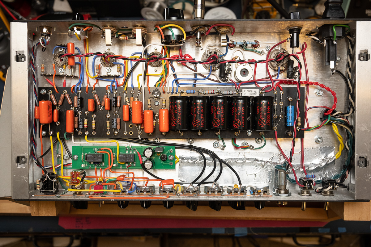

A couple photos of my new OSD build. I have yet to install the Tube FX loop... I thought it would be smart to fire it up and make sure everything worked first. Having done that, I'm still holding off while I get to know it better. It's a real beast!

That wiring looks fantastic. I wish mine was as neat and as well organized as yours.
Be sure to post pics when you decide to add the Tube FX loop.

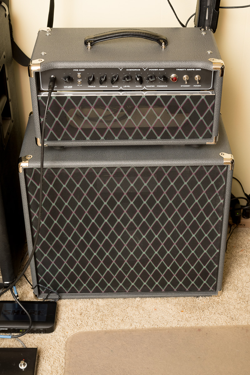

Tell us more about the speaker and cab. From the photo the cab seems a little deeper than most and I can't tell if it is front ported.

The speaker cabinet is the Trinity Amps Sidewinder. It has ports on each side. The speaker is a WGS12L. Great sounding speaker/cabinet combination. I'm very pleased with it!

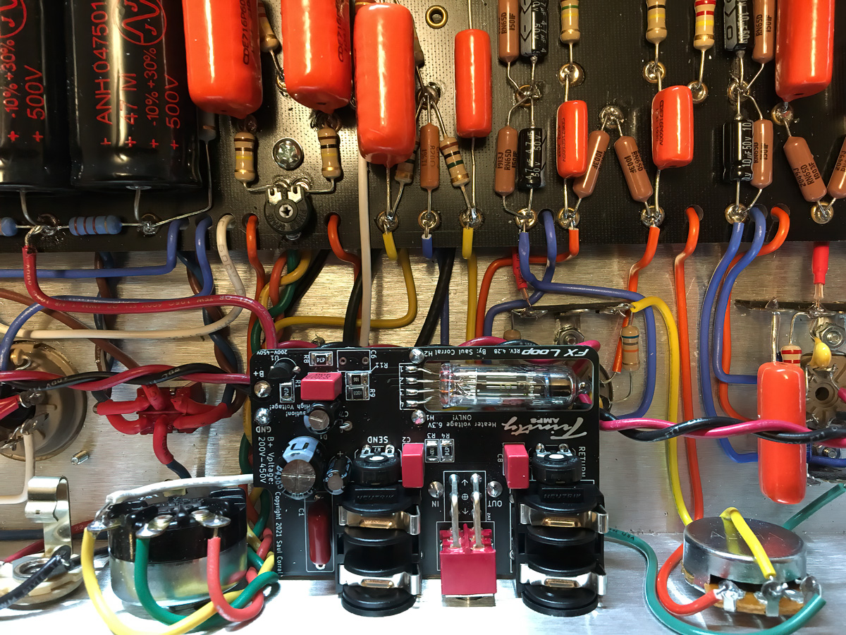

Installed the Tube FX Loop this evening.
