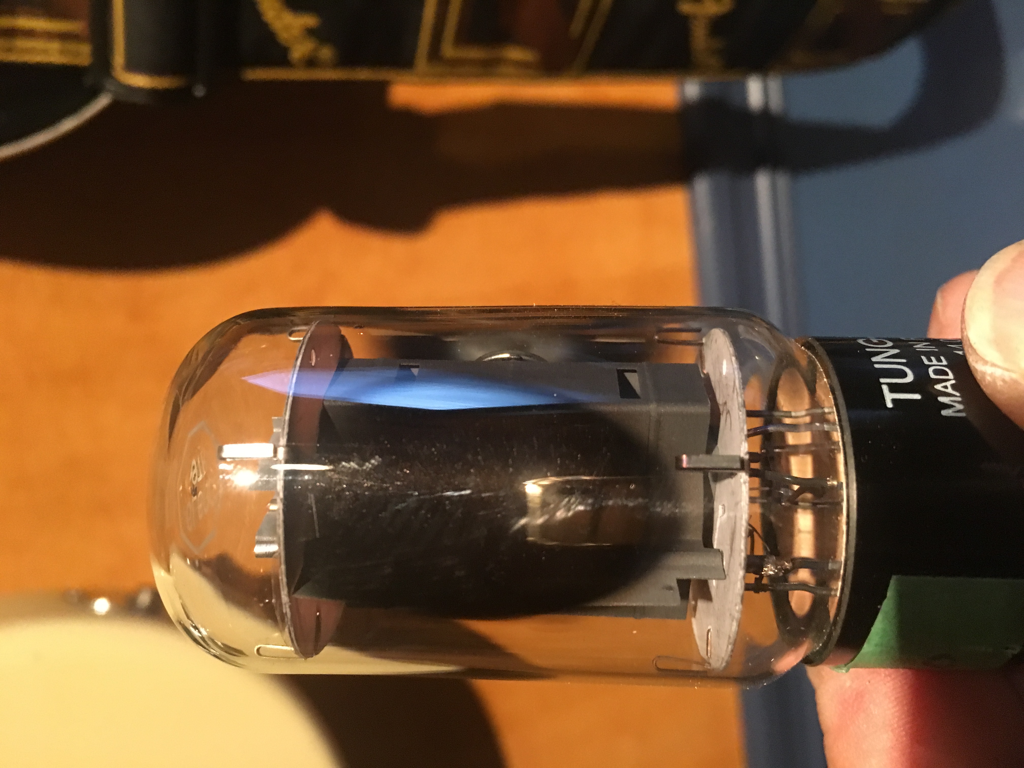

As I said earlier in this post, I ‘m building up my experience with tubes. In that case I like to have yours opinion on this. Is it normal for the 6L6 tube to become that sooty after apr. 8-10 hours playing? Please have look at the picture.
Thanks a lot for replying :D

Before you get too concerned, is it red-plating? Take voltage measurements and calculate the power the tube is dissipating to make sure it's within limits. Use one of the many on-line calculators to test your measurements.

Thanks for your quick replay. I’m not sure I understand the question about the “red plating” What means that? I’ll check the measurements when I get home.
Tlon
PostPosted: Sun Sep 08, 2019 8:31 am
Red plating means that the plates inside the tube get red-hot.

There was no sign of “red plating” in the tubes after two hour of playing. Only the thin wires in the center of the tube was glowing. I did a new measurement, and all the voltages was nearly close to the value written in the first post in this topic. Butt then the “catastrophe” appeared. I slipped on the 4. Lug on the 6L6 socket an made a short connection between lug 4 and lug 3. There was a big sound, and after that the amp become bad. Here is the problem. The volume pot don’t react like it should, loss of volume, and “sparkling” noise, and It will not go to cero. I have changed the power tube, but no reaction. All the voltage measurements is the same as before. Maybe I have blown the output transformer? Please give me some advices for further troubleshooting.
