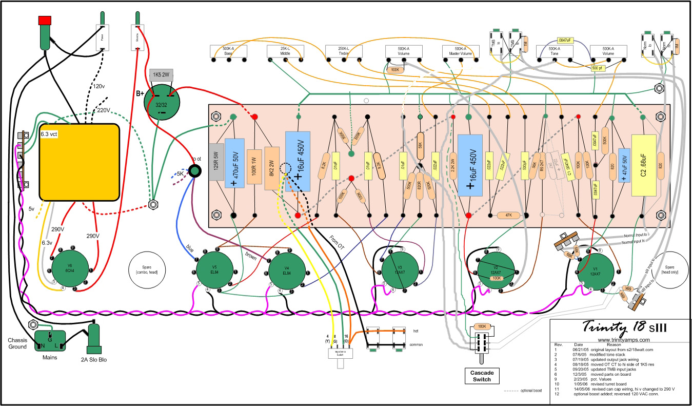

Here is a crude layout. Let me know if it is still not clear.
The green ground wire should run from the switch, under the t-board straight to the ground buss.
Les

Posts: 138
i have an extra tag and screw...could i just ground the switch right there by the tubes without having to go all the way back to the bus?
just want to make it a little easier than monkeying around with the bus again...but if thats the best way...let me knw
Yes, you could get away with that in this case.

Posts: 138
last question...
if i use shielded cable for the 4 wire connections...where do you ground it to? or do you?

Check out this picture
download/file.php?id=755&mode=view
Two of the connections are shielded. The other two are either short enough or not sensitive enough to bother shielding.

Posts: 138
did it last night and played it today...sounds good...not overly sold on it though...i had taken the resistor off of the gain pot...(left it in 'place', taped up so that i could simply put it back on if i wanted, did the same with the wire going to the tone pot that gets changed out for the shielded wire to the switch....taped and secured to another wire so it can't come loose, but is easy to re-attached if i want to go back on the mod)
the only thing i noticed was that the bass sounded fuzzy...kind of like a bass through a fuzz pedal...not bad...but i don't want to mess with the cap's to tighten the bass on the individual channels b/c i'm happy there...we shall see
