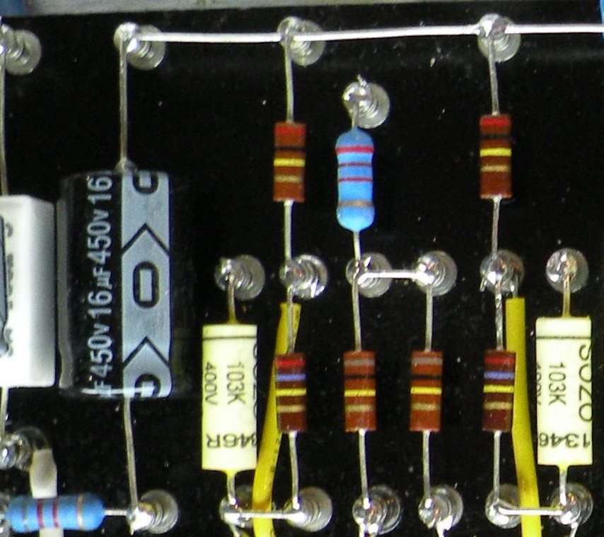

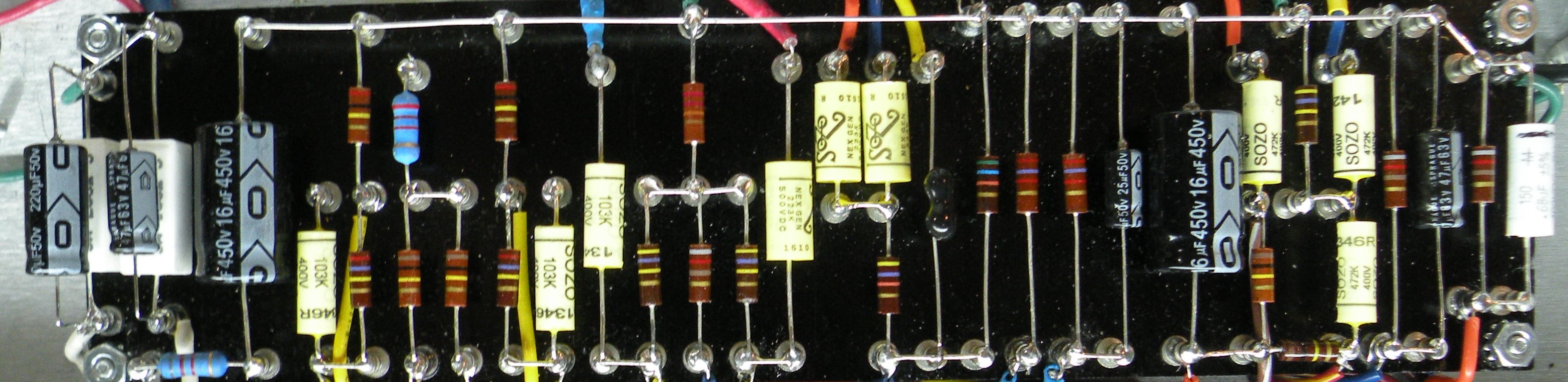

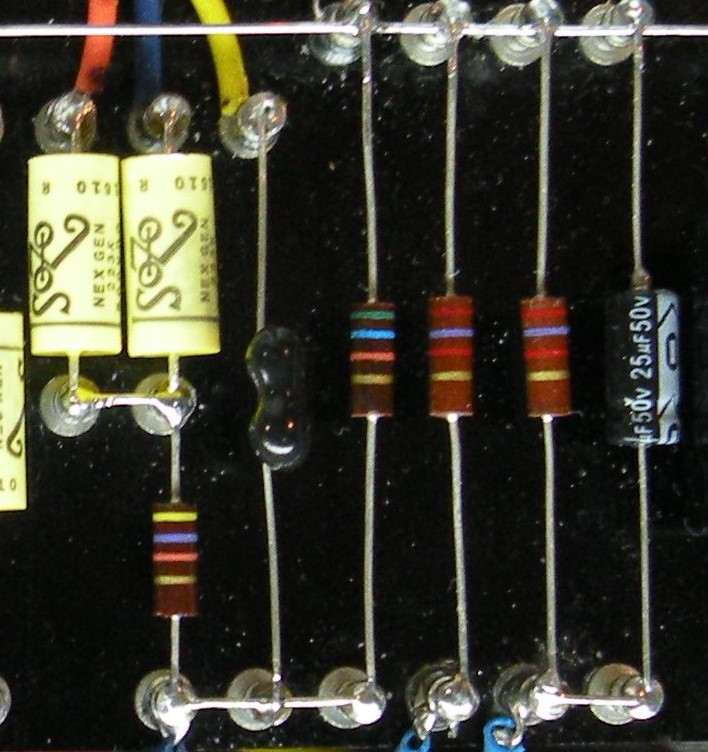

Here is the rest of the Turret Board installation. I already installed the flying leads; so you will see glimpses of them.
Phase inverter components part 1
Phase inverter components part 2
TMB area components
