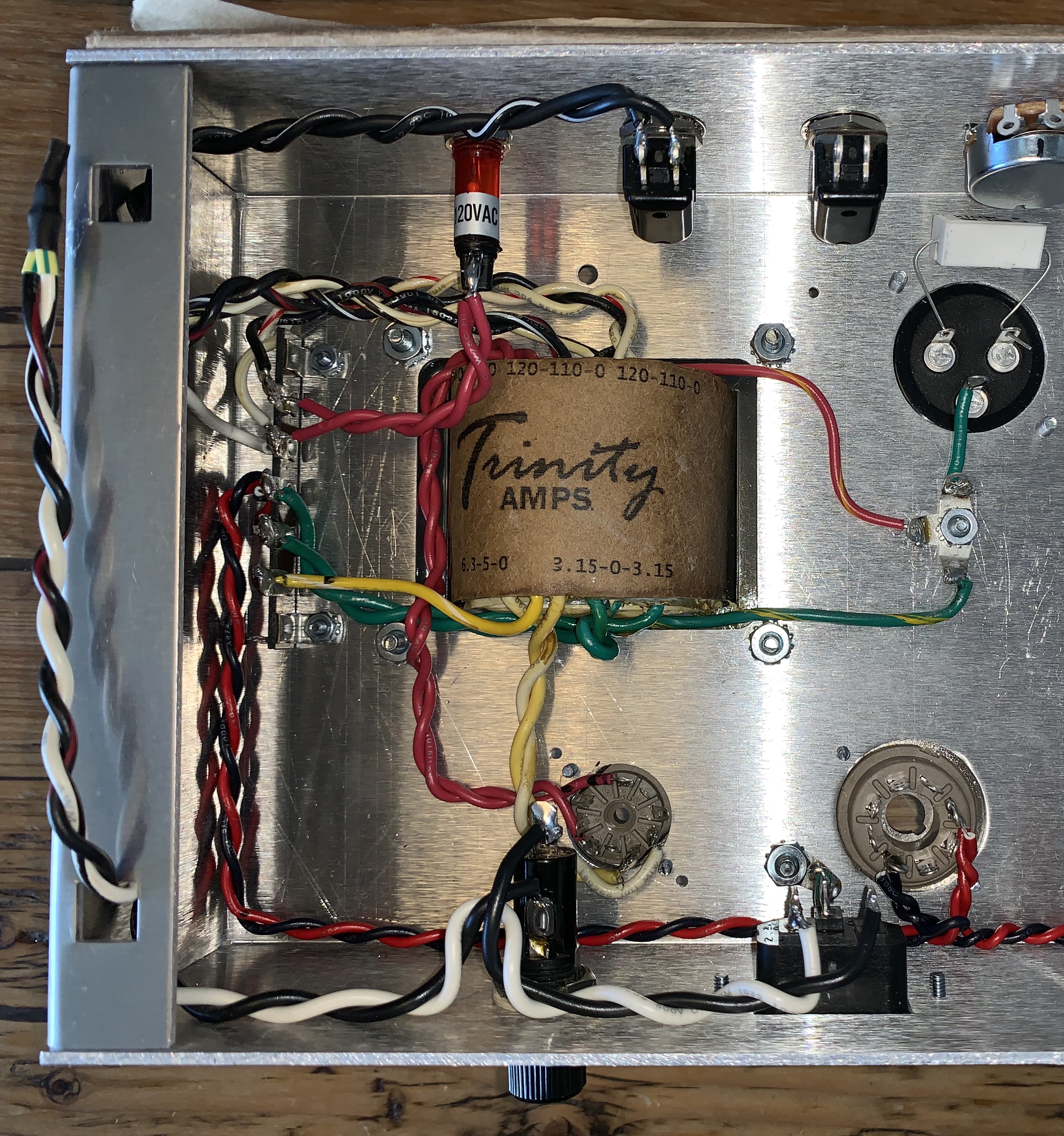

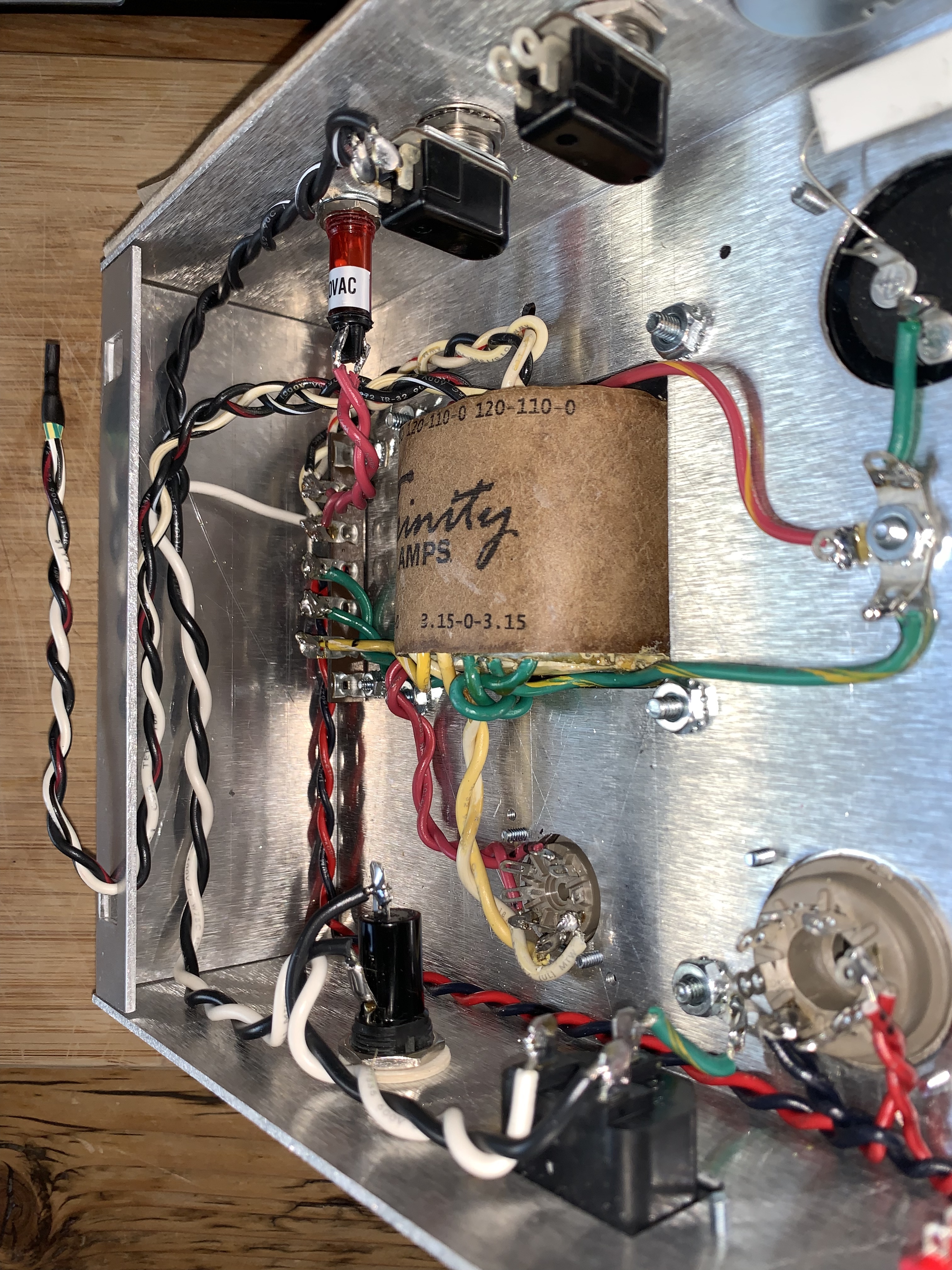

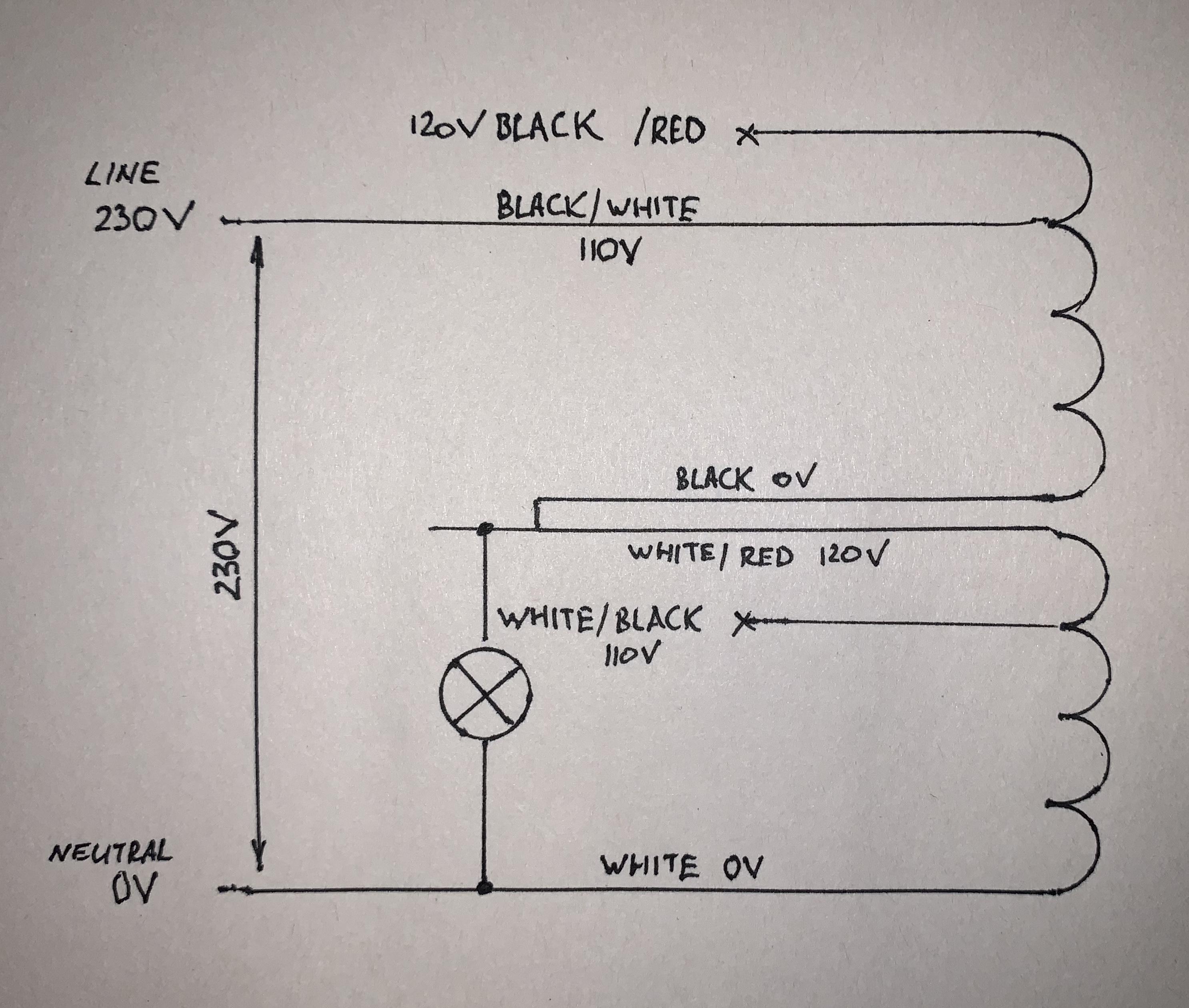

Just finished normally working 230V wiring. Here's my version of routing.
Finish "Wire the Power Supply" section of Builder's Guide Version 3.1. You will have pair of Black and White twisted cables running from Fuse SIDE terminal to Power switch Lug1 (Black) and IEC Connector Neutral 'N' Lug to PT 5 lug terminal strip (White).
230V MAINS WIRING
Follow instructions below and connection diagram (see attachment):
1. Braid White, Black and White/Red PT cables together and run them to PT Terminal strip. This is BRAID1.
2. Braid Black/White, Black/Red and White/Black PT cables together. This is BRAID2, you will use it later.
3. Connect the White PT lead from BRAID1 to No2 terminal strip (strips are counted from Plexi faceplate). This will be the Common or Neutral 'N' tag.
4. Connect the IEC terminal Neutral 'N' to No2 terminal strip.
5. Connect Black and White/Red from BRAID1 to No1 terminal strip.
6. Route BRAID2 to twisted Black and White cables (from Fuse Side and IEC 'N' lugs), unbraid Black/White lead from BRAID2 at place where IEC terminal Neutral 'N' comes of twisted Black and White cables. Twist FUSE SIDE Black cable and Black/White PT lead together and connect them to different lugs of Power Switch (see attached photos).
7. Isolate BRAID2 unused Black/Red and White/Black cables, twist them together and hide inside chassis.
8. Twist any two cables (this can be cut-offs from PT secondaries) and connect each lead to Indicator lamp lugs. Connect these cables to No1 and No2 lugs of PT Terminal Strip.
Finish wiring PT secondaries according to Builder's guide and test the power supply.
