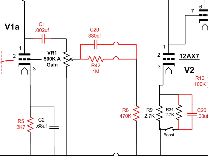

I have started to implement the brown mods with what parts i have so far
1. 100 k cathode res of of v2b and tone slope resister 33k. (I'm digging this so far)
2. coupling cap from v1a went to .0047 (still digging at this point)
3. used your rc network coming off the gain pot. Not the same value cap 620pf (now i find a little more gain) But way too much treb.
Now I went to look at the plexi schematic and I'm thinking you where looking to emulate the turned off normal volume pot that's attached as well to the input of v2. When I look at it should it not be the the 1meg res going to ground and effectively 235k (470k your value) in parallel with the 500pf or in your schematic (330pf)
Others have said that as well. I say yes it is bright but I would not say "too much treble". The one thing I noticed is when the master volume is turned way down, you do not get any low end from the PI or power tubes. In the 1959 circuit there is no master volume and you have a very bright preamp and you get the low end from the power section. At higher gain levels this gives a good balance of tone. Problem with EL84s is that they just do not have enough bottom end. So you will have to compromise and add some low end (or reduce some hi end) in the preamp. One thing to try is leaving off the .68uf on V2A cathode or change to higher value like 25uf.
Well if the normal vol is off then you would be left with just the 470K to ground. So you would have a 470K/470K voltage divider which is what I originally had and will reduce gain by 50%. I then added the 1M/470K to reduce gain even more by 66% with the 330pf over the 1M. If you do it the other way, 470K/1M (1M to ground) you would only get a gain reduction of 33%.
Edit: This was a trick guys would do with Plexis to get a little more gain. If you set the normal volume around 4 or 5 (even though you were not plugged in) you would effectivly have 470K/720K or 470K/960K which would then only reduce gain by 25-30% instead of 50%.

sazafraz wrote:
Your trying to reduce 66% gain at this point?
Yes. I was getting fizziness and was thinking it was too much gain so in an attempt to reduce gain I made the voltage divider before V2 1M/330pf/470K. It did help reduce gain a little but now, after this discussion, I realize that I was reducing gain to the frequencies below whatever cutoff the 330pf was providing and leaving nothing but higher frequencies. That would explain the "too much treble" you and others are getting. Going with the stock values of 470K/500pf/470K should help as it will not reduce as much low frequencies. Maybe kurtlives or zaphod can help us understand what frequencies the cutoff is and how much they are cut in DB i.e. -3db or -6db etc.
sazafraz wrote:
Going back to the plexi circuit
On the wiper of the normal channel you have 470k plus where ever the pot is set with (the) trick ~470k ish + some effect so say or 720-960 range too me is close enough to the 1meg going to ground.
Off the wiper of the bright channel you have 470k with 500pf bypass cap
So the way I understand it, and I am still learning here, the 470K/470K divider will reduce the voltage by .5 or 50% using the formula R2/(R1+R2) for the frequencies below the cutoff off the 500pf cap. If you have 470K/960K (470K + close to half the normal vol pot value) you will get .67 or 33% reduction. You will have less reduction in those frequencies below the cutoff of the cap and therefore more signal is entering V2. Now if the normal vol was all the way up you would have effectively 470K/1470K (or 1.47M) and you would get .75 or 25% reduction. So even more signal in those frequencies are getting through.
So back to you're original question of should the 1M resistor be the one going to ground, if you want more of the frequencies below the cutoff of the cap (330pf or 500pf) then you could go with 470K/1M (1M to ground, cap over the 470K). 1M would increase those freqs by 18%. 1.2M would increase by 21%.
Like I said before the stock values of 470K/500pf/470K should be a good starting point then you can tweak to taste from there. But keep in mind that part of the "woody" plexi tone comes from reducing bass freqs in the preamp and bringing them back in the poweramp. IMHO. Though I think I may have reduced too much bass before. Now I went back to the stock values but my ears were hearing too much bass (or lower mids). So today I just went back to 470K/330pf/470K. I will play with that for a few days and see what my ears tell me.
Les

sazafraz wrote:
I under stand that this is a bright amp to start with. But that was brighter than it needed IMO
Now that I understand my mistake with the 1M in the voltage divider I would agree that it was too bright and I apologize to anyone that I have said it's not too bright. :oops: And my ears must have been telling me that before because I did go back to stock values.

Stephen, if you are following we should correct this in the Plexi Brown docs.
I am following this. But let's just clarify the change being suggested.
 Post subject: Re: Plexi Brown Mods
PostPosted: Wed Sep 19, 2012 10:20 am
Posts: 226
Location: Dallas, Tx
Change R42 from 1M back to 470K. The 1M is actually attenuating too much bass.

Hey Lindsay, was wondering if you would chime in. I still would like to hear some clips of your amp. I tried the Ruby mod but it did not work. I may need to try lower values zener like you did.
I have been wanting to get more bottom end out of the power section and came across a "FAT STACK" output transformer. Says it really adds tight bass and bottom end. I would like to know how it sounds. The other thing about the Fat Stack is that all the descriptions and feedback from people say that it does not have the "fizzie" sound of a typical 18 watts. I read something else that someone replaced their OT with a "beefier" OT to get rid of the "fizzies". I wonder if the fizz is just in how the 18 watt OT is designed when pushed hard and all these other "fixes" are just bandaids to compensate.
Lindz wrote:
Dumb q - looking at the brown schem in the resources section I do not see r42 unless I am blind? I too agree that the amps are a little bright and thought I would make this change
R42 is the mix resistor coming off of VR1. Should be 470K not 1M.
