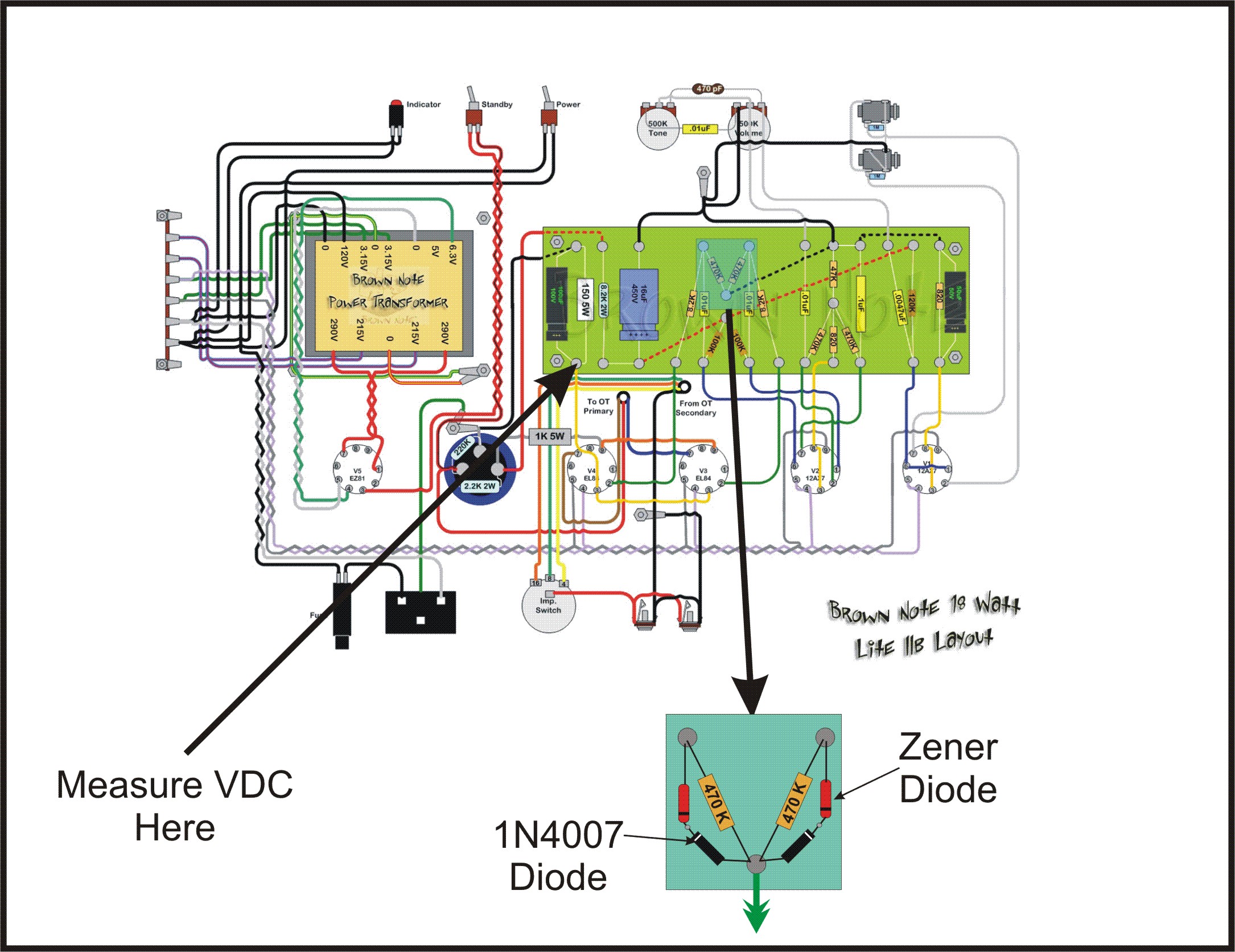

I have the 1n4007 diodes and zeners installed as per the attached image though the zeners in my amp are 3v/5w - I also have 220k not 470k resistors as pictured
Here is an exerpt from my thread at Ampgarage that should give people an idea of where I was going with this
Katopan - my question about the Ruby mod is more related to my general lack of understanding of the finer nuances of tube circuits in general - not so much the crossover distortion concept in Paul's article but more that I was going so far below what he proposed for zener values and was not really sure what I was doing by taking it to that extreme
your last few posts in this thread are helping it all gel for me
Gary, essentially I started experimenting with smaller zeners that were tighter in value to those Paul Ruby proposed to kill crossover distortion because I was unable to scale my vvr down without crossover distortion appearing
He suggested 1 - 2 volts higher than grid cutoff voltage, and most threads I have seen where people have implemented Ruby clamps used the cathode bias voltage at idle to set this value - On my amp I had 15v zeners in the ruby clamp that worked ok at 100% power but the distortion reared its ugly head pretty quickly when I scaled down the amp
When I started trying the lower value zeners I noticed on my amp a correlation between the bias voltage and zener value in the Ruby clamp where if the zeners were 10v, I could dial down my vvr to where the bias voltage at idle was -11v and not hear the crossover distortion that is otherwise prevalent in my amps without the Ruby clamp - a 1 volt difference (ignoring the negative).
9volt zeners, I could scale the amp down to -10 volt bias at idle with no crossover distortion - this correlation continued as I went lower in zener values
If I scaled the amp below the correlated zener value, I started to get crossover distortion progressively worse as I went lower
I tried a few lower values until I tried 3volt zeners the other day at which time I could dial my vvr down as far as it goes on my fixed bias amp
I tried 5v zeners on another cathode biased amp that was buzzy without a Ruby clamp and it also seems to work pretty well all the way down
I have not tried the 5v zeners on the fixed bias amp nor did I have every value zener under the sun to try - I just had a few random voltage zeners going down from 16v (which is 2 volts higher than my idle bias voltage of -14v with the amp at 100% b+ voltage on the vvr - again ignoring the negative) and found that a low value zener seems to solve the scaling issue

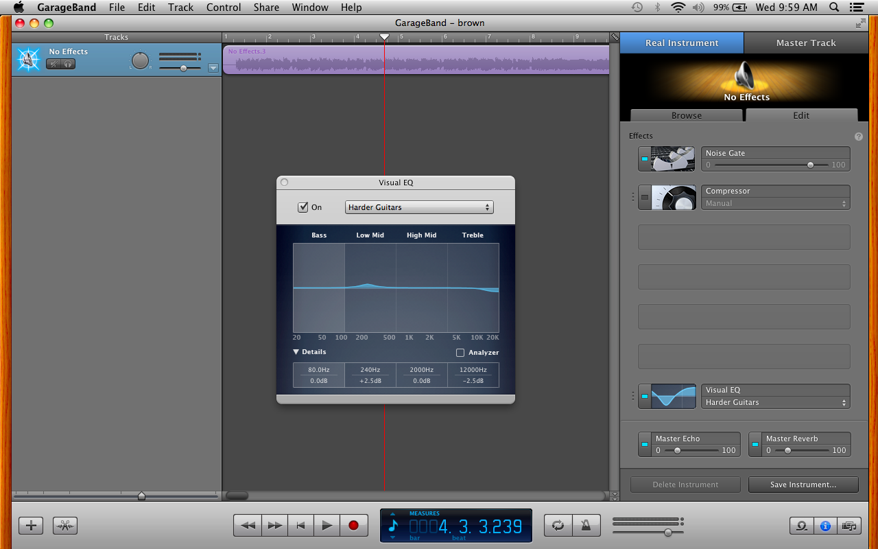

Ok Since I have a working amp again I will post a clip of a brown mod. Although I have not got the unimind's gift of playing VH riffs here go's
I tried the up close and personal sm 57 but could not get to sound like I hear it, in an open room but I know the mic eq thing was a major part of what was originally done in the studio.
So I opted to an apex 420 (clone of neuman) as close as I could get to the cab without it clipping ( about six feet)
settings where as follows with boost on
VRM was as far down as I could get it without it getting too funky
Cab was a 2x12 closed with late 70's black backs 55hz cones
This is what I did in GB only master effects where the echo and reverb master
and the clip
http://soundclick.com/share.cfm?id=11961921
Now if I could just get the pictures to show where I want them too :damntech:

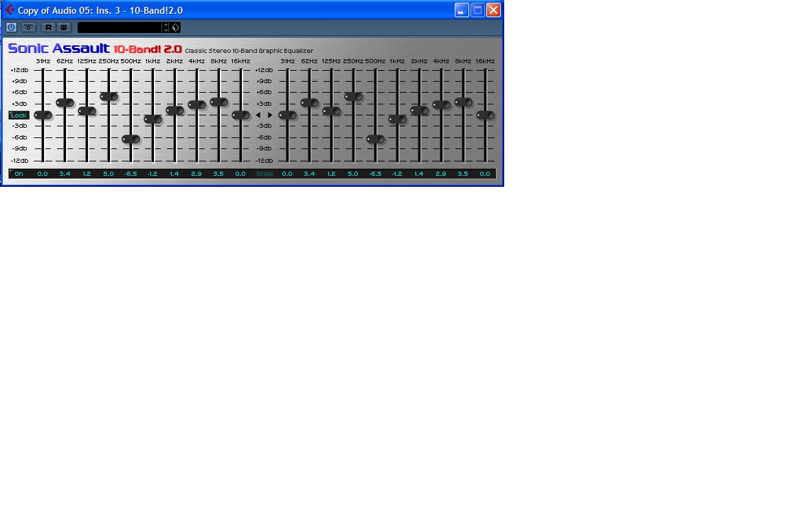

Sounds really good. I like the way those blackbacks sound. How are you liking the mods? What guitar/pickups are you using? How does it sound with the settings dimed? (except the master. with the vrm down you want to keep the master down as well)
If you have a 10 band EQ in GB try these settings for VH1 tones.
Tweak to taste. My pickup has a lot of midrange so I cut the 500Hz a little more. Tweak the upper frquencies to taste.
I Like the mods but I have mostly just done the preamp side of things (a little different than your's) and one change in the power amp an no PI changes yet.
The guitar is a 91 LP STD original pickups, some upgrades in the bridge tail piece and caps.
Cranking every thing is a little different and in the case of the master I still need it up as its an integral part of the way it sounds. Turning the vrm down changes the tone and you need to ajust for that. I did not install ppimv or a fixed bias and have no plans too. The one change I did make from yours as well is I went with a 1meg gain pot.
I got closer to your eq settings when i was playing around with a close mic'd 57 (trying to make it sound like what I hear coming out of the cab). But using a Condenser 6 feet away got me there a whole a lot closer ,quicker. I ll play with the your eq settings next time I mic it with a 57 up close .
Yeah. I need to get a condenser. The 57 up close gives it a lot of bite but not exactly what it sounds like in the room. Having the condenser gives it more depth. Most studios will blend the two for the best sound with bite and depth. Your amp sounds great, especially with the blackbacks. I would like to hear more clips with a touch more gain. 8)
