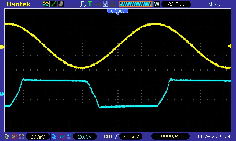

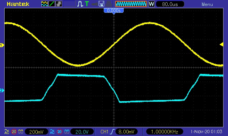

I implemented the Ruby mod, which nearly removed all of the crossover distortion. Because the highest cathode voltage I had recorded was about 25.5 VDC, I went with a 3 diode array: 20V and 6.5V zener in series (both 5 Watt) and back to back with a 1n4007. That was connected in parallel with each 220K grid leak resistor with the 1n4007 side going to ground. Some pics of both channels on my scope. This was the most prevalent I could make the crossover distortion with a SS rectifier. It is even less apparent with the 5AR4. Sounds much better now.

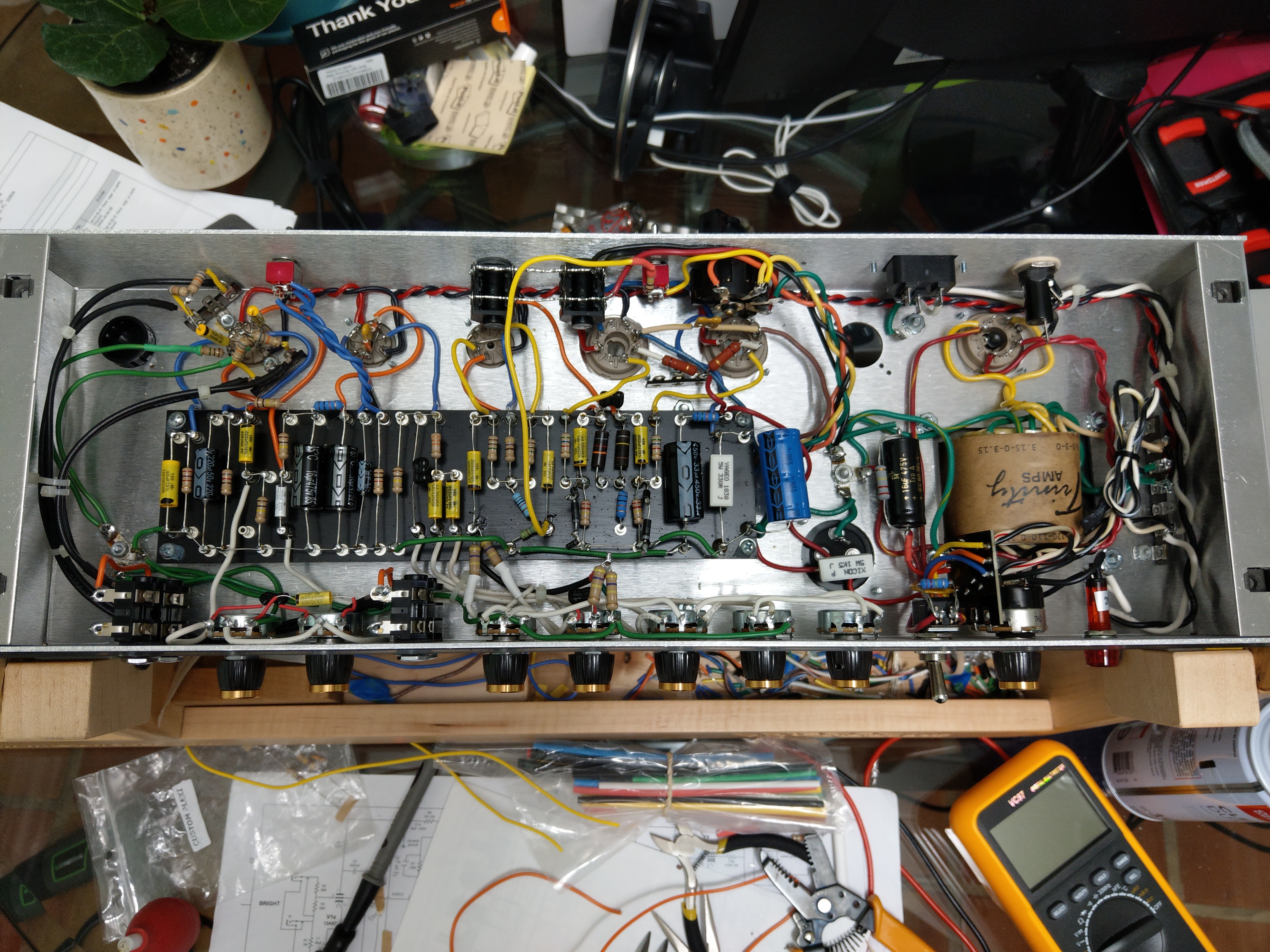

Quick update, I spent some time working on the amp today and I am very satisfied with the results. I know the guts are a bit sloppy since I have chopsticked around so much and done many rounds of mods, but all of the connections are solid and sound is great.
I started out chopsticking. Was able to determine all of the instability in the amp was due to a micorphonic tube in V1. It seemed good back when I was rolling tubes, so I guess it must have been a little microphonic and got worse as I played the amp and it got rattled around. It was a new Mullard long plate. Now I have an EHX 7025 there. All good and not running off into feedback at the drop of a hat.
I alligator clipped in a couple small snubber caps across the plate resistor for the second gain stage. Settled on 470p and soldered it in. This really helped calm the ice pick harmonics of this amp.

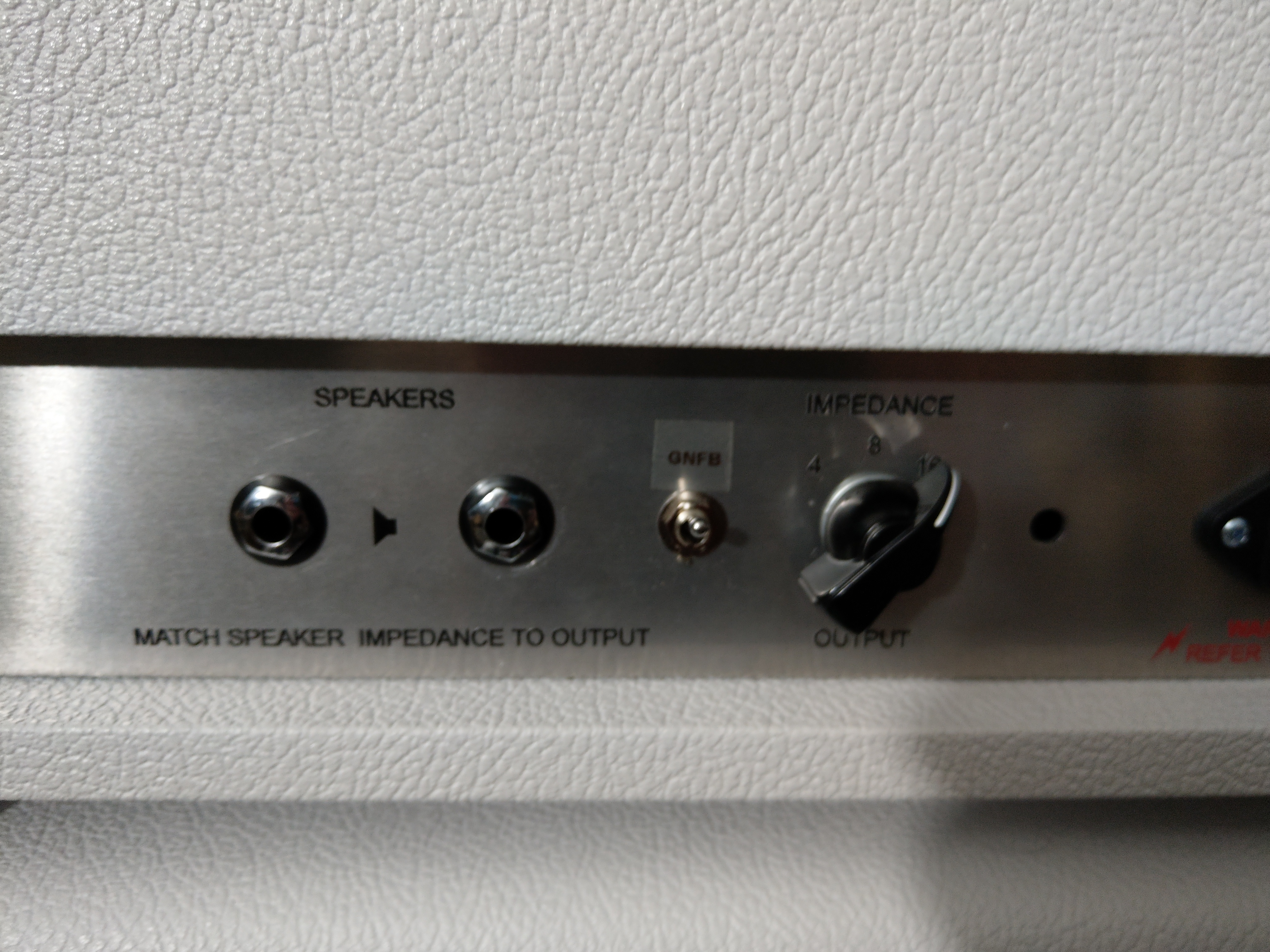

Then, I made all of the several changes necessary to add Global Negative Feedback on a switch...PI plates, feedback resistor, changes to long tail pair part of PI, moving where the channels meet the PI and adding mixing resistors. I fired up the amp and it wasn't howling but was definitely out of phase and unstable. Switched the OT leads and all good.
This sounds like a big box Marshall to me! Nice and tight even with lots of gain. Now that I have the fat boost and GNFB switches there is a lot of variation that can be dialed in with those and different amounts of gain. Still cleans up incredibly well with the volume knob on a guitar. I am calling this one complete. If there is anything I might have done different, it would be going with a 220p or 330p snubber since the GNFB kills some high end too. But the difference is not worth opening her back up for that one cap.
-Dan
