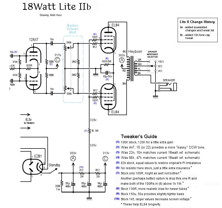

Can someone walk me through the connections for this, I looked at the Ken fisher pages but am unsure which cap/resistor junction he shows there....Thanks.

Have a look at this and see if you need any further help

That post-PI MV works better than Ken Fischer's one. When turned all the way up, it is exactly the same as a stock 18W with no MV.
Note, the 2.2M resistors need to be low noise metal film, rated at 1W or above.
