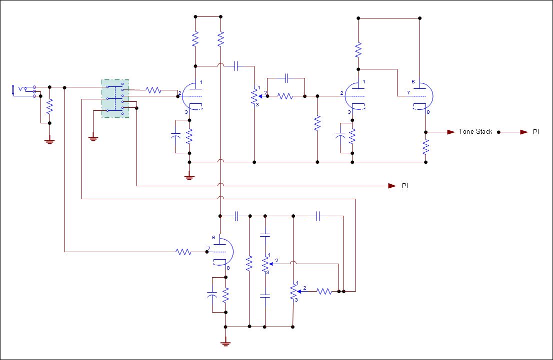

In the Plexi-Brown-Mods thread, the discussions on cascading the channels got the gears grinding. The concept here is based on the PlexiBrown design, but with a single input & two switched topographies. One has the two channels bridged, the other cascades the Normal channel into the TMB channel. Would this work?

So you just have a single input and are looking to switch between stock 18 watt and cascade normal ch to TMB ch?
i.e. Stock would be one input to both ch and each ch to each side of the PI.
Cascade would be input to normal ch to TMB to PI and ground the other side of PI.
I think Coco's version of BrownMods is what you want just you will have a single input feeding both ch.

That's funny! Turn the switch around 180 degrees & you need 1 less pole to do the same thing. Perspective is everything.....
Perzackly what I was going for & what was tripping me up. Thanks for the link.........somehow I missed that schematic.
