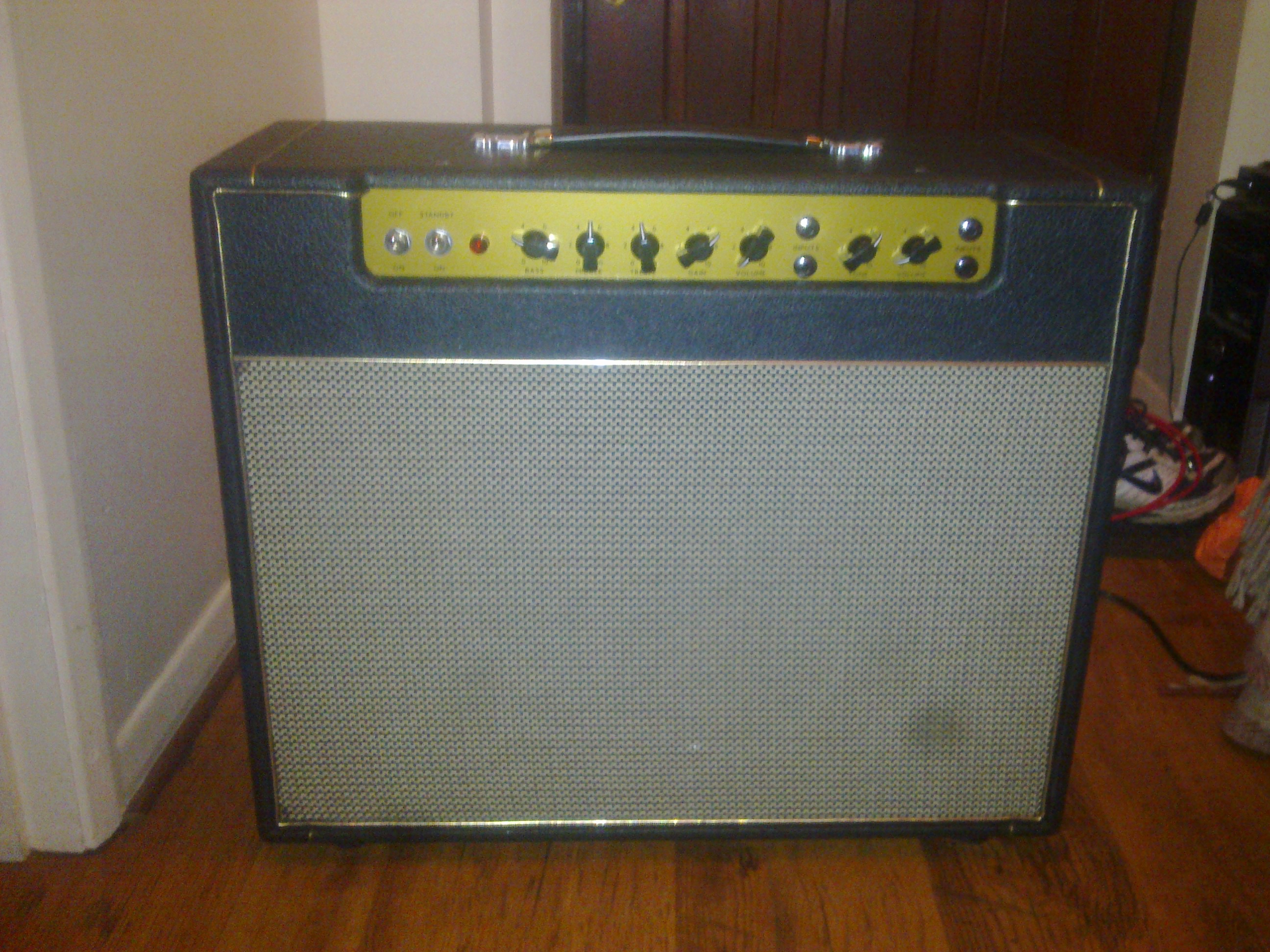

I've done a trinity layouy plexi with controls at the front, my son found the vvr at the bottom
on the rear a pain.
I've got to straighten the salt and pepper cloth but otherwise looks good to me.
243 mains
347 b+
V1
Pin1 142
pin3 .84
pin6 135
pin8 .93
V2
pin1 174
pin3 1.39
pin6 252
pin8 173
V3
pin1 190
pin2 53
pin3 80
pin6 193
pin7 52
pin8 80
V4
pin3 10.8
pin7 337
pin9 321
V5
pin3 10.86
pin7 338
pin9 321
V6
pin1 298
pin3 344
pin7 298

This amp sounds really good but my voltages seem a little low compared to yours is
there any reason to be concerned and are there any other checks i should do.
I've used the same value resistors and caps with a mixture of carbon film and
carbon comp to see if there is any real difference.
I checked with my original kit and the voltages are similar, i've been using that for well over
a year now with a vvr in it with no problems yet.
PostPosted: Wed Jun 29, 2011 7:14 pm
Voltages vary all over the place with different tubes, mains voltages etc. It is not precise like solid state stuff. My ROT (Rule Of Thumb), is if it sounds good, it is good! Enjoy it.
PostPosted: Thu Jun 30, 2011 1:14 pm
Joined: Tue Jun 02, 2009 4:51 pm
Posts: 56
Location: uk
Thanks so much, you guys are great btw.
This is the third one i've built and this the best sounding according to my son, it seems
to have more gain for some reason.
What was interseting is the combo box i built originally was slightly smaller and had
a fixed 18mm baffle,it sounded good until i plugged the amp in my bluesbreaker box
and the sounded superb up to GNR tones, so scrap box and build the one in the picture.
Stuff you do for tone and kids.
