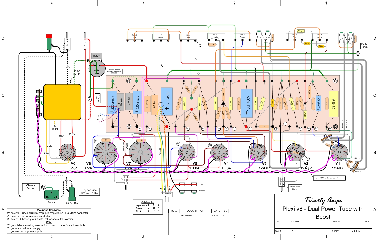

Worked on all the lead wires from the board today.
1) The layout shows gray wire (no gray in the kit, but that's not the issue) going to pin 4 of v7 and v8, the 6V6 tubes. In the sIII v6 build photo, it looks like nothing goes to those pins, so I was a little concerned. Is this correct?
2) On the same topic, it appears that three wires should go to pin 4 of v7: one from pin 4 of v8, one from the 100R 1 watt resistor on the board, and one from pin 8 of v5 (which continues on to connect to pin 8 of v4 as well. Is this so? Seems strange that such a big bunch of wires wouldn't show up on the pics. I can see the resistors across pin 5 and 6 of the 6V6 and I can see the heater wires on pins 2 and 7. But it's weird I can't see three wires going to pin 4. Am I missing something obvious?

1. The gray wire goes to pin 4 on V7 and V6 and pin 9 on V5 and V4.
2. Post pics so we have reference. Follow the layout and your fine.

1) First off, you say v6 and v7, but I wrote v7 and v8. I'm guessing that boils down to the layout being weird in that the tube numbers don't go up right to left (rectifier shows up as v6 even though it's at the end and most people would think of it as v8). Bottom line, I hope we are both talking about the 6V6 power tubes. Secondly, I'll have to double check the layout when I get home tonight with regard to v4 and v5. I thought the layout showed pin 8, but you typed pin 9. Definitely need to double-check that.

Ya I was just going off the first v6 layout in the Resource section that has no numbers.
It's pin 9.

Thanks. I'll definitely check that at home tonight. I initially made this question thread last night well after midnight. My mind may have been fried after a full day of work, then the kids, then soldering after they were in bed. Yikes. The alarm coming around again at 6:30 was rough! :shock:

Ah, I see what I did.
First, I used the second one that has tube numbers, FWIW. But the goofy part is that I probably need to look closer. Those are nine pin tubes. I just read them as 8 pin and assumed the last pin was 8. Duh! :oops: The one next to "8" is also 8. That would make it 9. 1 2 3 4 5 6 7 8 8 just doesn't make sense!!! :D
My mistake. :oops:
