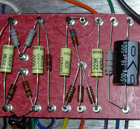

Here is how I did mine. http://www.unimind.us/images/Trinity18_ ... ematic.jpg Just ignore the cascade switch and the presence control. Make sure and ground the unused side of the PI (C7). See picture below:
Les

It was your layout that got me thinking if i mount the 470k's with a 500pf on one of them
at pin2 v2,then get rid of the tone control.
