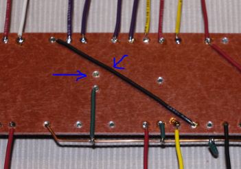

PostPosted: Mon Sep 05, 2011 4:47 pm
Posts: 126
In the pic of the back of the board (at the bottom), the dark wire running diagonally needs to also connect to the turret it passes in the middle of the board.

Oh man!!! Thanks for catching that. Can I fix it by running a wire across the top? Or do I have to connect it from the bottom?
Rich
PostPosted: Mon Sep 05, 2011 9:27 pm
Rich
Top is fine!
