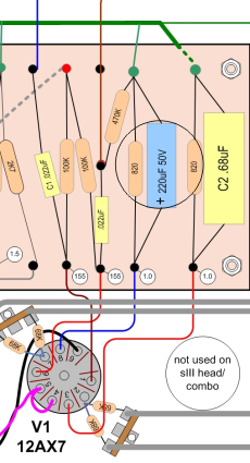

Can I use 16v cap here?

Yes, cathode voltage is only 1 V or so.
