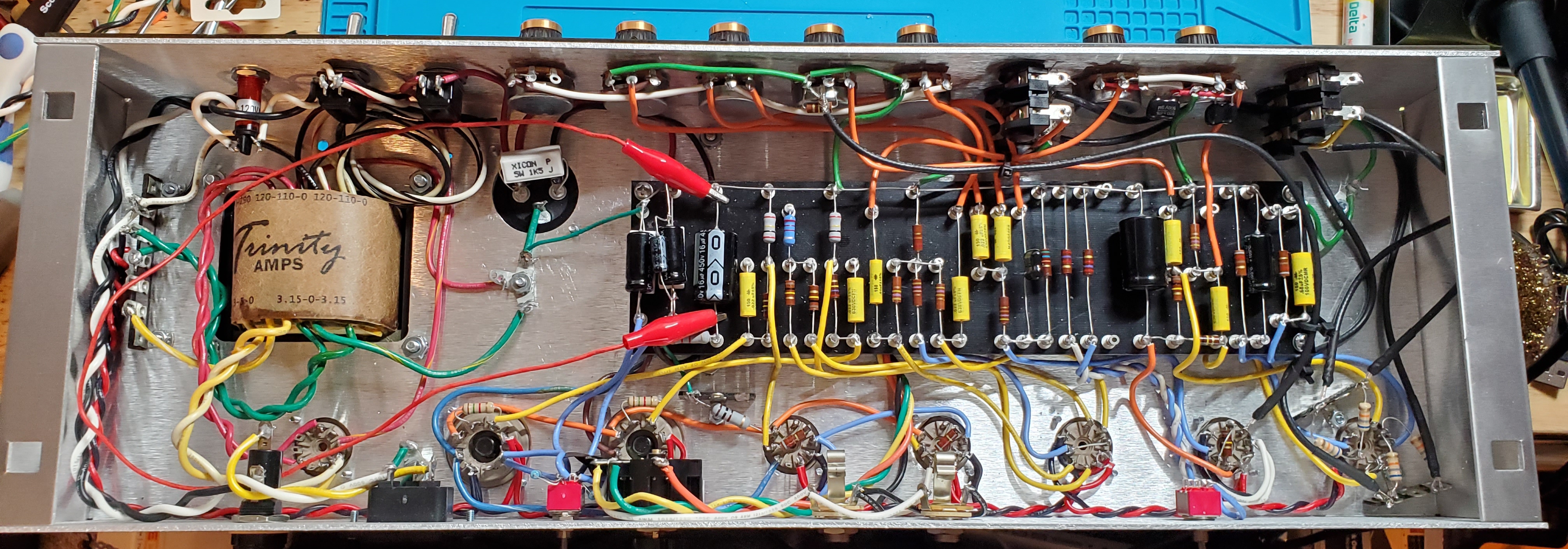

It might help if you post a few pictures of the chassis and the wiring.

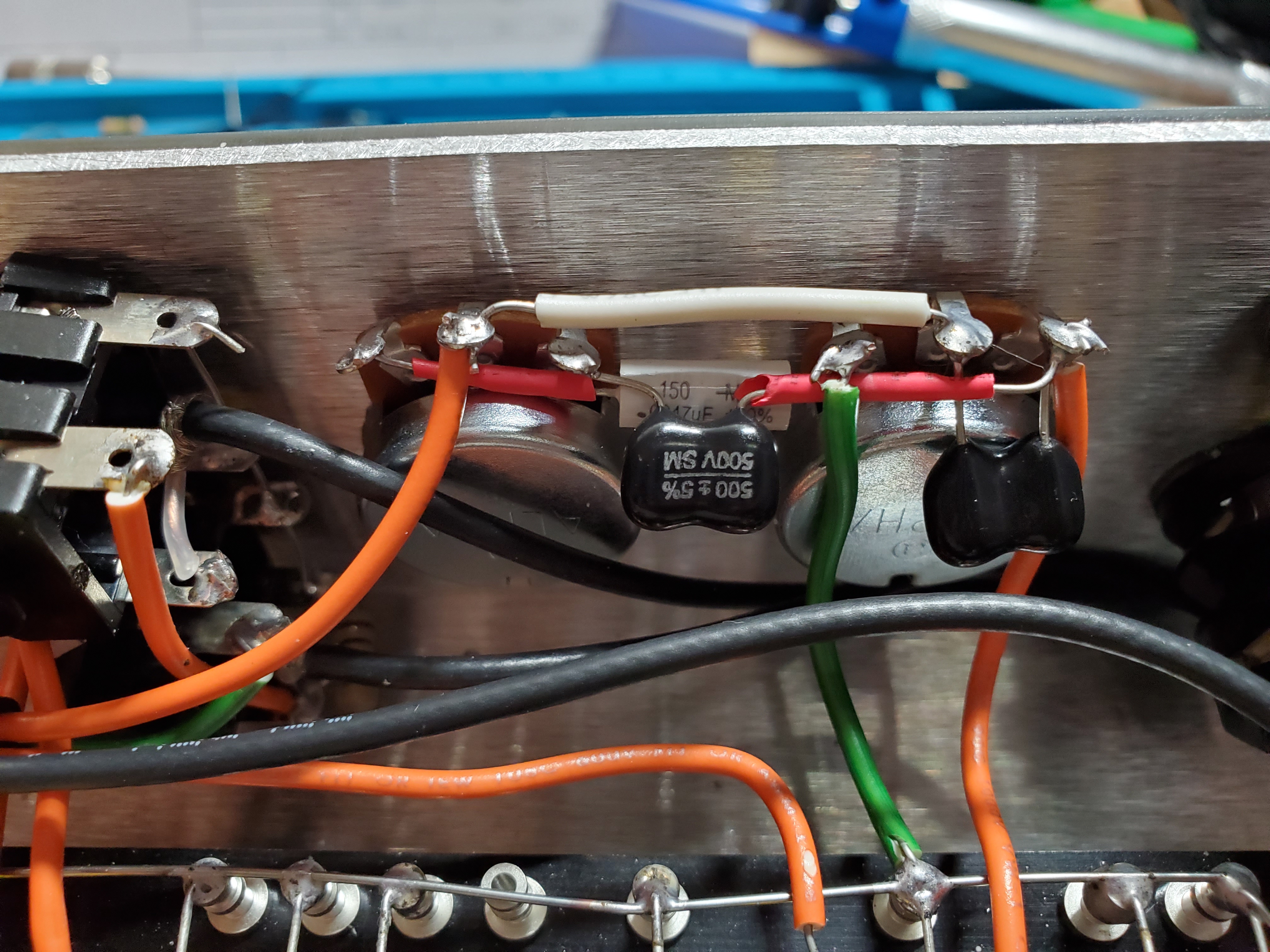

Here are two pictures of the amp.
The closeup pic is of the normal side. The red is some heatshrink helping protect the capacitors. The right capacitor looks like it's touching but it's actually lifted up and out away a bit.

Check the layout on the 500 pf cap(s) connection, they look wrong compared to the layout?? To me anyway, but then I'm looking at a pic and comparing it to a drawing :bugeye:
PostPosted: Sun Mar 15, 2020 11:20 pm
Oops, I'm wrong. But there seems to be a thin wire running between the center and right side lug on the volume control in you closeup shot of two pots, you can see it when you click on the picture and enlarge it. Maybe?
EDIT: Thought it might be shorting something. And listen to Mitch, he has lots of knowledge :thumbsup: Also, post the solution :!:

I went back and looked closer at the pots and blew some air on them and it moved. Most likely a small hair or something since it's not on there anymore like the pic now

I was wondering about that object between the terminals on the volume control, too. Sounds like that wasn't the problem, though.
The wiring looks correct. And you say you checked the pot itself and it's good. Can you see the resistance changing if you measure between the center terminal and each of the outer terminals as you rotate the shaft? And you see about 500k measuring across the two outer terminals? You might have to disconnect the wires and capacitors from the pot to get a true reading.

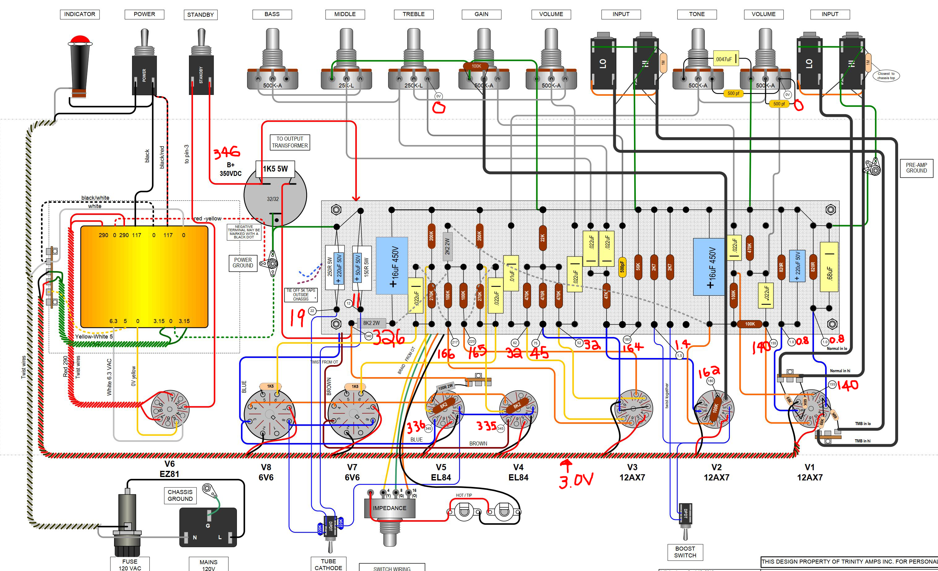

I took volt measurements from places where they were given on the diagram.
Maybe this can help solve the problem?
The area around V3 seems a bit wonky and I'm not sure why.

PostPosted: Mon Mar 16, 2020 7:06 pm
Does the 8.2k resistor at the lower left of the board measure OK, and does it have good connections to the turrets and the two 100k resistors and the 2,2k resistor it feeds?
Also try swapping in a different 12AX7 for V3 and see if that makes any difference in your voltage measurements.
V3 being wonky would affect both channels, though.
PostPosted: Mon Mar 16, 2020 7:23 pm
+/- 10 to 20% on voltages should be OK. Any thing higher/ lower than that seems worth a look at, though. Voltages on grid, plate and cathode pins for V3 seem pretty low. Might need to reflow the solder at those turrets. Hopefully Mitch will chime in, as I said, he's got "the Knowledge".

Ok, I swapped V3 tube for another. Similar voltage readings. 8k2 resistor measures 326V where it connects on the left. I reflowed the two spots where it has the jumper just in case. It seems like the normal tone knob kinda works now where I think I hear a difference spinning it but now volume drops out sometimes for a split second. But only the normal channel.
I guess time to double check and reflow the normal channel input/preamp side?
But would that still be the reason behind the low voltage issues near V3?

The voltages at V2 and V1 aren't bad so the connections and resistors in the B+ chain seem to be OK. V3 is low, though. Not low enough to keep it from working, but it would be good to see if we can get it higher. We know it's not the tube itself causing it, so check the connections to the two 100k resistors feeding V3's anodes, as well as the 470R and 22k going from the cathodes to ground. Check the connections at the tube socket, too.
As I said earlier, if something isn't right with V3 it would affect both channels, so I think the tone control not working on the Normal channel is a separate problem.

I've managed to get the 100k resistors feeding V3's anodes to 180V. Which is right about at that 20% margin of error if following the schematic's 220V measurement. Still working through the board and reflowing some spots hoping I can raise the cathode side voltages.

Just a thought triggered by Saz's post. Is it possible where the first 500pf cap's left lead crosses the second one's lead, behind the Volume pot, you melted though the heat shrink insulation and they're touching? Just spitballing here.

Hankules, I did a closer inspection on that heat shrink area and after some partial rebuilding on the pots, the tone knob works now! I think it was something to do with the heat shrink failing on me!
The V3 area is still too low than it should be despite the tone knob fix. If the amp seems like it's working, is there a hazard to not correcting that V3 area?
