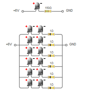

Check out http://ledcalculator.net/. You can design your circuit and will look something like below. First one is for a single blue LED. Second is for 12 blue LEDs. I am still planning on doing this to my amp as well. Just haven't got around to it yet.
