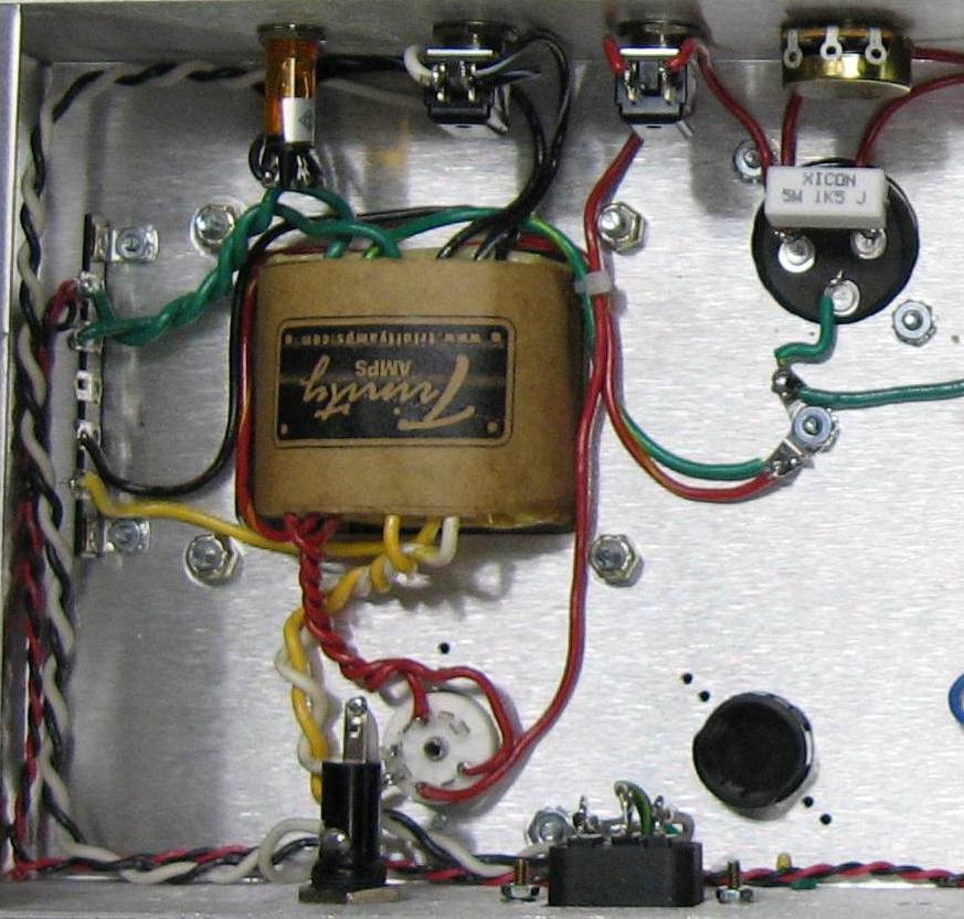

PostPosted: Tue Jul 10, 2012 10:40 am
We corrected the posted layout in the Resources Section. thanks for pointing that out.
See also viewtopic.php?f=12&t=3029
Manual updated with this picture as well.

Awesome! Thanks for the update and the detail pic.
