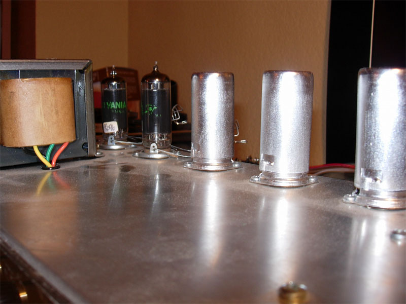

Here are some shots of the 6CM6s. They are not much bigger than the 12AX7s.
