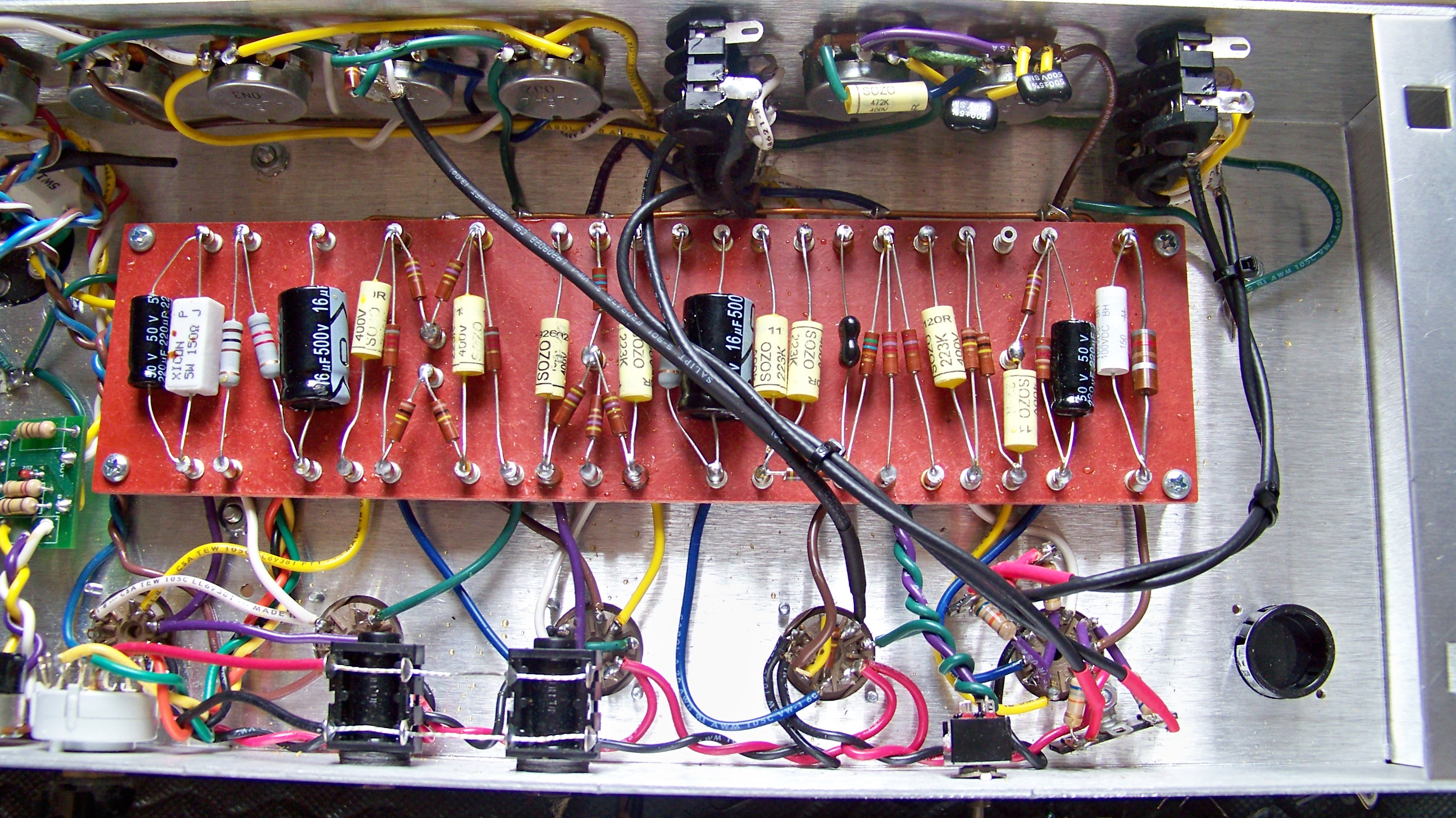

PostPosted: Tue Aug 28, 2012 2:03 pm
Joined: Tue Jan 17, 2012 11:59 am
Posts: 29
Before you go making changes to the signal path I’d sort out your VRM issue first.
With a properly installed VRM it will be better than a PPIMV and attenuator hands down.
First I’d confirm all your wiring is correct, reflow your joints, verify component values. Next I would turn the amp on and measure the scaled B+ as your turn the pot from min to max. Make sure the control is working and voltage is actually increasing/decreasing.
Pics of your amp and the VRM specifically would help.
Ok I have got an L-pad Attenuator & it really don't help the tone ,so I will take some pics & post soon

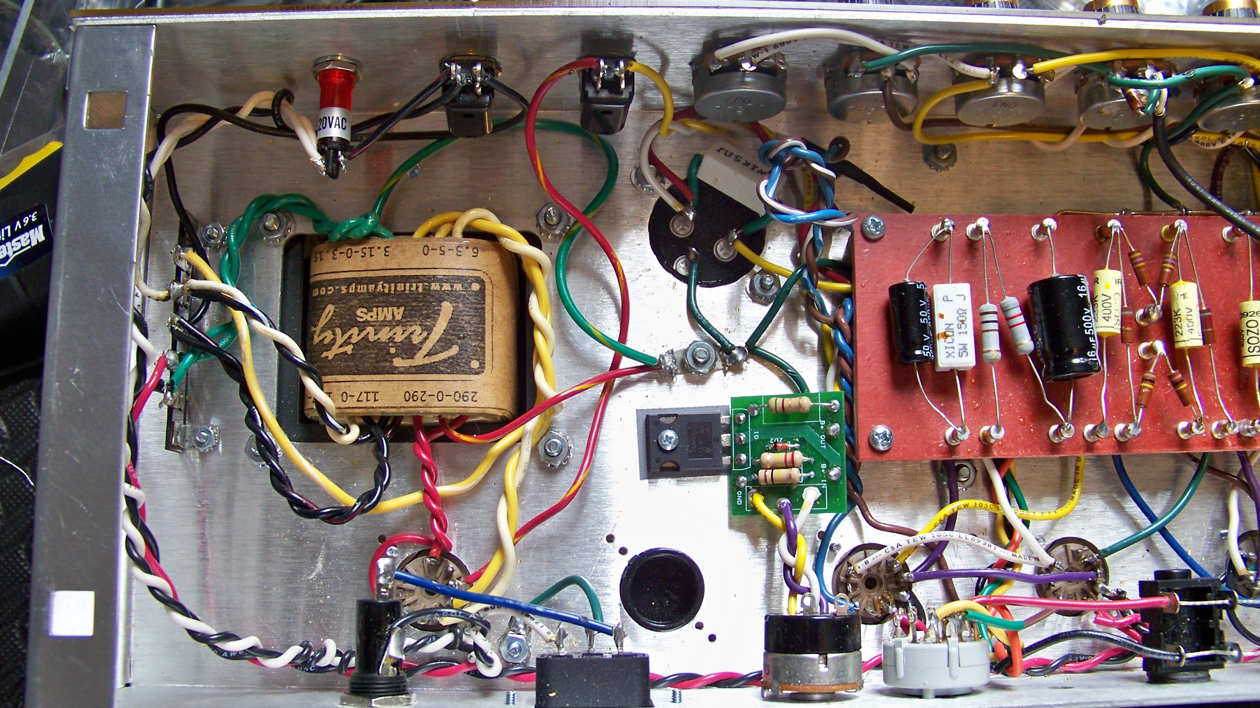

PostPosted: Sat Sep 08, 2012 8:43 pm
I could be wrong
OK looks like the 220k and 100 k res are reversed on the vrm board.
One other thing to me (could be the picture) looks like the preamp ground wire has broken off the rail
Another thing is you swapped c8 .022uf and r31 8k2 on the layout. Looking at the schematic I do believe that might cause an issue going to pin 2 on v5 as it is the cap that's connected not the resistor. First cap and resistor after the 16uf cap from the left hand side of the board

Just checked the vrm ,The purple wire goes middle prong on the pot (I know it looks deceiving in the pic but all 3 wires are connected same colors on both ends )
The c8 .0022uf cap & the r31 resistor was wrong .thanks so much it sounds pretty dam good now
the vrm sounds good ,even turned down a little ,Next is to work taming some of the noise ,the VRM creates a buzz/hum abound 7 till about 9

ok did u fix the resistors on the vrm board and check the preamp ground wire at the buss
PostPosted: Sun Sep 09, 2012 10:43 pm
Yes,
Swap those two resistors and fix the VRM pot wiring.
