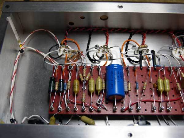

I think he ment to solder the wires on top of the turret board. Just wrap the wire ends around the bottom of the turret and solder. Like in this picture.

PostPosted: Fri Oct 05, 2012 11:40 pm
We have no problem with buss bars installed from the bottom. Jumpers can go either way. It's a preference - I happen to like the clean look and put them on the bottom and never had a problem, but you got to be vigilant. Put them on the top and repair is simple if ever required.
