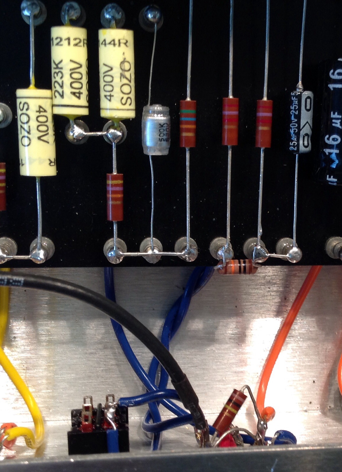

PostPosted: Sun Oct 20, 2013 5:43 pm
I tried 1M, 220K and 100K. 100K being the best but it did not eliminate the pop. The stock switching is from the cathode side, not the ground bus side. I put it across the two 2K7s right on the board.
