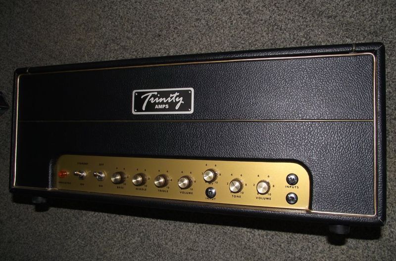

Hey,
I just found a nice amp on my local newspaper. From what i remember from a post here, it is an early model since the MV is in an input.
Anyone could give me some infos about it? Since it's an early model, i guess its a standard TMB. Is it , as good as the new one? Do you think i could modified it for a sIII (since i was looking for a JTM45).

Email Trinity with the serial number and they will be able to give you more info about it.
It's an early one but hard to same exactly what 18W model.

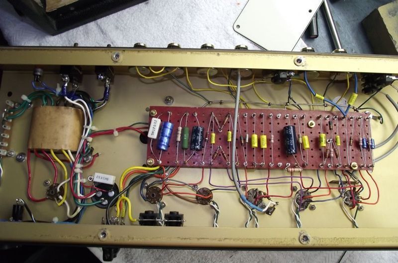

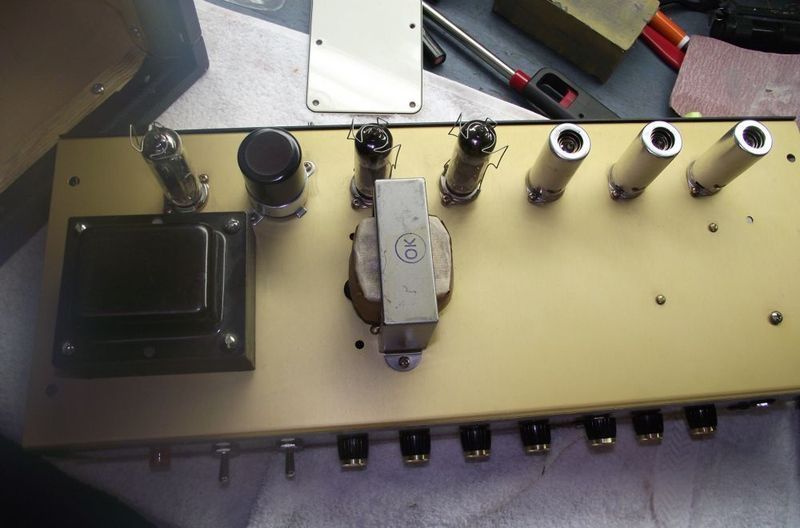

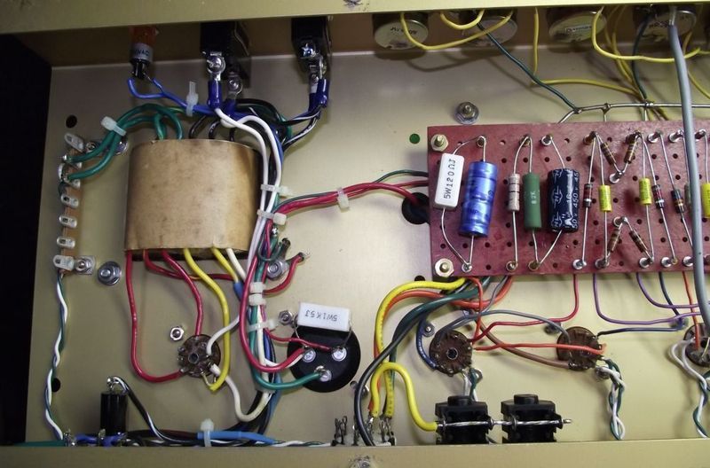

If it's a Trinity built production build it should be on the back. If it's a kit build there won't be a serial number.
Did you email Trinity?

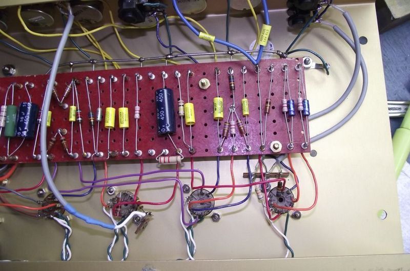

If you open the amp up and take pics of the inside that will be the easiest way to tell who built it.

I just did, but i'll put the pic here. I'm not in a rush, but i was curious about it.

Well, it's definitely a TMB and yes it could be modified to be an sIII. It's a quite early one, maybe 2005 but hard to say. some early ones did not have serial numbers.
PostPosted: Wed Nov 07, 2012 6:35 pm
No serial number, and using the original Richie Hall style 18W TMB layout. Super rare amp! :thumbsup: :thumbsup: Must be worth a lot of $$$$ :D :D :lol:

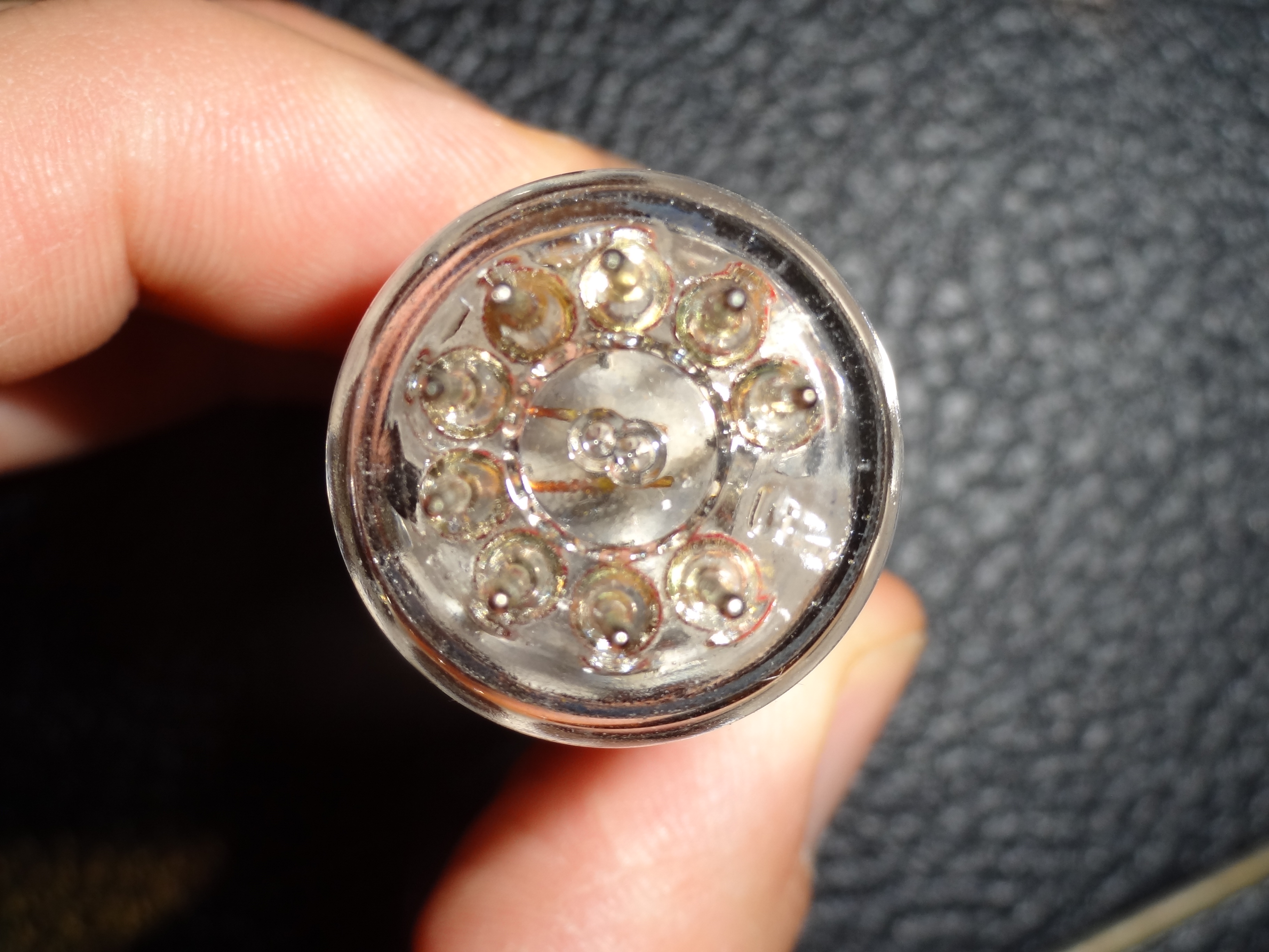

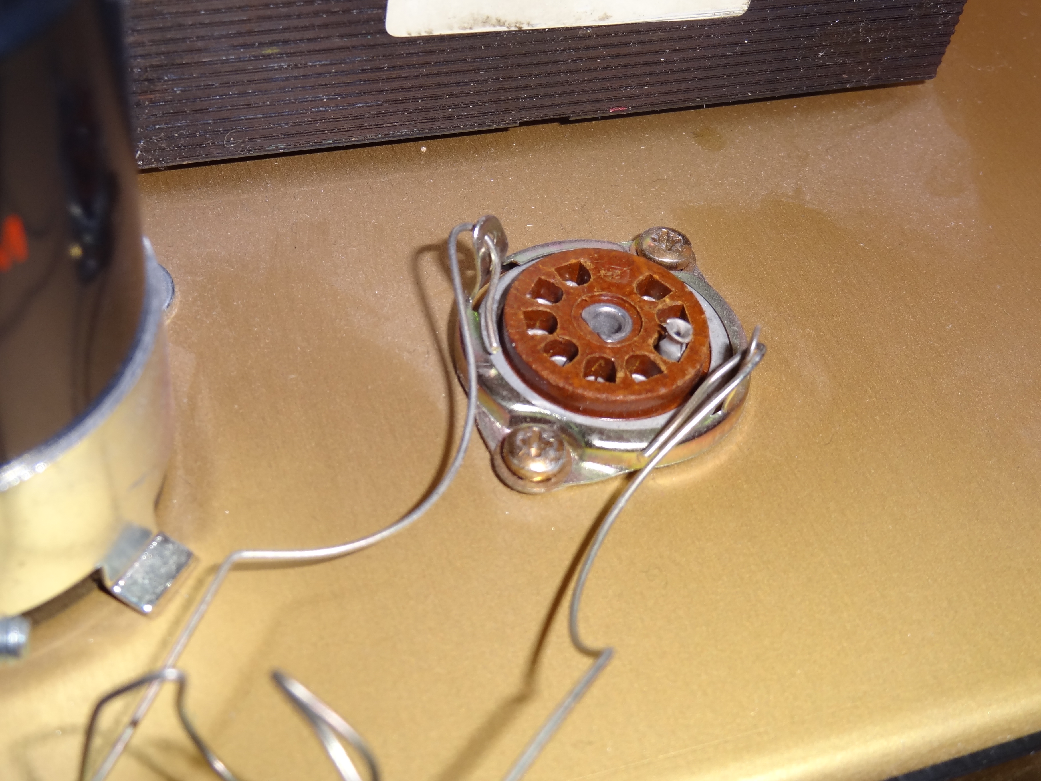

I still got a problem with the amp... Since the rectifier tube was flashin blue, i ordered one from the tubestore. When i removed the one that was installed, i saw a metal part in the socket. Is this normal? I still see all the pins on the tube.

Looks like the clamp in side the socket that holds the pin of the tube is buggerd. Probably gonna need to replace the socket as well
PostPosted: Mon Nov 26, 2012 11:43 pm
Might be able to use the socket temporarily but yeah you want to replace it.
PostPosted: Tue Nov 27, 2012 12:05 am
if you press it down and it snaps in place you might be alright for a while. Otherwise re&re
