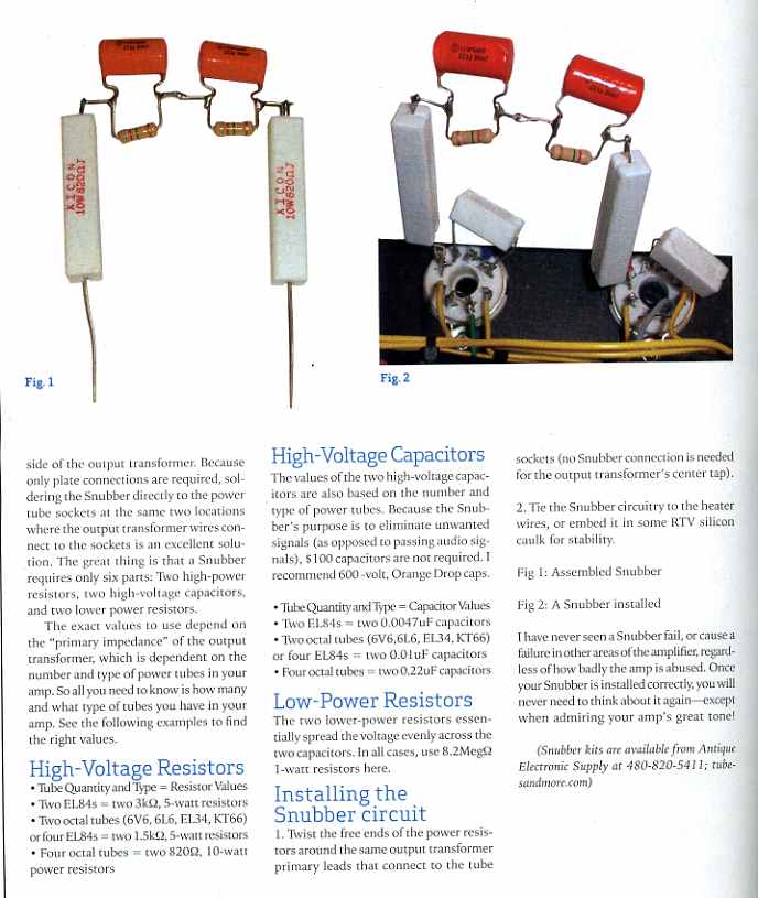

One more dumb question - this month's guitar player features an amp mod the author calls a "snubber" that sounds like it is intended to perform similarly to the Ruby mod - "creates a filter on the primary side of the OT to remove unwanted high frequencies while leaving the rest of the frequencies untouched" - lists two 3kilo ohm 5 watt resistors, two .0047uF capacitors, and two 8.2 megaohm resistors wired as in the picture below attached "to the OT primary leads that connect to the tube sockets"
see attached photo/article
Whats your 2 cents on this vs ruby mod?
Lindsay

what do you think about the Ruby mod or the link I posted from GP mag? Both seem possibly relevant to the issue we are having. In my case I just am a little too green to figure out the particular resistors and diodes necessary to hook a Ruby mod up hence my request for help. The guitar player article is pretty simplified and even I could do that and may try hooking it up just to see how it sounds and what it does
You have more electronics knowledge than I .. maybe try hooking one or both of them up to see if they help (or help me with a layman's Ruby mod parts list and idiot proof layout so I can try it - ha ha)
I guess from what I read the Ruby mod would work but I don't know enough to figure out the values needed for the diodes. The other problem I have is that I have switchable bias from fixed to cathode bias so I think that complicates things.
Not sure about the Stubber mod from GP but from what I read it is like a damper on the highs like putting a blanket over your speakers. Doesn't sound good to me.
