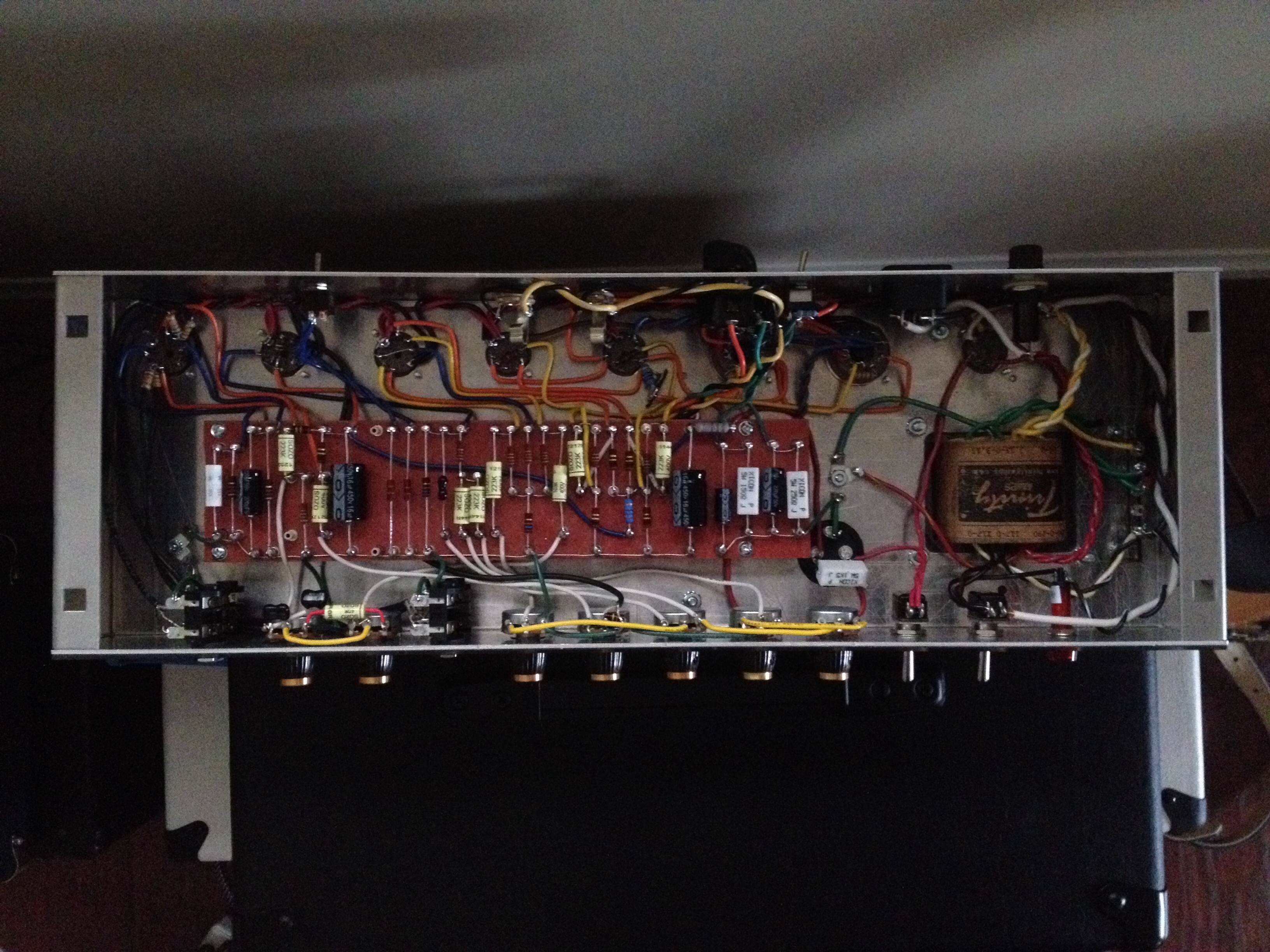

So my wife was out of town for the weekend, and is gone all week this week. So I decided to do some work on the amp. Saturday morning when I started I already had the heaters wired, and the transformers mounted, along with all the hardware mounted, and ready to go. I started with the board Saturday morning, and finished the amp completely by about 3:00 in the afternoon Sunday!!! That was a lot of soldering!!!
The 6V6 side worked perfect, but I forgot a jumper to get the EL84s working. Once I installed those jumpers, everything works perfect, and it is nice, and quiet!!!! I have to say that this amp has balls!!!! It is a very gutsy aggressive sound with the gain cranked, and it is killer with a boost :evil: I am thinking I will be making some clips this week since there are no real hard rock clips for these amps that I can find.
