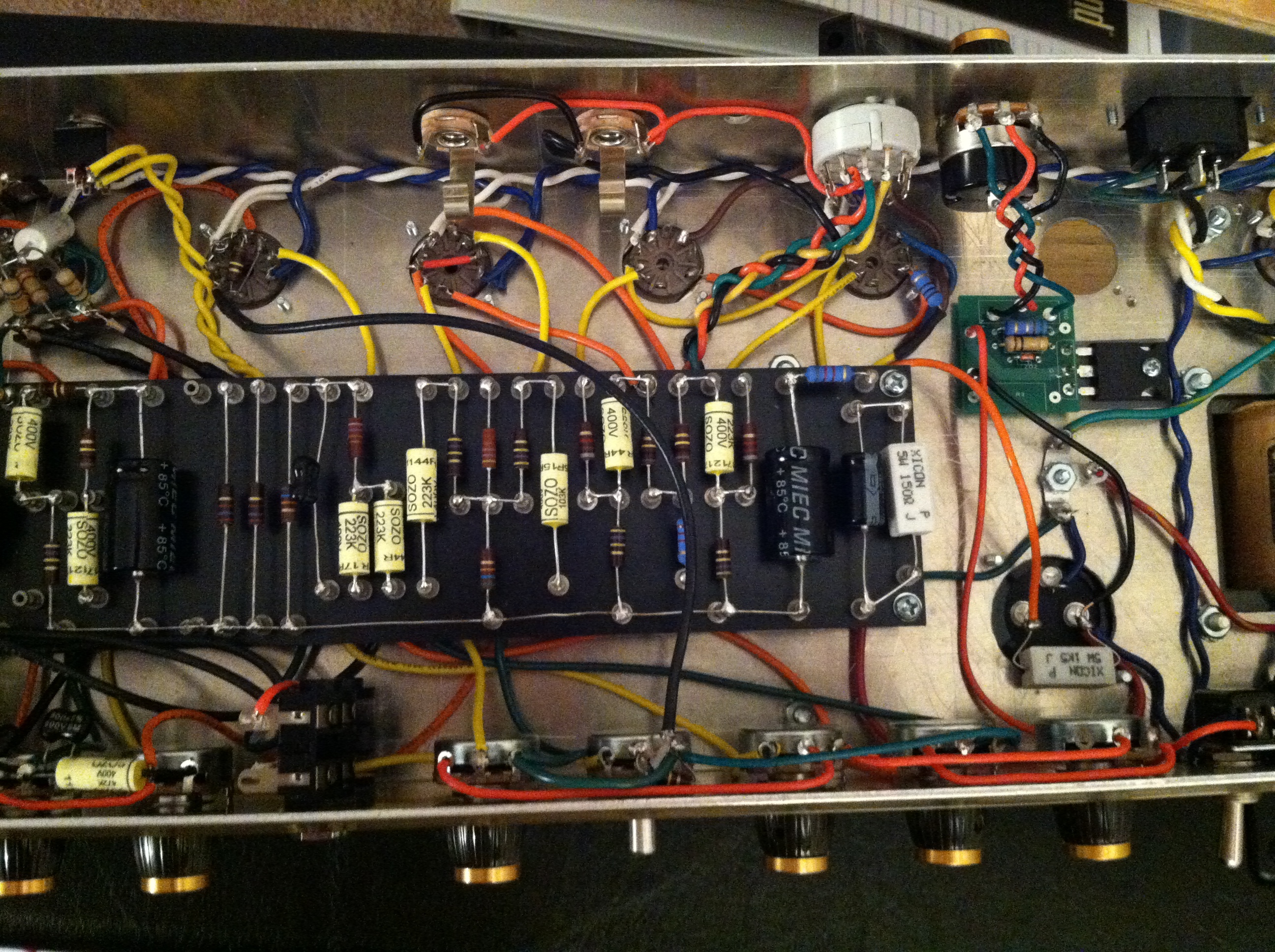

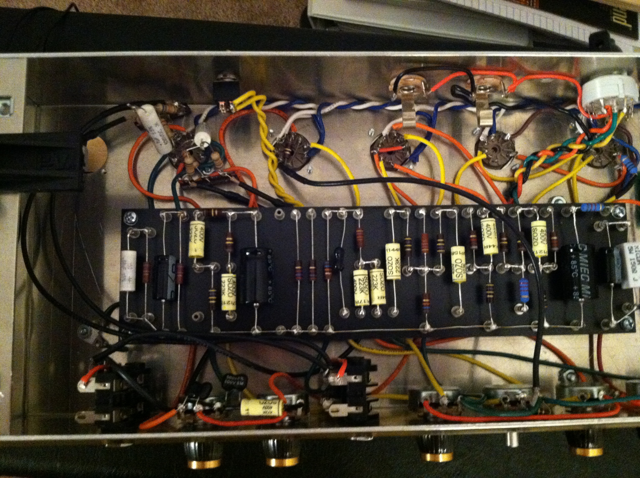

Hi Guys,
I just started my first Trinity kit, and I want to make sure I'm doing this right. I have experience with pedals, and one other amp kit (Mojotone Champ that isn't currently working). I've wired the tube sockets twice now. Do the photos below look okay? Any advice would be greatly appreciated!
Ryan
PostPosted: Thu Aug 29, 2013 8:41 pm
Looks good so far!

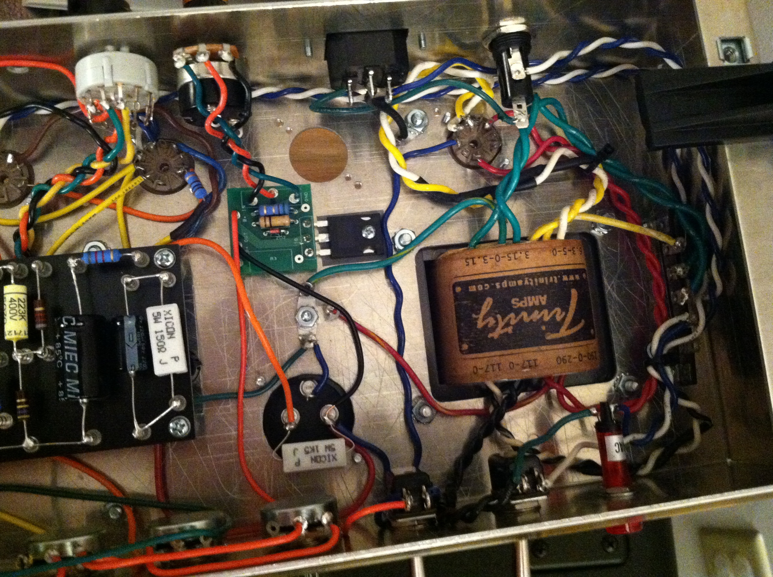

I have been working mostly from the layout drawing, and I failed to twist some of the transformer wires:
Does this now mean that I need to order a transformer and start over? I think the wires are now too short to twist.

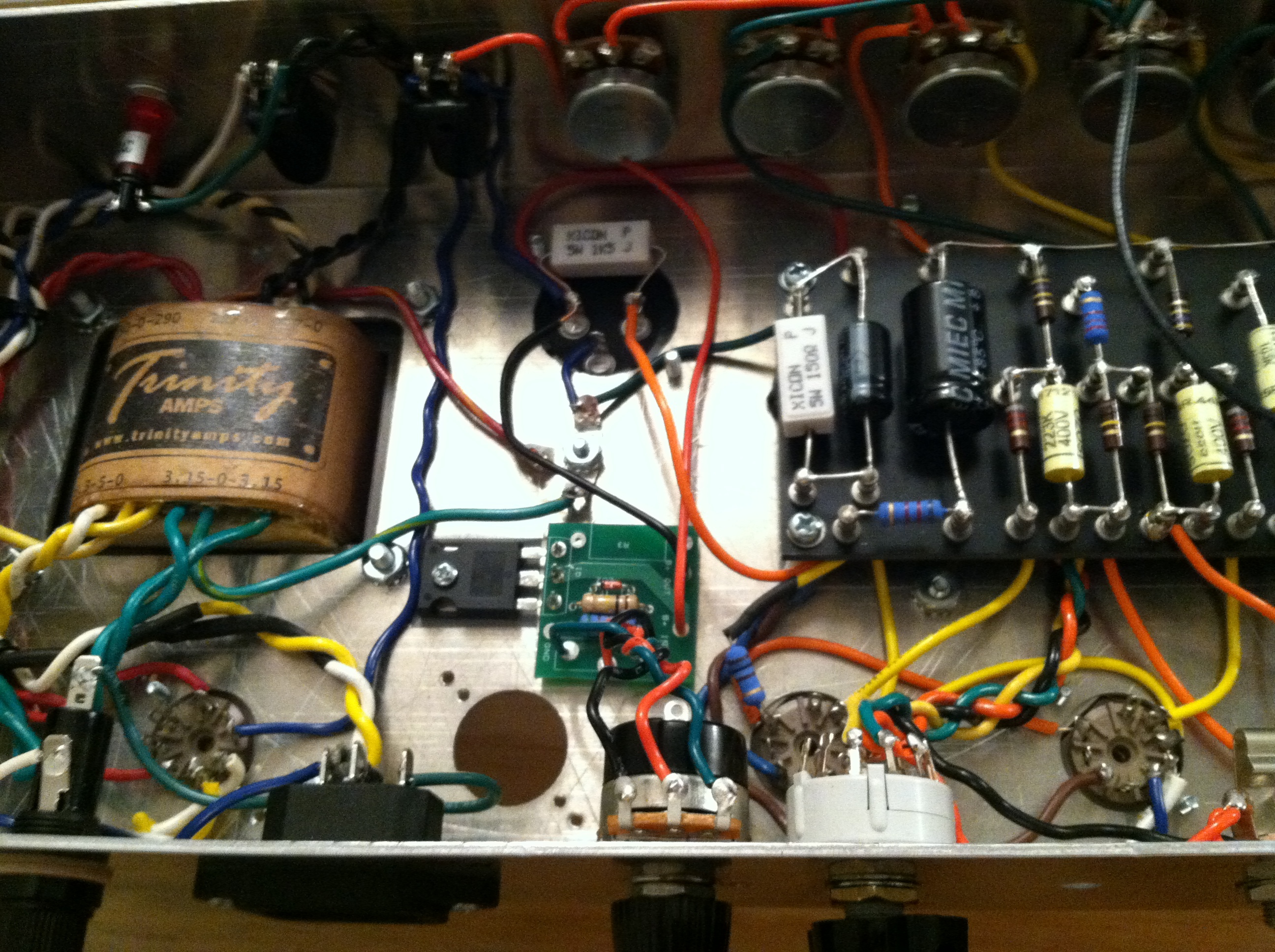

Will do! Here are some pics:

I rechecked the board with my DMM. Everything to the right of the boost switch terminals registers normal, but everything to the left of those terminals is way low. The furthest left terminal registered normal. Anyone see anything in the pics that I am missing, or do I need to cut out the board and start rewiring all of the jumpers? On the plus side, I'm getting lots of experience discharging the amp!
PostPosted: Sun Dec 08, 2013 10:31 pm
Did you install the under board jumper from the 2K2 2W to the + side of the second 16uf filter cap?
Measure the voltage at the + side of the 16 uf cap.
PostPosted: Mon Dec 09, 2013 8:08 pm
Joined: Tue Feb 05, 2013 1:45 pm
Posts: 9
I'm getting 66.5. I also tried to jumper the two connections with alligator clips at the turrets and got the same reading.
PostPosted: Tue Dec 10, 2013 11:50 pm
Did you connect the first +16uF cap to the 2K2 2W resistor? What is the voltage on the other side of the 2K2 resistor?
PostPosted: Tue Dec 10, 2013 11:52 pm
I think you have too many wires coming off your stby switch. If I recall you break the connection to the b+ side of the cap . The wire runs from the switch to the b+ side of the vrm and then from the out side of the vrm goes to the cap.
Don't know if that will help your down stream voltage issue or not

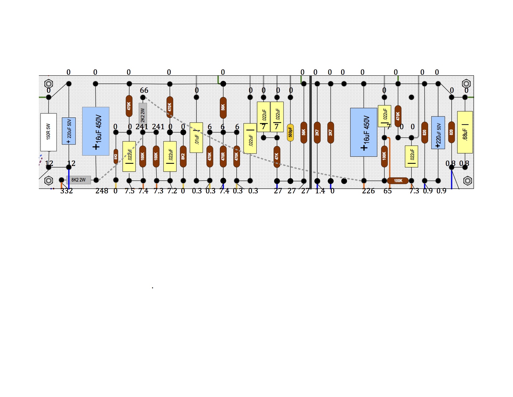

Something is way off! I measured all of the voltage on the board and here is what I found:
Does anything look right?
PostPosted: Sun Dec 15, 2013 8:19 pm
Something is wrong near the input (V1). Your voltages there are low and they are brining down the rest of the amp.
Look for wrong resistor values or maybe even a short.
