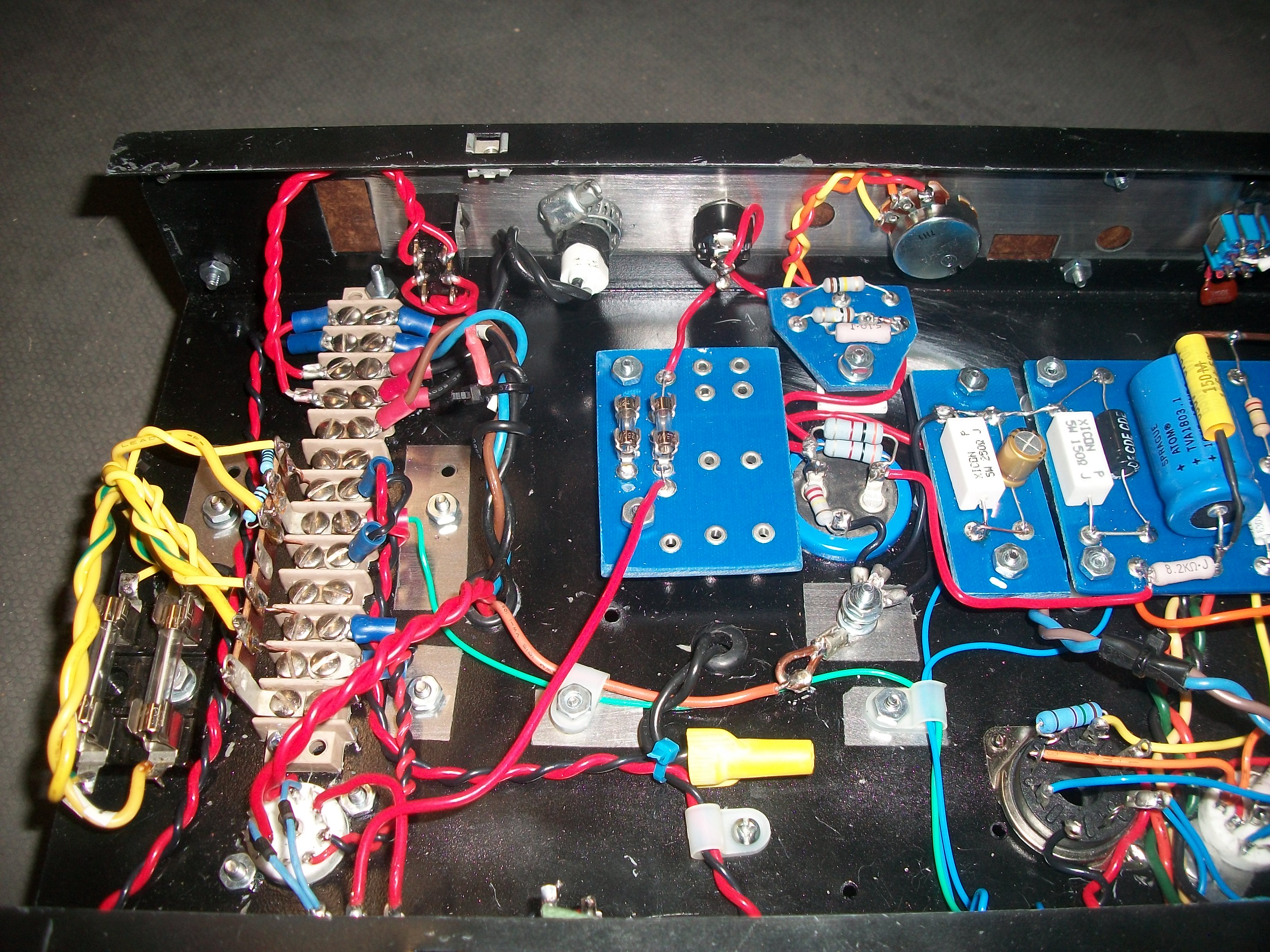

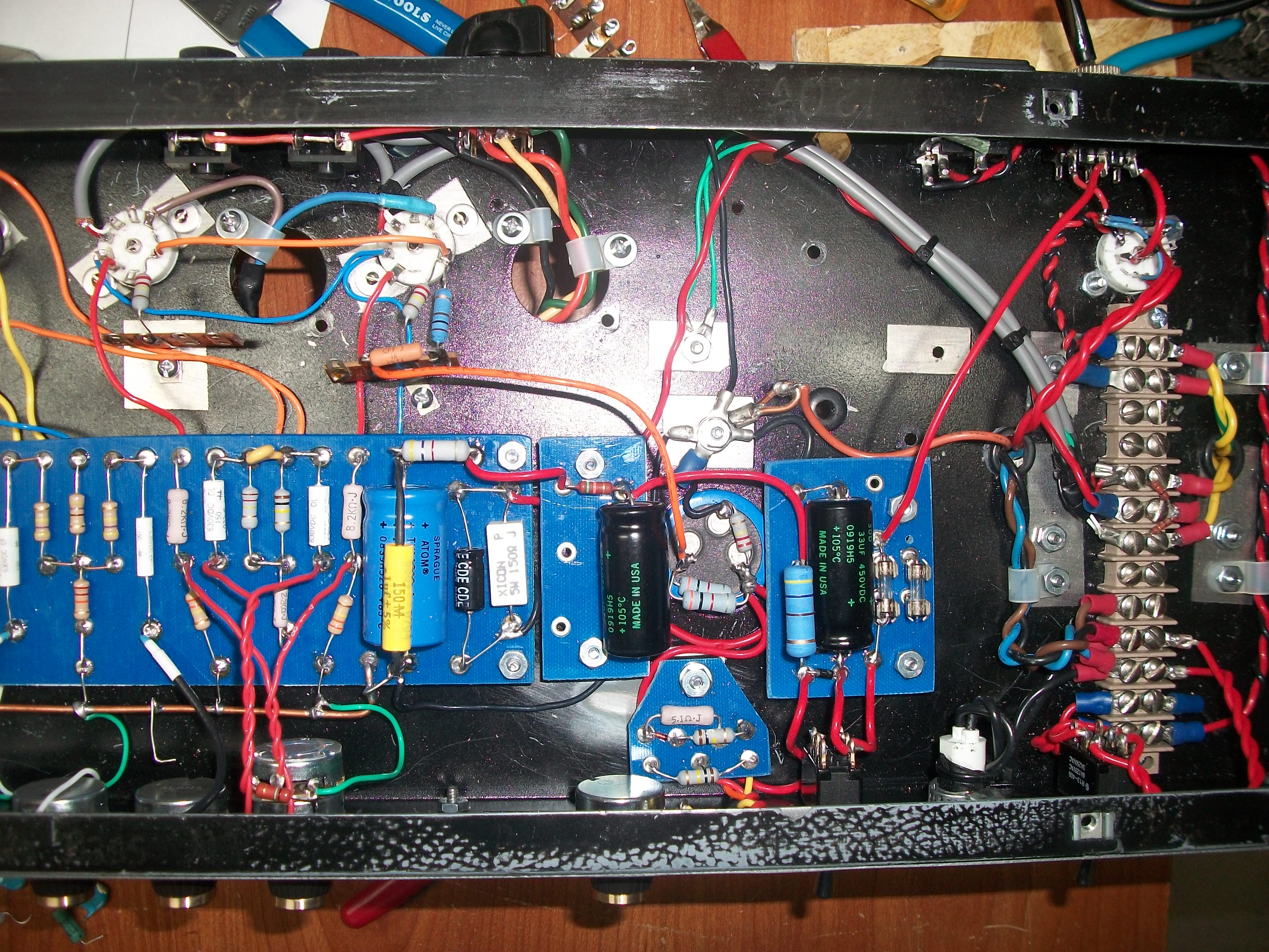

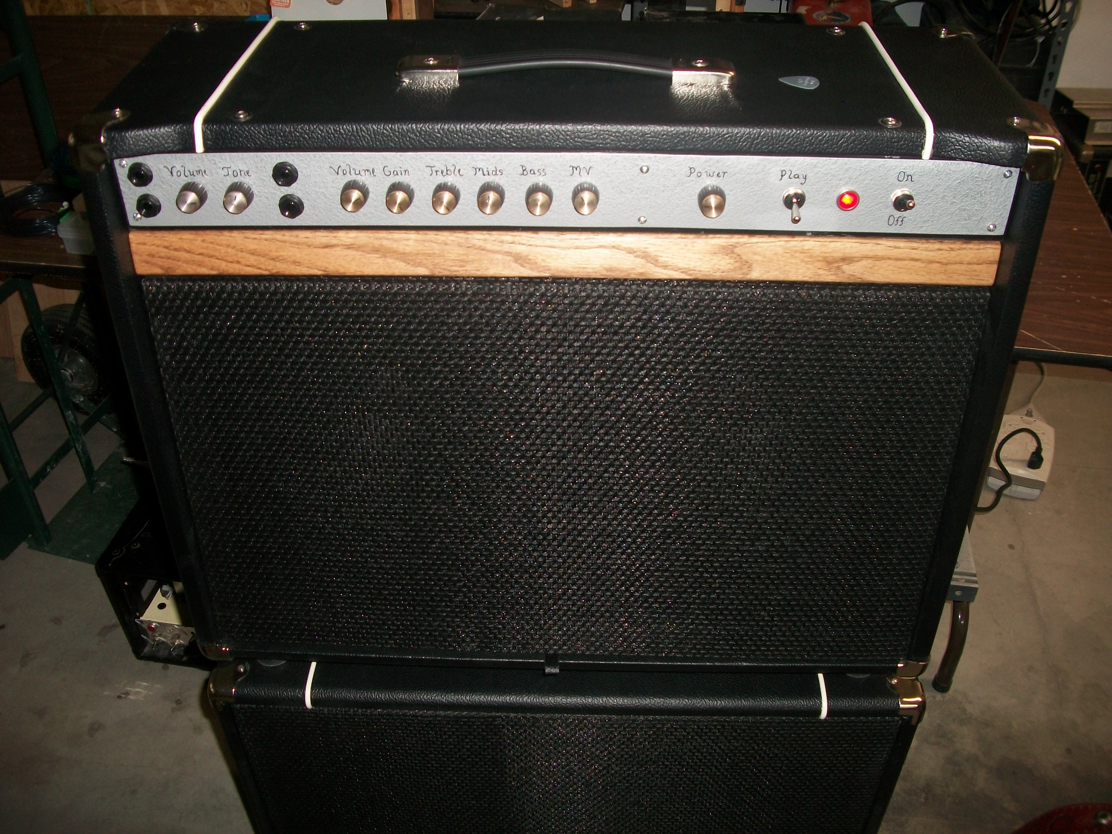

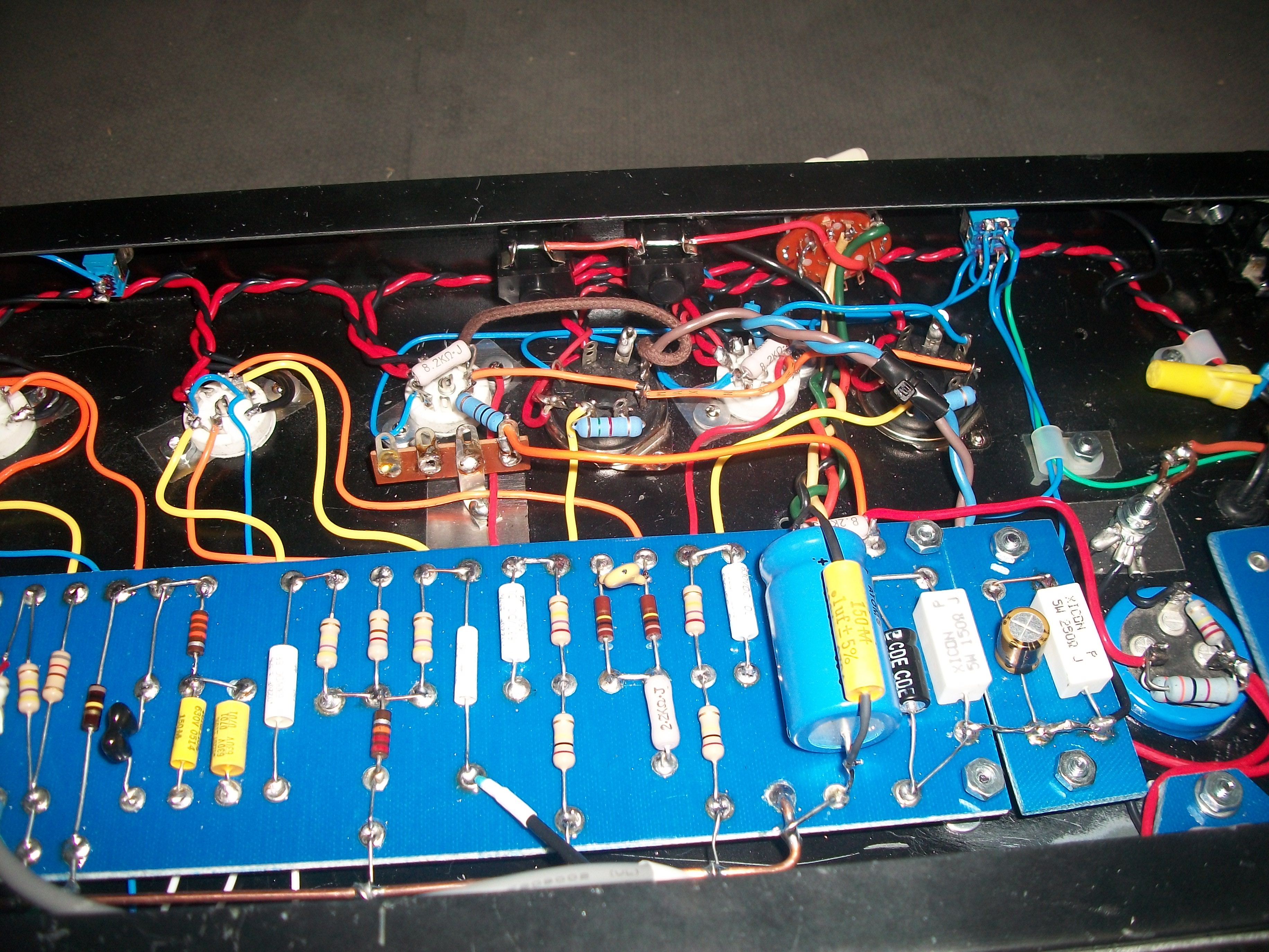

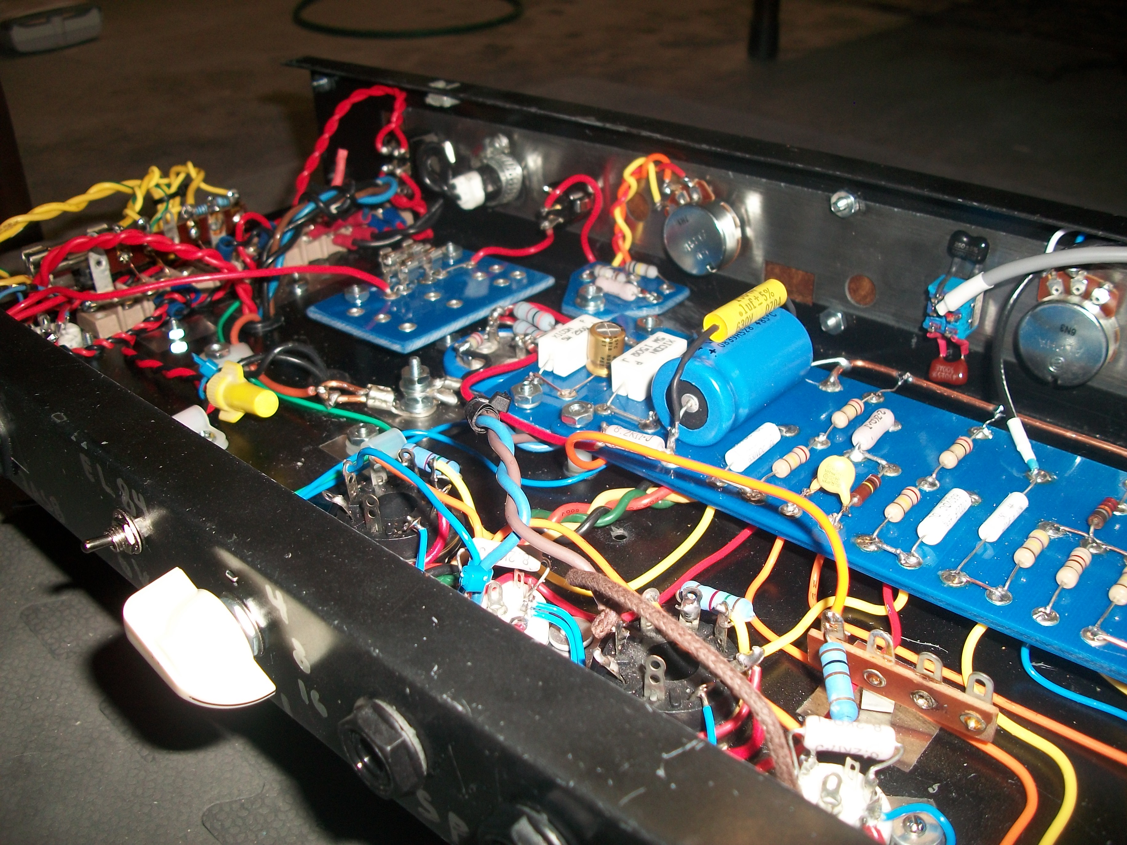

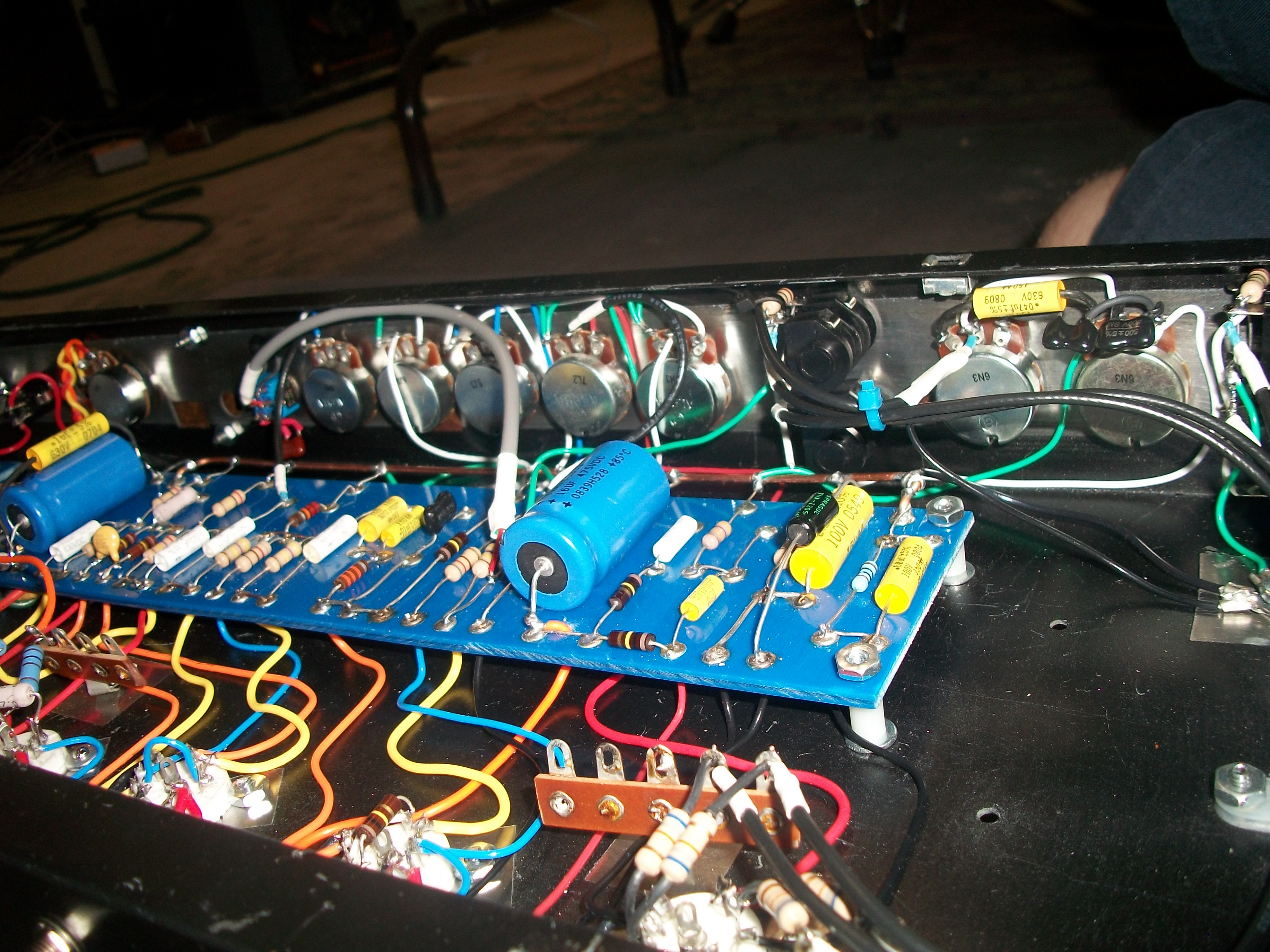

Its working,the voltages check out pretty good with 297 and 297 to rectifier 353 at plates and 333 at screens 11.4 at cathodes,so its dissipating 11.7 watts per tube.
I haven't tried 6V6's yet.
It has a little too much hum for me at full volume probably my lead dress as I don't really know what I am doing yet just following the layout.And there isn't much clearance at the back of the chassis.At idle its really quite.
But the old CR212 Crate sounds and looks way better than it did.
I don't really like the VRM at low volume,no scratchy knobs,but I only like the tone to about half way down and its still fairly loud.
Going to try rectifying the heaters unless someone has some feedback on how to improve my lead dress.
Then install the PPIMV and VRM the PA only,or should I VRM the PI and PA ?
I am going to make the bright cap permanent,as well as the boost cap and eliminate all that wiring and switches then try see how I like it.
I must say a kit would have been WAY easier,but I had these parts laying around for 4 years now and saved the old Crate amp just for this.
I really like using the A/B/Y pedal for changing channels and like jumper-ing the channels too.
This is a really great design ,the voltages are spot on with the EZ81 doing the rectifying (although I was reading 35VAC after rectification?) as well as 357.5 DC.
THANK YOU !! Coco for sharing the info and giving feedback,I know why now you get such excellent reviews online !!
EDIT: I just noticed looking at the pics my boost cap for the normal channel is installed backwards ,no wonder it had no effect :oops: Evreything else works right,I did have the VRM pot backwards and had to switch two wires :?

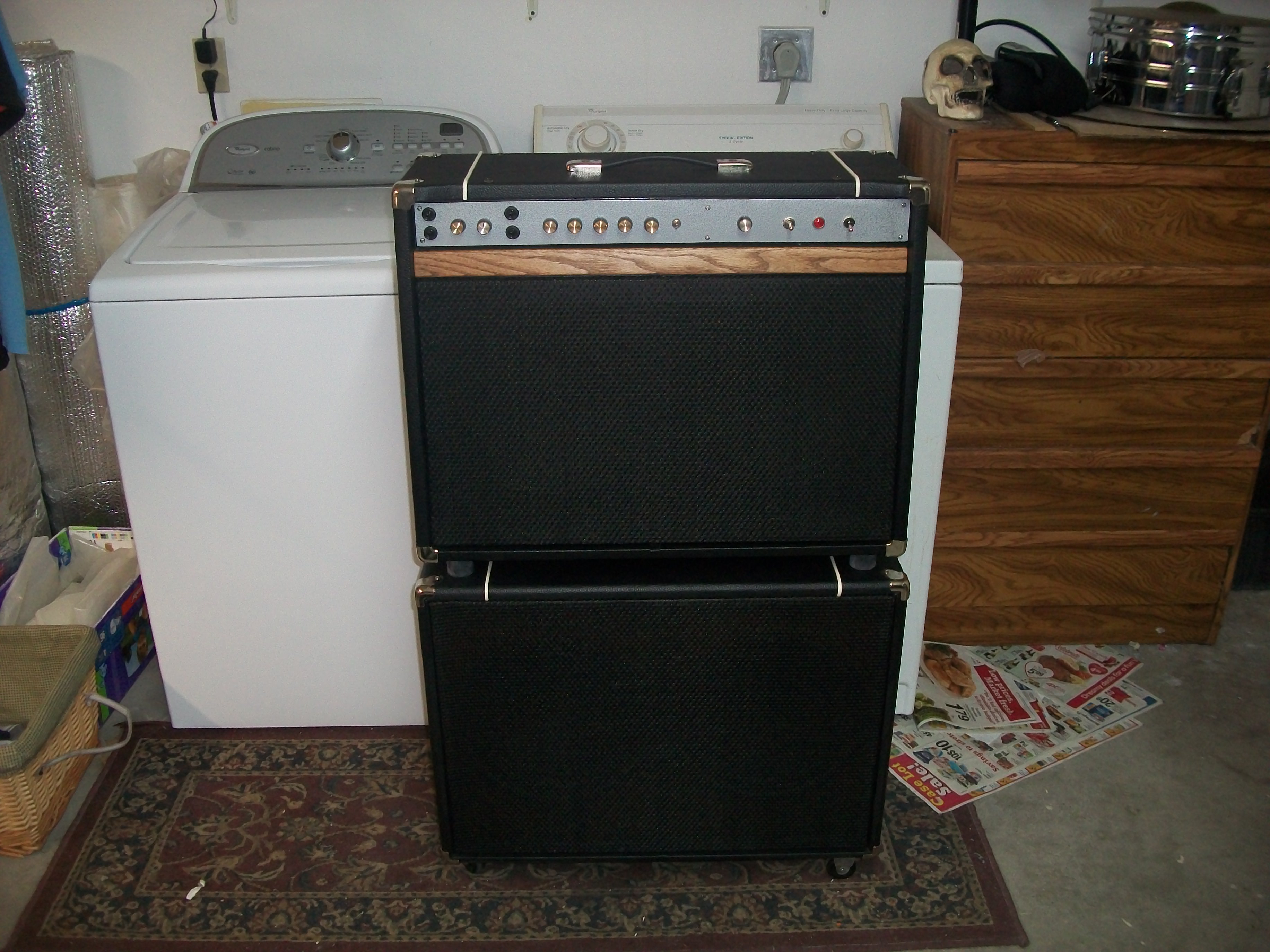

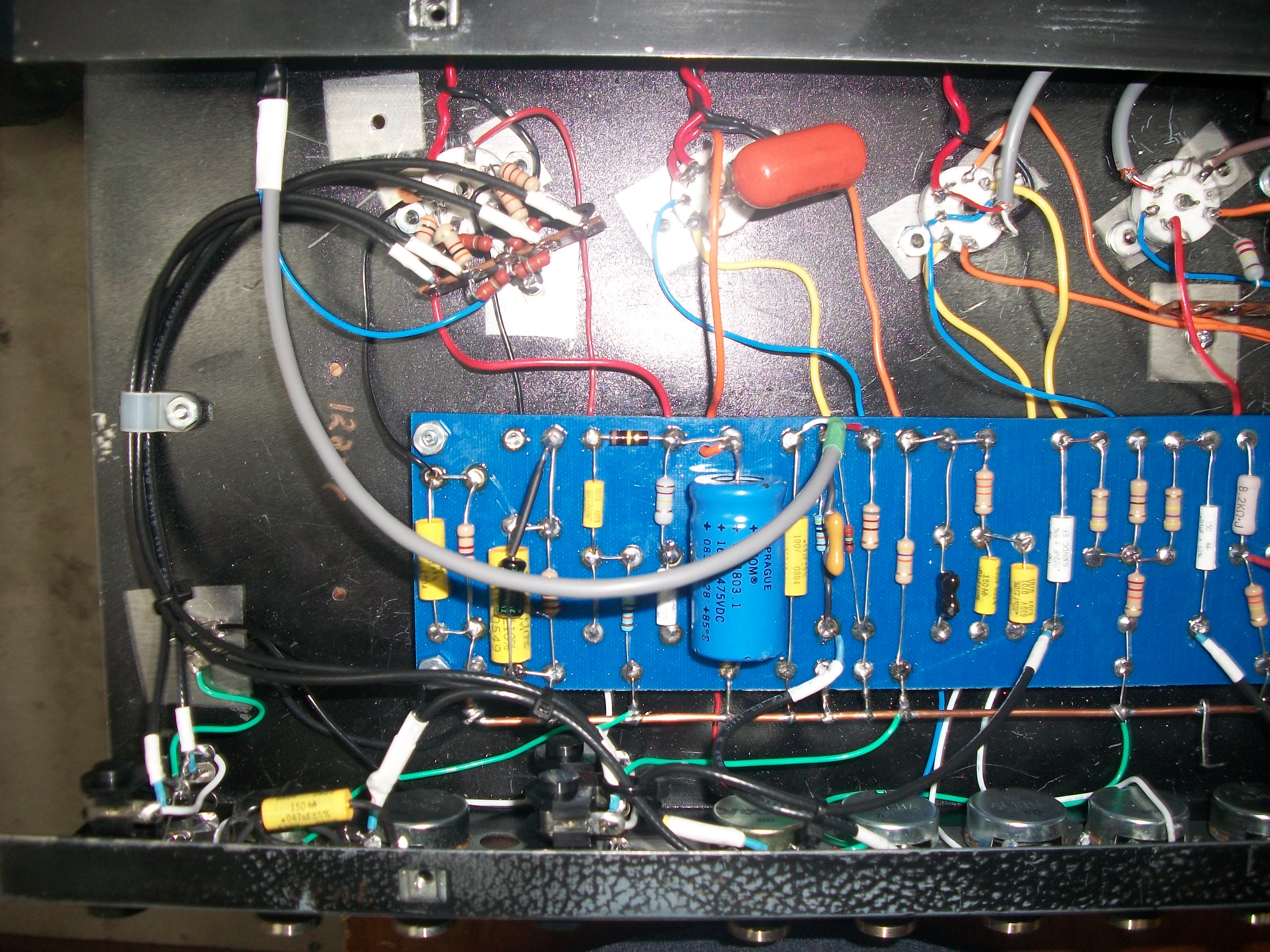

OK ,it's finished for now as I can't wait to play it for a few days.
Mods I did are:
VRM the PA only. :thumbsup: :thumbsup:
I love this!(35V on EL84 plates min - max 360V with EZ81 )and (380/385V with SS rectifier,would be good for 6V6's)
Switchable tube/SS rectifier
At low V the EL84s break up SO nice at bedroom levels! 8)
The PPIMV (post PI master volume) a must have if you ask me...
Allows me to overdrive the PI as well if I want for more crunch.
I bootstrapped the CF with the previous stage(2 x 68K = 136K + .068uf) this sets the gain of the previous stage to the max of the tube used,and with that previous stage's cathode bypassed on a switch with a .68uf ,Thank You Merlin for this info!!!!!(from his website)
http://www.valvewizard.co.uk/dccf.html
1st stage of the TMB channel is 2K7/.68uf Rk,120K plate R into the stage bootstrapped with the CF along with the 2 x 68K plate Rs it uses a 470K (680P bright cap) gridstopper 1M gridleak, 820 Rk ,the CF uses a 47K Rk.
This gives me TONS of gain available,enough to do Metallica without adding a boost pedal.
The biggest reduction in white noise came from lowering the 1st stage's grid stoppers to 3K with the 1M grid leaks and a 68P G-K,the normal channel has been lowered to 22K grid stoppers,1K5 Rk,bypassed with 2.2Uf and 25Uf paralleled.
I added the 220K/2W screen leaks on the EL84s and am feeding the 100R screen resistor through a 1K 3W resistor.
Removed the octal sockets for now,more room, less to trouble shoot,will probably change back to octals later on.
The hum was from poor lead when I "straightened up" the inside,this caused bad routing.
Along with the heater wires being mixed (possibly)
I ended up using 2 x 1K balance resistors and elevated the heaters to my PA cathodes.I even tried a hum balance pot and it didn't offer any improvement over the resistors.
I also used shielded biwire to the PA and up to the PI for the heaters.
Anyway its all fixed very little hum or white noise.
I did A LOT ! of reading to get the white noise level down as far as possible,and to get as much gain as possible without adding another tube or cascading the normal channel.
I love this amp !!! Thank You Coco for making the schematics and layouts available!!
I will try and get some sound clips recorded so you can hear how much gain the bootstrapped CF adds,and how good the VRM on the PA only sounds at low volumes.
Future mods in planning are adding another tube so I can have a paralleled normal channel (chime and shimmer) and a paralled 1st stage on the TMB channel (lower noise),mixing resistors,an NFB loop and a presence control.
This will mean losing the tube rectifier though,but that will allow me to re rout the HV better from the PT to the rectifier.
Still not sure on these I want to play it awhile as is first.

Well this is intriguing. I've looked at the boot stratping several times but never got around to it.
Your white noise suppression I'm guessing it has a lot to do with the cap from G-K making a low pass filter
One question is on the tmb what value coupling cap did you use between stage 1 and 2?
PostPosted: Sun Mar 23, 2014 8:42 am
Very interesting, especially the bootstrapping. I'm not always into a lot of gain, but it might be worth trying that in some cases as it's a simple 3 part mod.
For the PPIMV, what configuration did you use?
On the VRM, we change the lower resistor to 220K to limit the bottom end low voltage.
PostPosted: Fri Mar 28, 2014 8:59 pm
Joined: Sun Feb 16, 2014 8:47 pm
Posts: 17
At Sasafraz I thought the white noise was more relative to the input grid stopper resistor value,
And the GK cap was for RF (or just HF)suppresion but I am not really sure,I am more a hack than a tech. I will check tonight on the first coupling cap IIRC it was a .022,I've been fixing up an Egnater Rebel lately,cheap junk electros in them,and 1/6 watt CF resistors...
But I labeled all the components on the elusive schematic that I found for it,after lots of searching and none have values on them.
But they do use regulated pre amp filaments and a similiar RC network at the input and have almost no white noise,so I am going to compare and tweak my Plexi some more.
At Stephen I used a dual ganged 1MA pot,but added a 1M MF resistor between pins 1 and 3 on each gang (to make a dual ganged 500K),and used 330k for R18 and R19 on the Plexi version6 schematic.Changing R18/19 to 470K would probably work better as would getting a dual ganged 500K pot,or just change R18/19 to 1M and remove the resistors off the pot making it dual 1M again,but I was afraid that would be noisier.
The pot/s break in between C8/9 and R18/19 bleeding the signal after the PI to ground or not.
