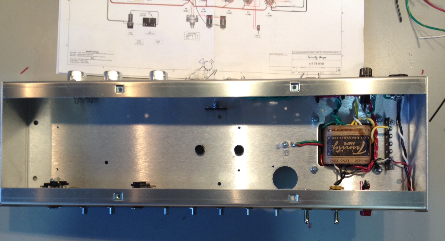

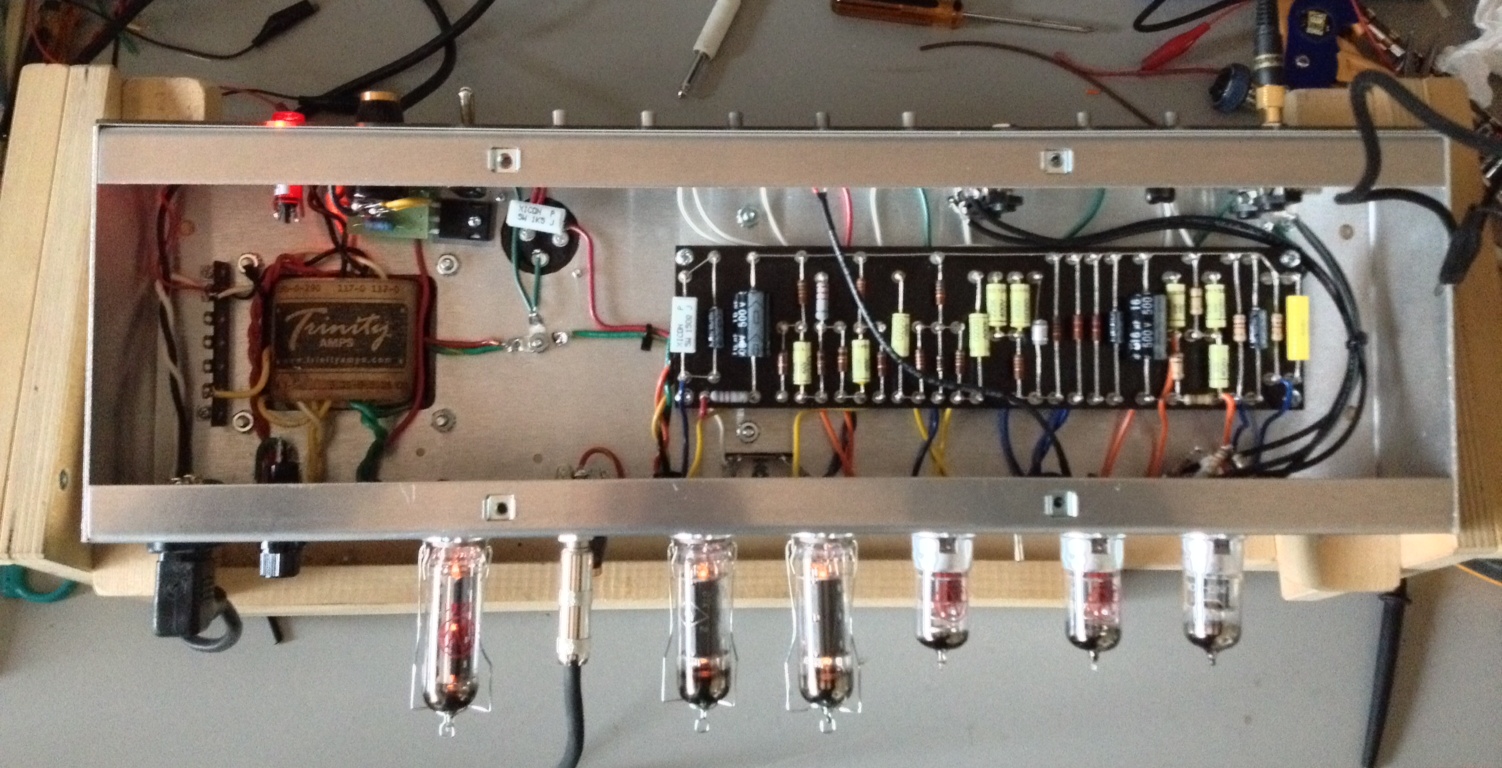

Deciding to go the trinity route, I read the manual and I was wondering the tube locations on the backside of the chasis?
Do I skip the first hole then go 1/2/3/4/5 imp switch and jack then rectifier tube?
Yes.
But you can start there if you want. Its an extra for TC15.

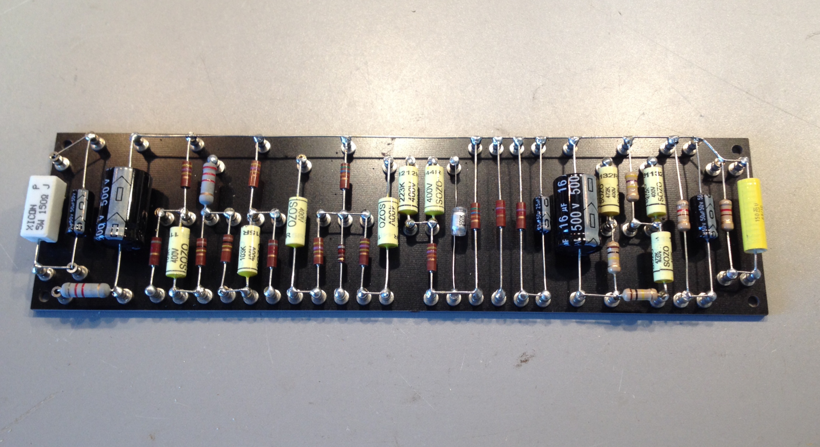

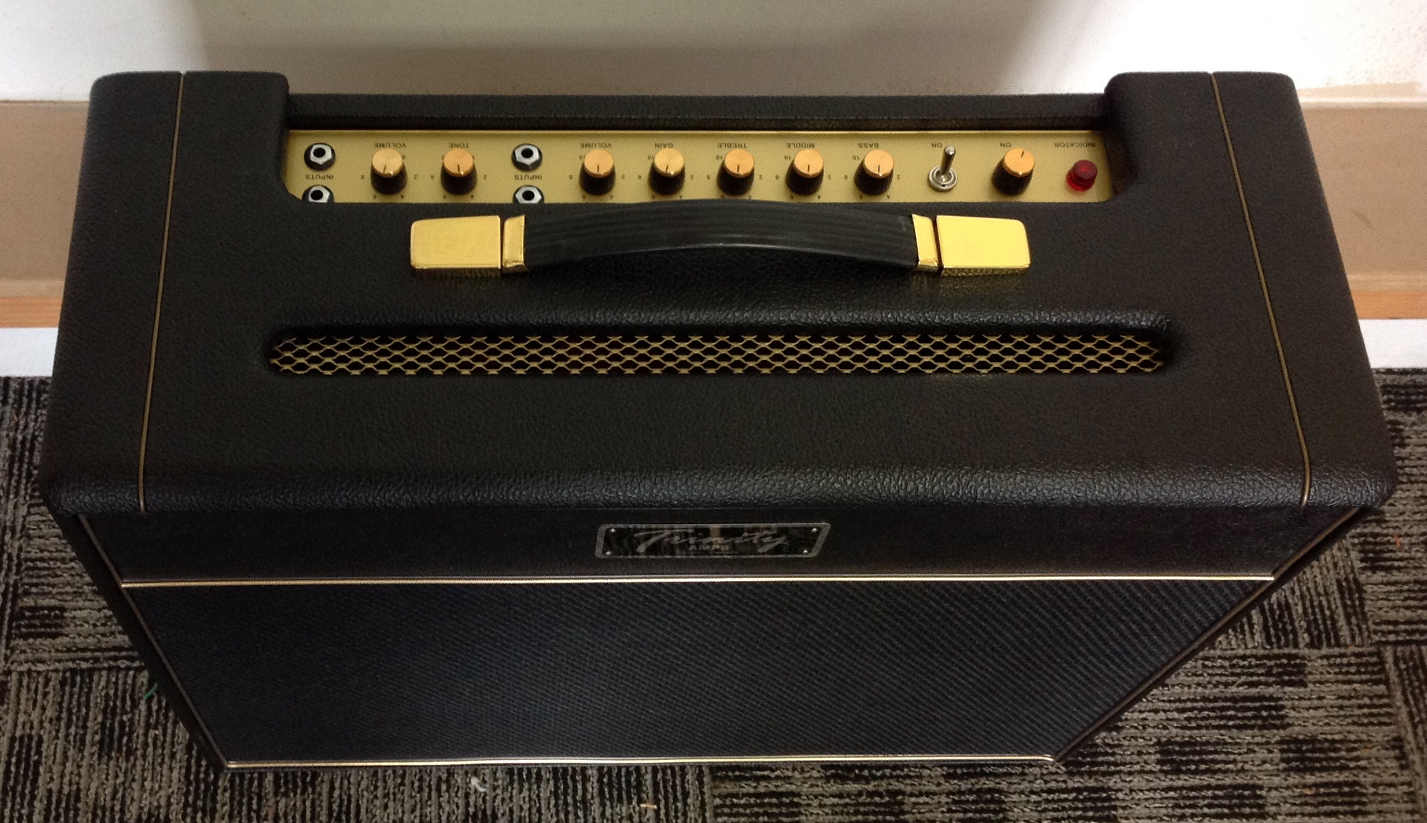

Combo build pictures hmmm, let me look. We did build a combo recently so there may be pictures of it. Most seem to build heads, which explains the docs!
PostPosted: Wed Oct 08, 2014 5:43 pm
Not the best pictures at all but they might help. This customer is located in Berwick, NS.

The turret board pic is very helpful for assembling the TB (what you posted here steven) however on my board only 2 resistors are metal
is this correct for a sIII
THANKS
