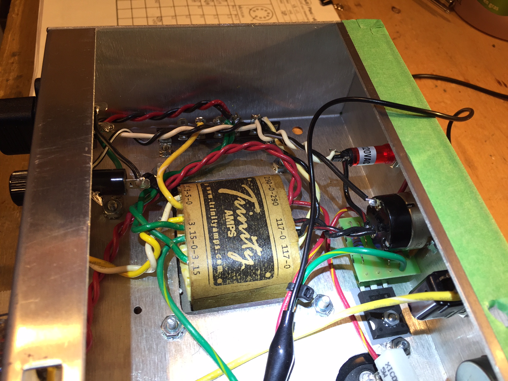

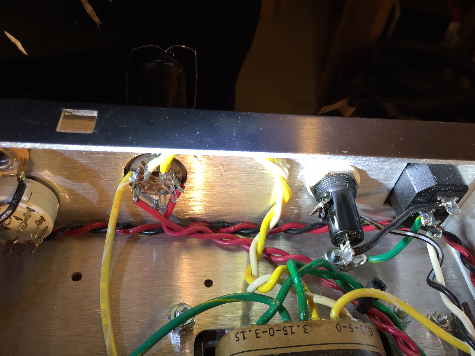

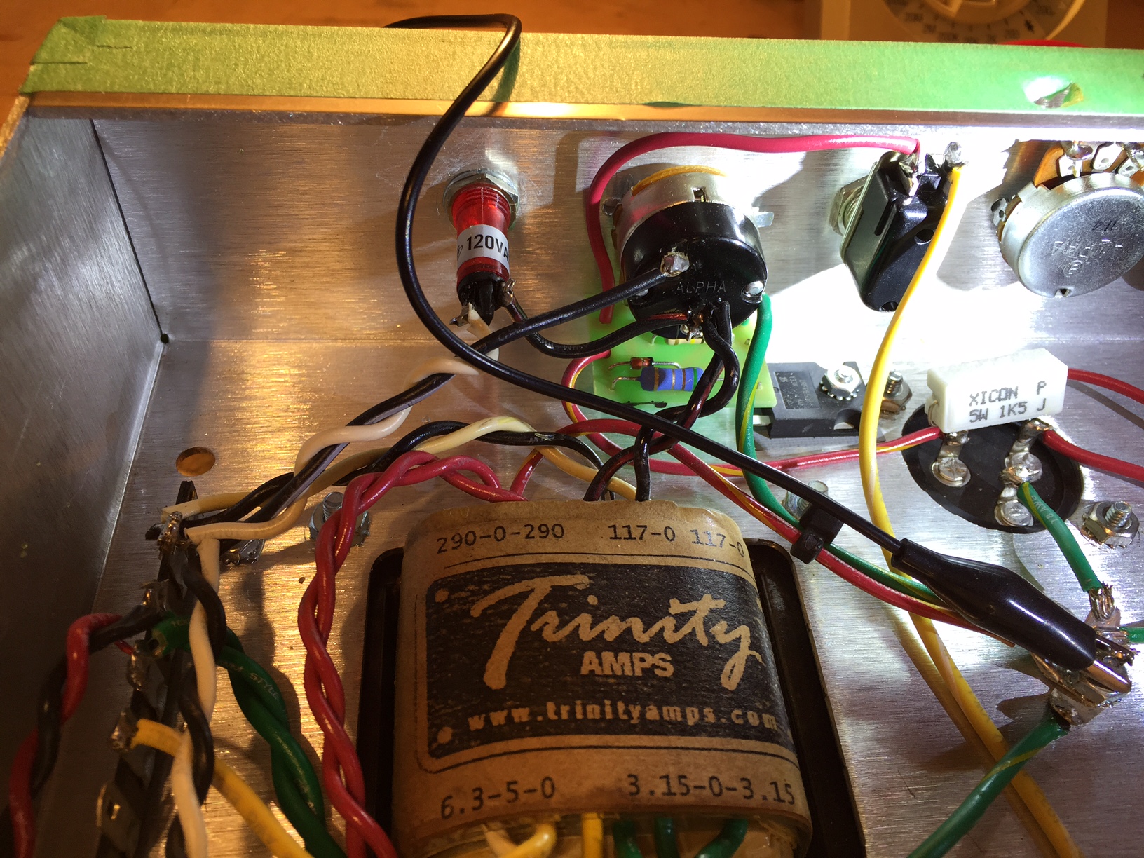

For some reason I am getting my B+ voltage on the plate pins of all power, PI, and Preamp tubes instead of the ballpark values shown in the Trinity 18 Voltage Chart.
I am building an 18 watt sIII with an installed VRM module and the 120 Volt power configuration. At this point I am finished all soldering and assembly steps.
Results for the "Test Power Supply" section on page 46 of the manual seem normal:
121.4 VAC across N and L IEC mains socket
121.4 VAC across indicator terminals
7.0 VAC across all heater wires of Rectifier, Power, PI and Preamp tubes
643 VAC across pins 1 - 7 of Rectifier socket
Under the "Making a Voltage Measurement" section on page 67 near the bottom of the page it states:
"With no rectifier in place, apply power and test the High Voltage AC and ensure that it is on the correct pins of the rectifier and in the correct voltage range (290 VAC)." How do I perform this test with my meter? It sounds like the same test as already completed where you measure VAC across pins 1 - 7. I measured 643 VAC and not 290 VAC as suggested???
I moved on to the next test, on page 67, where I installed the EZ81 rectifier tube. I powered up for 10 seconds then turned on the standby switch. B+ was 436 VDC at the first 1.5K 5W resistor and 440 VDC at the rectifier socket (pin 3) which seems normal.
Next I moved on to testing the plate voltages on the other power (pin 7), PI and preamp (pins 1 and 6) tube sockets. My results were between 437 - 439 VDC (aka B+ voltage) on every one of these plate pins. I believe something is wrong so I stopped testing at this point.

File comment: VRM view
File comment: Power supply view
File comment: rectifier socket view
