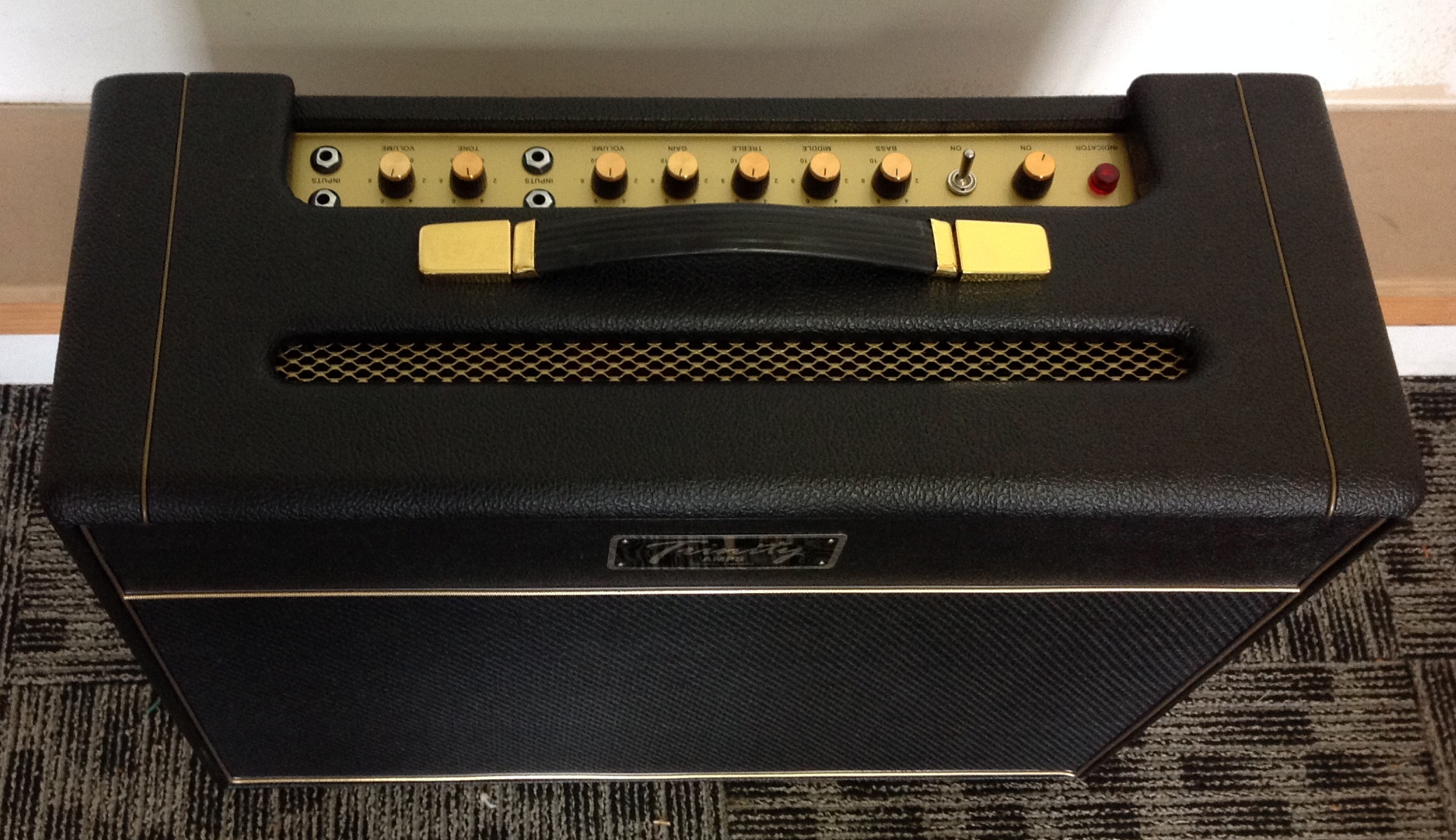

Do you have a picture of the panel?
should look someting like this download/file.php?id=1425&mode=view
if the on switch is a rotary one, its probably voltage scaling
And I Think the older models where slightly different knob layout

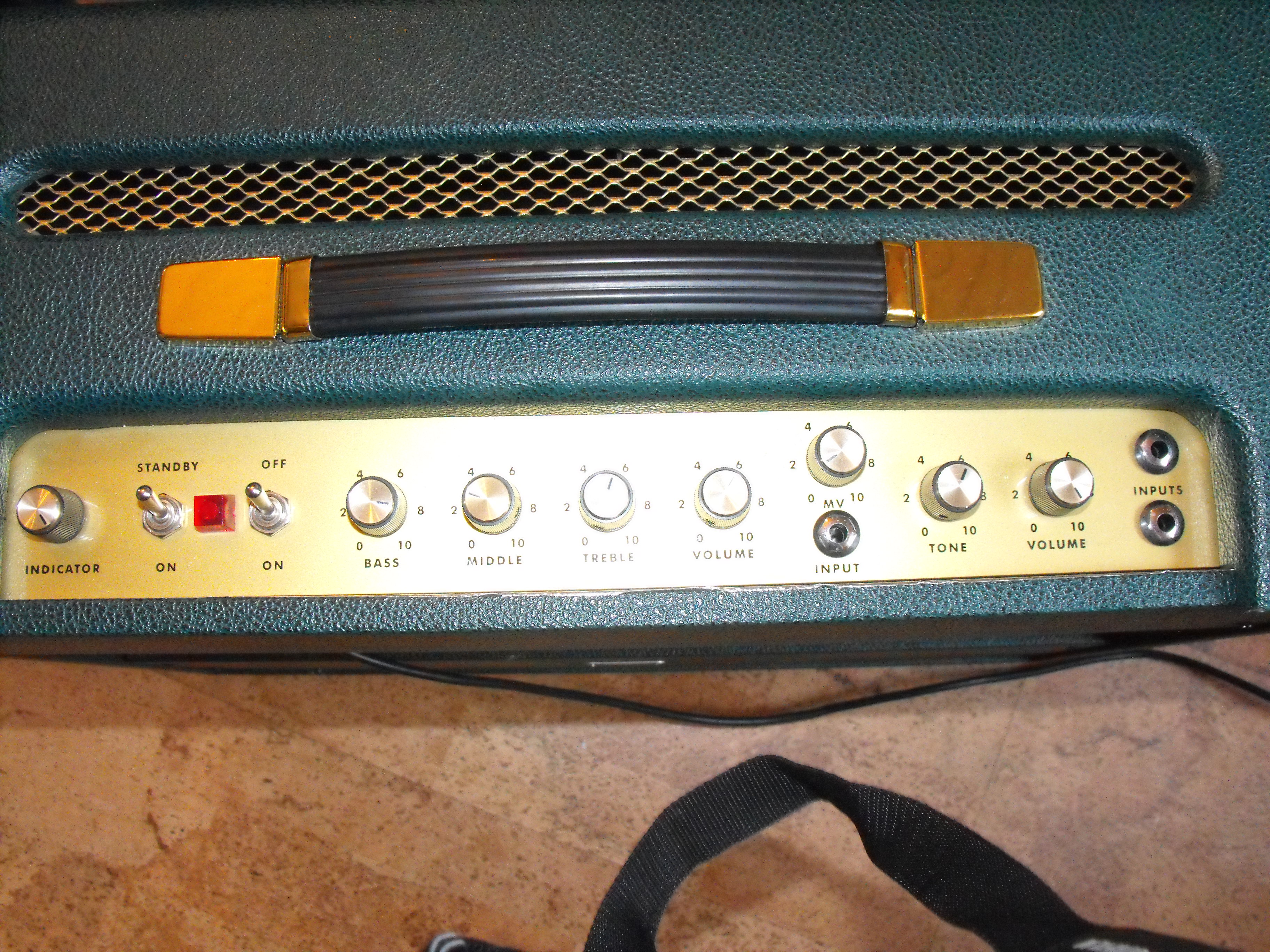

Sazafraz, I will try to get some photos of the panel asap. Looking at your photo, it would appear the amp I got strays from the layout somewhat. Where your led indicator is, I have a knob. Where your on knob sits, I have a standby switch, then there is an led in between the power and the standby. The rest of the layout looks the same, except the upper input on the tmb channel is the MV knob.

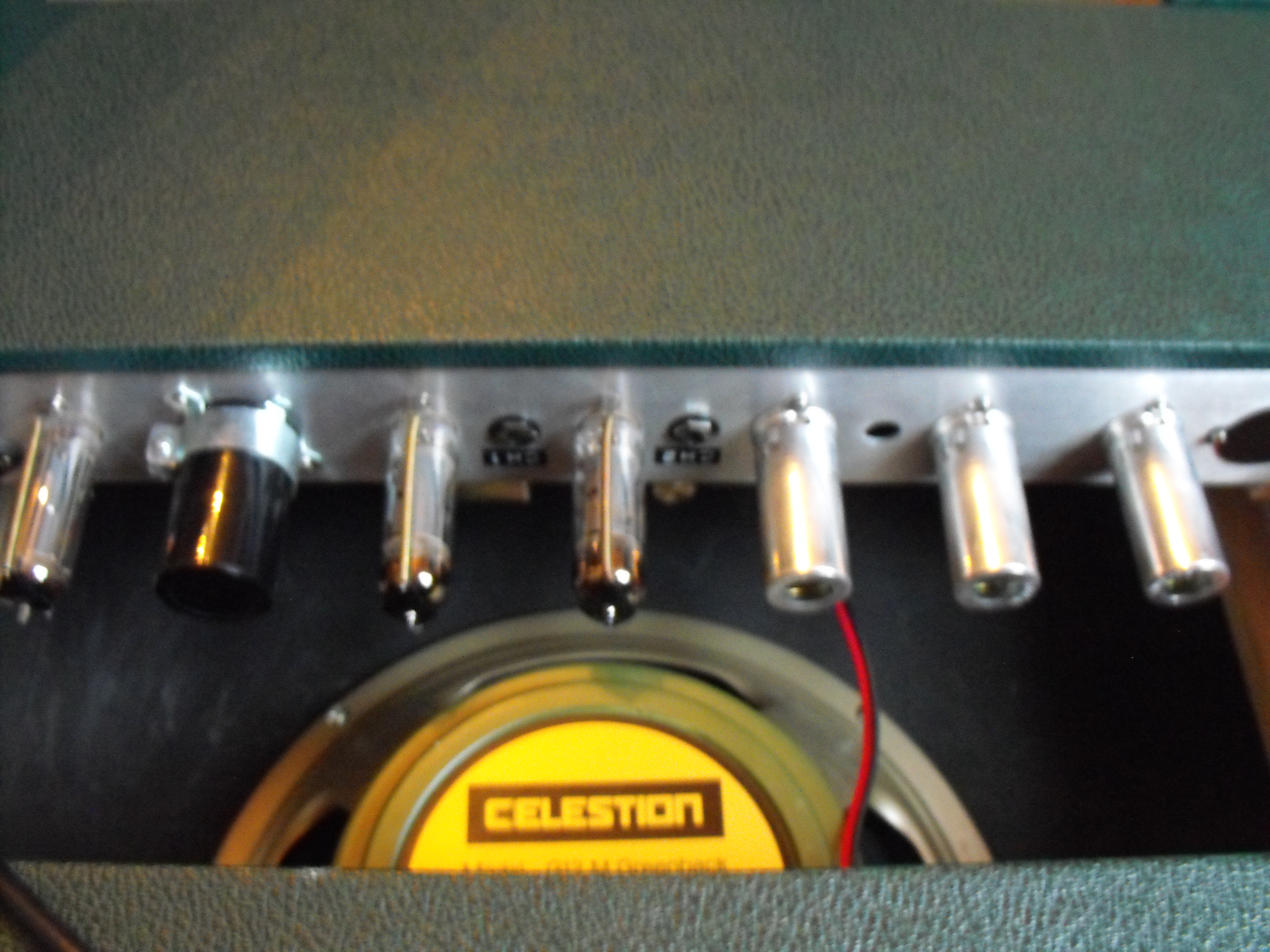

So, pardon my crappy photo skills, but here is a shot of the panel as well as the two channel jacks on the bottom I was wondering about.
Just had a chance to plug in and test with my Lp and my strat, and, at first blush, it sounds great. Can't imagine it providing a clean tone, but very punchy.
First thought that comes to mind is "18 watts my a**!", this thing is LOUD.

That amp looks like it was modded. I think there was a VRM added and the indicator lamp was moved in between the switches. Does the amp's volume change when you turn that "indicator" knob?

The jacks on the back are most likely for effects loop. You need a Y cable, one effects loop per channel.

Yep the indicator knob is definitely an attenuator.
That would be cool if those are loops! I'm not really keen on my reverb in front of the amp.
Thanks again guys for your comments. I'll try and grab a y jack and test those out.

I can say that is not a Trinity Amps 18 watt amp build. Might not be a kit either. We never used that knob style or power switch or put attenuator in that position. Still we can help with it. If those are loop effects, they are stereo jacks one half send, the other receive. You will need to find out which is which. aocture of the inside will help.

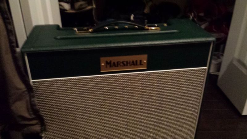

Yet you still try to pass if off as a trinity amp
http://www.kijiji.ca/v-amp-pedal/ottawa/trinity-all-tube-18watt-tmb-marshall-clone-for-sale-or-trade/1062972640?enableSearchNavigationFlag=true
PostPosted: Thu Apr 09, 2015 8:15 pm
Looks like it is being resold as a Trinity amp so I sent an email asking for a change in the advert.
I think this is. a modified Ceri@tone amp. Not one of ours.
