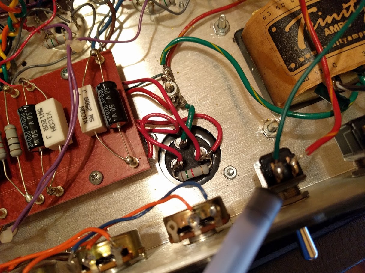

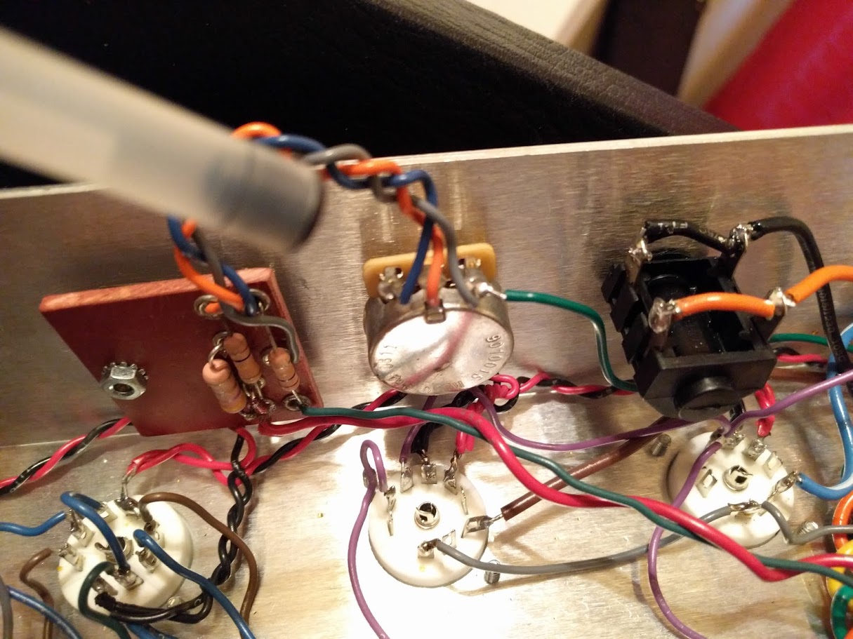

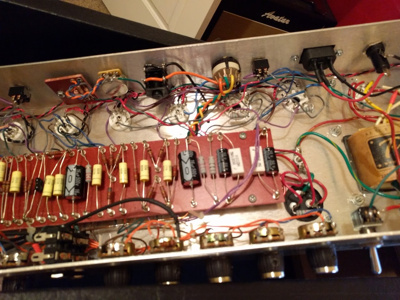

i built my trinity amp in 2008/09 or somewhere around then and haven't really messed around inside it since (and have forgotten pretty much all the things). i've got a plexi voiced v6 with the boost switch and VRM module. i played it for years with the VRM turned down to about 50% and had no issues. this year i moved out to the country and my neighbors aren't 5 feet away from my house, so i have been turning the vrm up to full blast. a few days ago, i was trying to play quietly and noticed and awful random humming/hissing, but it only happens if the vrm is turned down anything below 100%. it sounds similar to a guitar cable that has a ground issue, so with that in mind, i immediately changed guitar cables. the issue persisted. i changed guitars and the issue persisted. i even changed the cable from the amp head to the speaker box and the issue persisted. at this point, i don't know if it's an issue with the vrm specifically or a component inside it (maybe the mosfet?). i'd like to temporarily or maybe even permanently bypass the vrm. i opened up the amp to look and can't find my vrm manual to tell me how exactly it's hooked up. from looking at where the wires go........
green from the vrm pot goes to the standby switch
green from the vrm board goes to chassis ground
red from the vrm board goes to B+ on the filter cap
i don't remember if any resistors had to be changed when i installed this. it seems that just from looking, i should be able to just remove the green from the standby switch and the red from the B+ and then connect the green from the standby switch to the B+.
does this sound accurate?
i've attached 3 pictures. one shows the vrm board and pot on the back of the amp. the pot is in the 2nd output hole. in that pic, the green wire coming off the pot goes all the way around to the standby switch (you can see it in the other pic). the green and red that are "braided" together go toward the B+ with the red connected to the B+ and the green connected to that ground bolt for the chassis.
